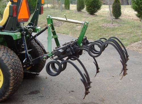

Here's a pic of my soil ripper that a friend with an old JD M gave to me. I designed a conversion to 3 ph that my friend bent and welded the metal for.
Used it on the garden and now plan to remove the chisel plows and mount 2 disc hillers 16" OD to the the 2x2 bar to make raised rows. Plan to use the mounting brackets on the chisel plows plus 4 more to mount the shanks of the disc hillers to the 2x2 bars.
