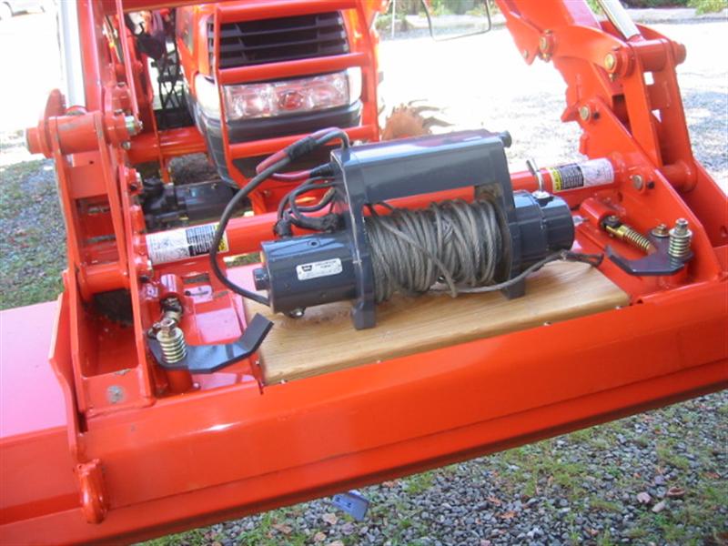

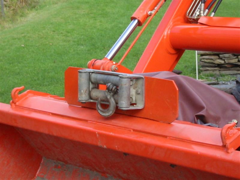

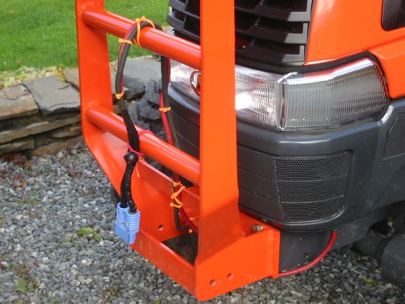

Here they are. I've had the unit in operation a couple of months now and it works just as well as it did for nine years on my previous L3600. I understand that there are now units with an electronic remote control that allows greater distance away from the line of the cable and also is probably easier than hooking up the remote cable.
Ken

Hi Tom!
Glad you like the configuration. Make sure you use high quality battery cable with as many copper strands as are available. This provides maximum flexibility of the cable when moving the loader. Also, plan out the length of the power cables so they can’t drag on the ground and yet provide maximum movement for the loader. Also, be certain to use the “pop apart” cable connectors so they can disconnect at that point should you raise the FEL beyond the length of the power leads. A hydraulic winch can be mounted in the same manner should you prefer hydraulic. It is also important to have that fairlead plate fairly wide and high to deflect rocks away from the winch should they tumble out of the back of the FEL.
When the leads are detached and stored under the cover I’ve used this configuration to work my gravel pit, move snow, and many other FEL uses with no damage to nor interference from the winch assembly.
Have fun!…..Ken :D

Those connectors are ANDERSON.
Purchased mine on EBay, but also found anderson had a web site.
They offer many amperage sizes. Very handy!
I installed a set on my tractor and mated one end of my booster cables for 'quick plug-in' convenience.
Now I don't need to 'pop the hood' to use the cables.
