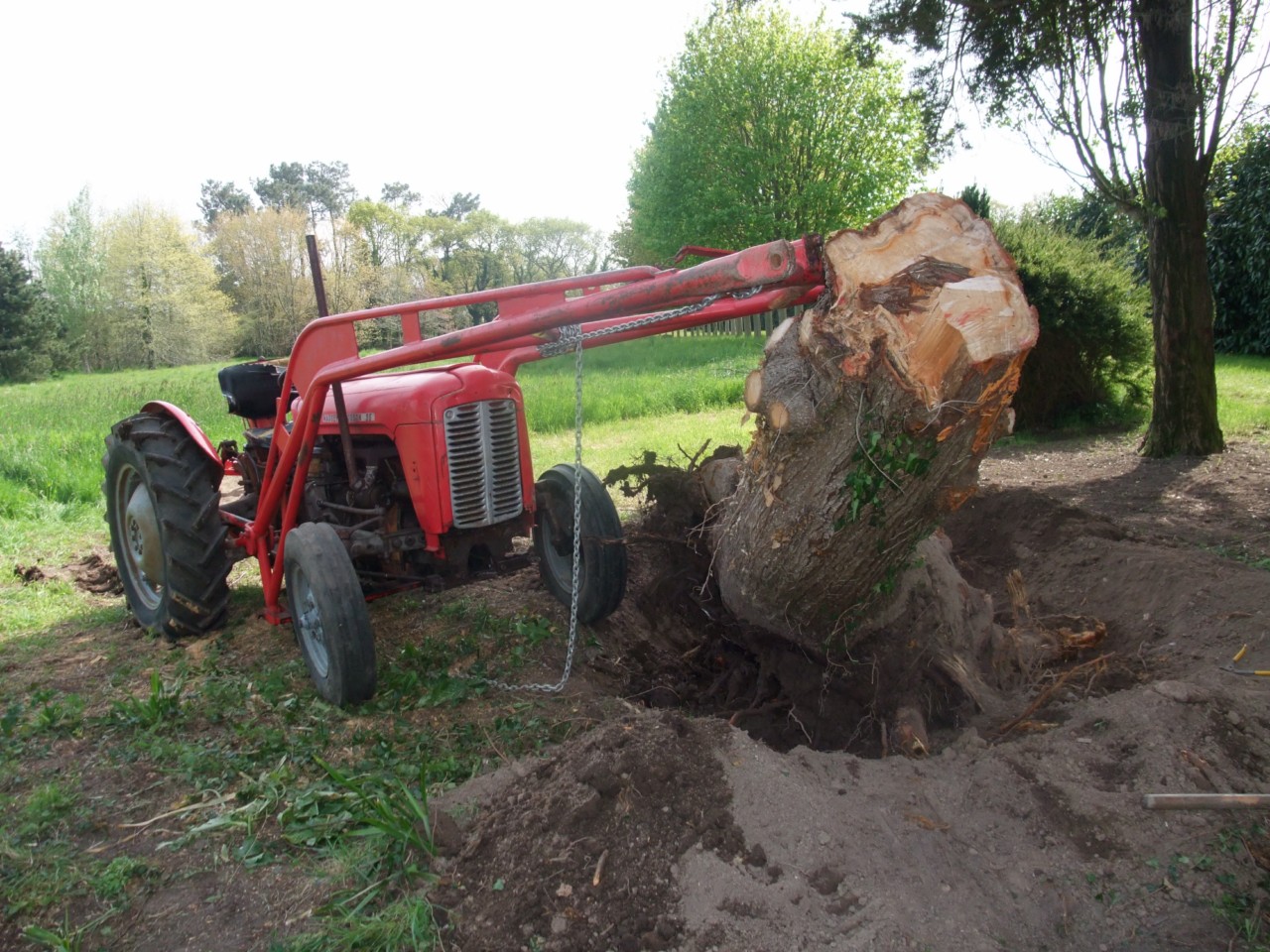

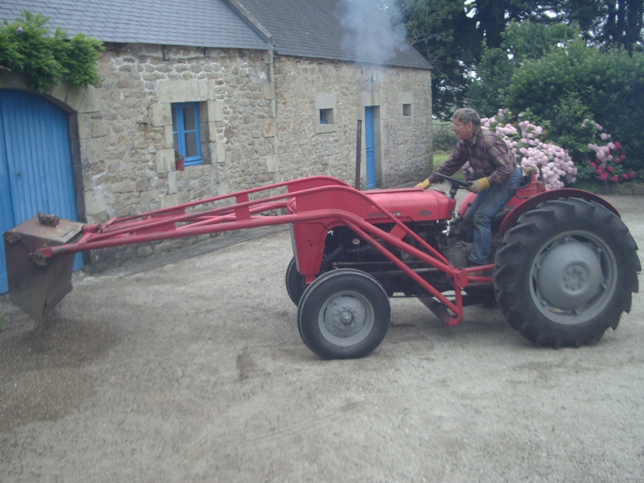

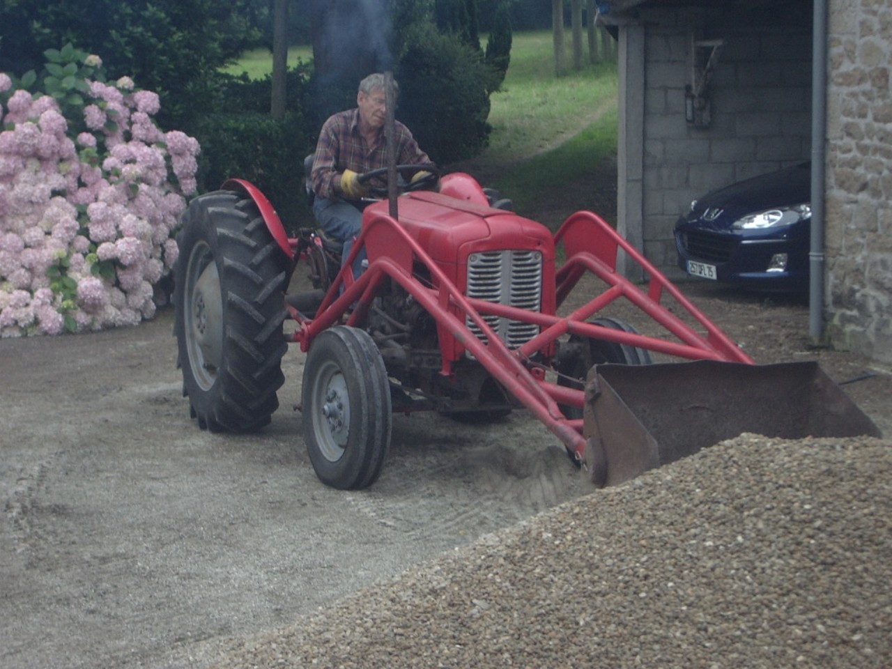

Looking for something like that (bought with the tractor in 1963 under the brand name MF)?

Wow:thumbsup: That's quite a piece of kit, might take me a while to move the manure pile, by the look of that stump you're not afraid to put it to good use!

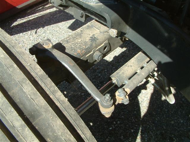

The MF150 has a stronger front end and is better suited for an FEL. I don't think I'd even bother putting an FEL on my 1964 MF135 diesel. The front axles on the 135

The other concern for the 135 is the relatively limited gpm capacity of the internal hydraulics. Folks who add FELs to 135s generally install an external hydraulic pump to the front of the engine crankshaft. You have to be careful if you take this approach. The guy who sold me the 135 (the second owner) said that the original owner busted the crankshaft right in the front main bearing by trying to run a hydraulic pump off the front of the engine.
Just a few considerations to keep in mind before you spend $$$$ trying to make the 135 into something it ain't.
