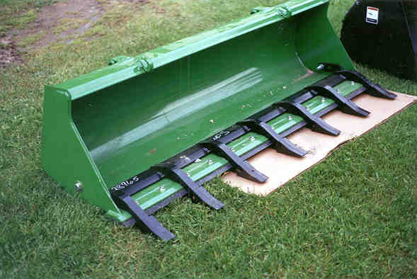

<font color="blue">"...I ended up digging in and making a lot of ruts with the tires. I had a hard time breaking the sod and getting down to soil...does any one know the tricks for using a FEL for this job..." </font>
What you need Lou is a toothbar. See pic attached. Placing one of these on your FEL bucket and then back dragging, you'll then be able to dig well into that mound you're referring to. Talk to Mark at KC Canary. He'll price one out for you.
...Bob
