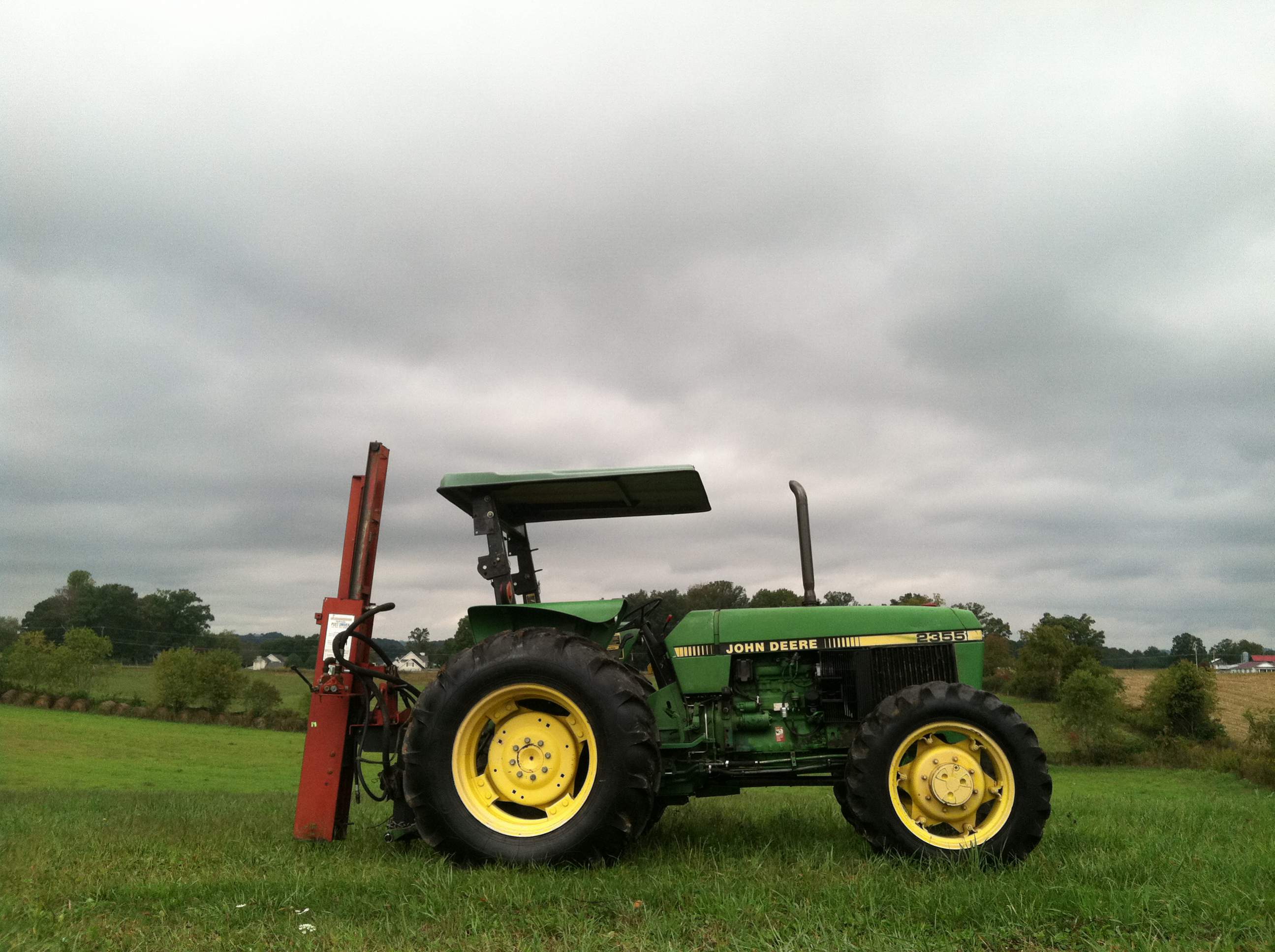

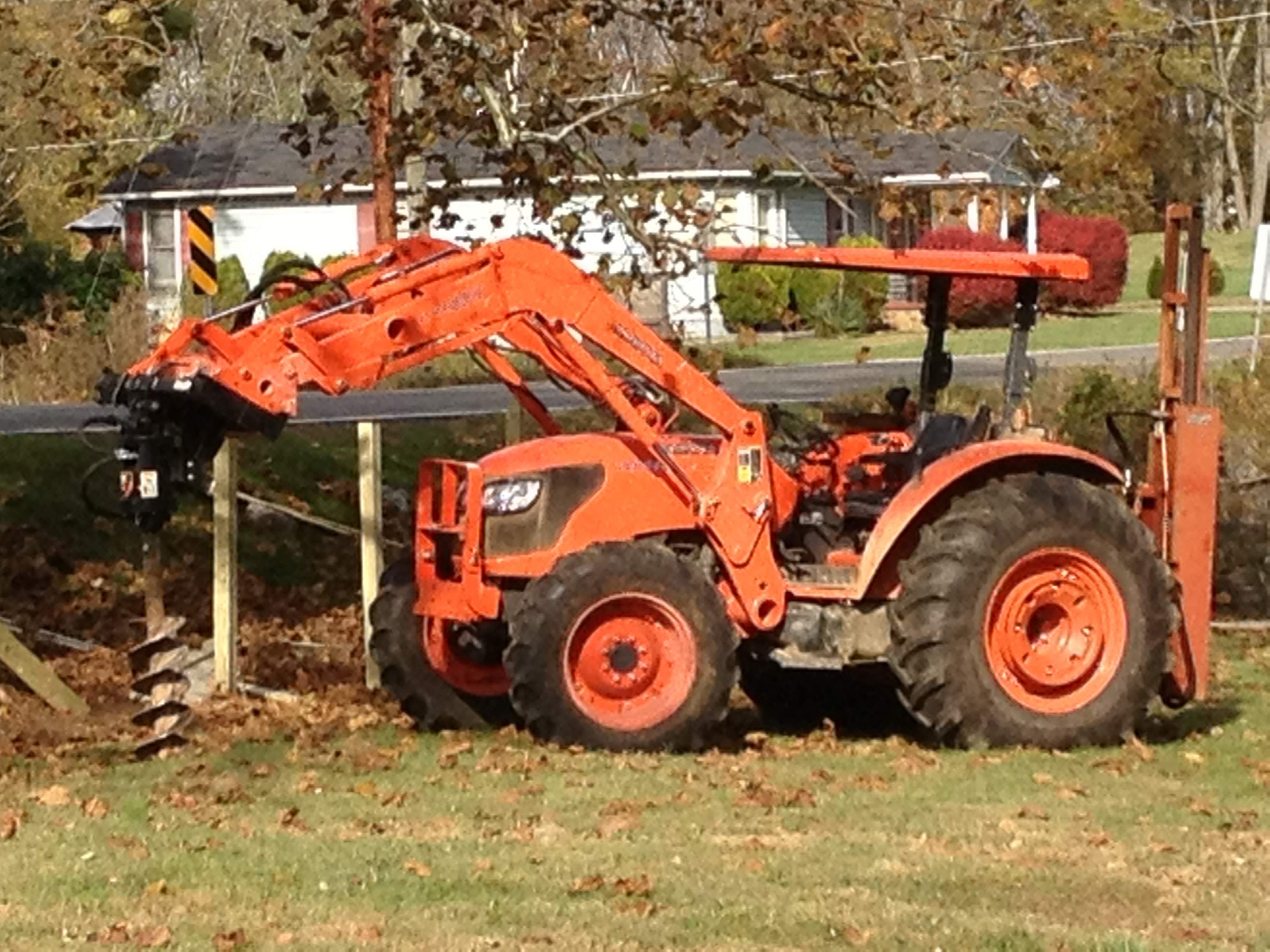

Looking at doing some serious fencing on 50+ acres. Was looking at the various fence post pounders (clay soil) and wondering what people think about their brand, and if the pounder is mounted to the front of the tractor or to the 3 point hitch? I have a Mahindra 5500 and relatively flat land. Fence is for horses, will be driving mixed size wood posts and metal posts. Thanks

Wooden posts may be best to pound with a 3 pt attachment, although my Dad did try filling the bucket with rocks and pounding them down with the bucket (not always straight when he finished).

We use a currently use a 3pt Shaver HD10 with manual hand crank (vs hydraulic) adjustment.
It has driven countless miles of fence posts on everything from flat creek bottoms to steep rocky hillsides. It has no problem sinking 8" gate posts and 4-5" posts can take as few as 5 or 6 good licks to drive to the correct height. As stated it is usually at least a two man job but can be done by yourself, it just takes some practice, patience and about 3x longer.
