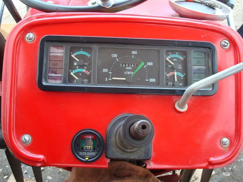

You guys remember when Larry started his thread about the filter minder installation? Then several others did the same thing to their tractors. Well, when Larry first posted about his, he emailed me a link to bid on one for my tractor and I got one for like $8.85 plus shipping ... about $17 bucks total. But at the time I was busy with a bunch of other projects and repairs, so I never got it installed until Larry came up to visit for that week.
That was one (of several) things he did for me ... he installed the whole gizmo into my tractor.

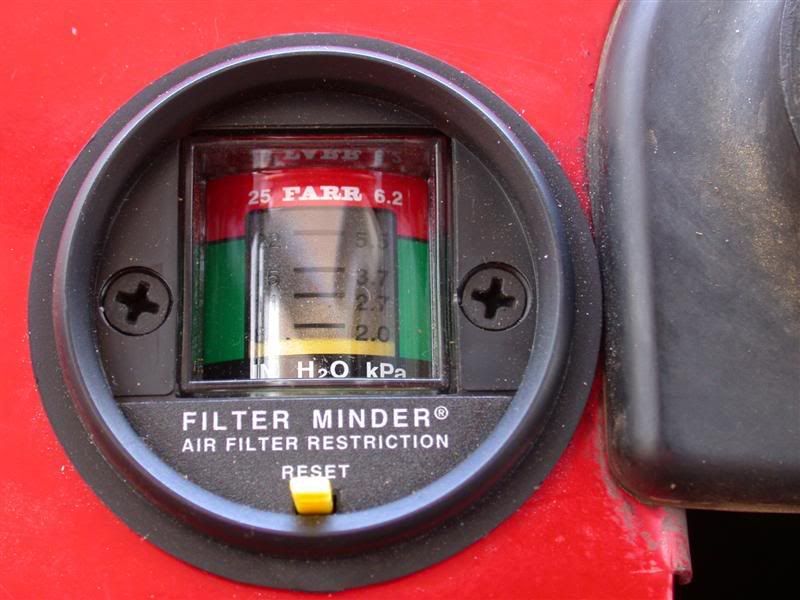

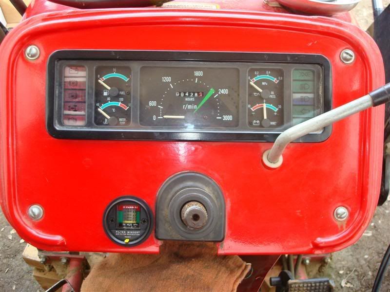

Personally, I've found keeping an eye on the air filter is one of the most important things to help your engine keep running clean and strong and prevent overheating during hot and dusty work. The Filter Minder shows you when your air filter starts to plug up so you can clean or replace it. Mine has a dash mounted indicator that is easy to spot. If your dash has room, I'd recommend looking into one.
Here's a picture of it installed in my Kama 554.
What a sano job he did!

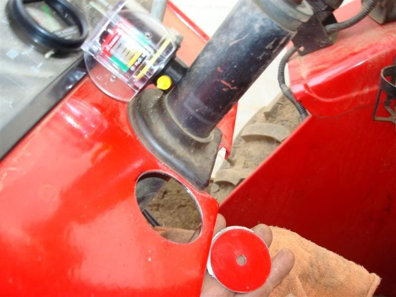

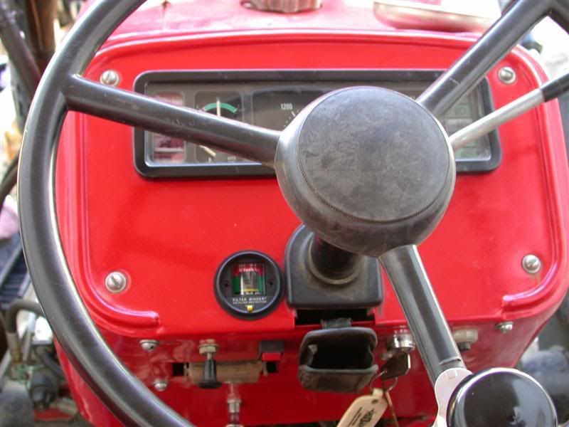

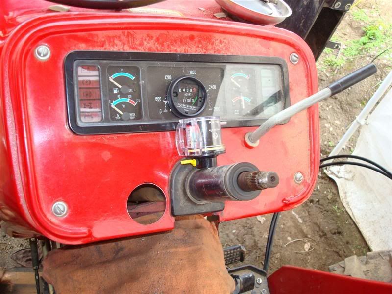

First, we agreed on a location on the dash.
He had to check to be sure it would fit and not run into the fuel tank behind the dash. He removed the steering wheel and cut a 2" diameter hole with a brand new hole saw into the steel dash.
Then he popped the dash mount in and checked it out.
Looks good so far.

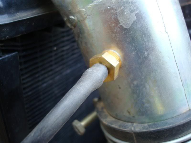

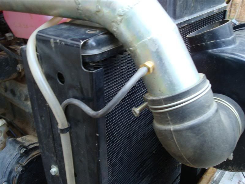

The kit comes complete with vacuum tubing and 1/8npt fitting which you can install anywhere behind the air filter. We chose this location on the Kama 554 because it was easy to get to and tap the metal air intake tube for the fitting. Then you attach the tube to the fitting and also to the back of the dash unit.
I didn't take a video of what happens when you put your hand over the air filter intake, but you could see the yellow indicator shoot up, showing the air flow is clogged up. There is a reset button on on the bottom of it so when you change or clean the filter, it goes back down. If you didn't clean it good enough, it would still show some clogging on the scale.
I thought it was a simple mod to do and definitely worthwhile.
Even more simple since Larry did it for me. What a guy...thanks again my friend!

......I thought it was a simple mod..........since Larry did it for me..... HaHaHa yea those are the best kind. I even took the pictures. Noticed I cleaned the dash off too?
What Rob didn't mention was removing the steering wheel. We worked together doing that. Since there was no gear puller at camp. I stood on the floor boards pulling the wheel while Rob hammered the splined shaft with a punch. I knew what was going to happen when it let loose, so I prepared for the eventuality I was going to land flat on my butt. After a few whacks it popped off and I landed right in the seat. Good thing Rob installed that spring seat to cushion my landing. Oh and there are not to many precision machinists out there that would trust anyone to use a hole saw and cut out a 2" hole in the dash of their tractor. Thanks for trusting me to do that Rob. Lucky me it came out looking good, otherwise it would have been my turn to empty the port-a-potty. :p
Great mod Rob ;) this was super simple and a fun time for both of us.
