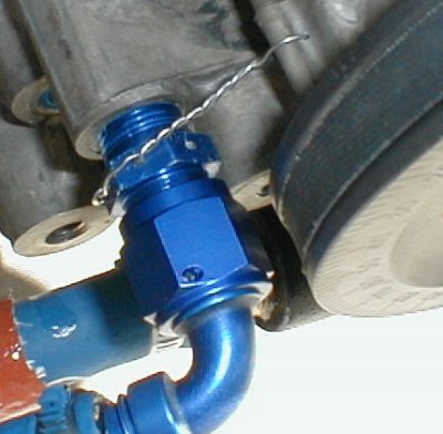

I can't picture any place on a JIC fitting that you could drill with out causing either screwed up threads or a hydraulic leak - got any pix of this?... Steve
It would look very much like this, although this is an AN fitting. Note the safety wire has not been installed on the Female fitting yet, but you can see the hole for the wire.
