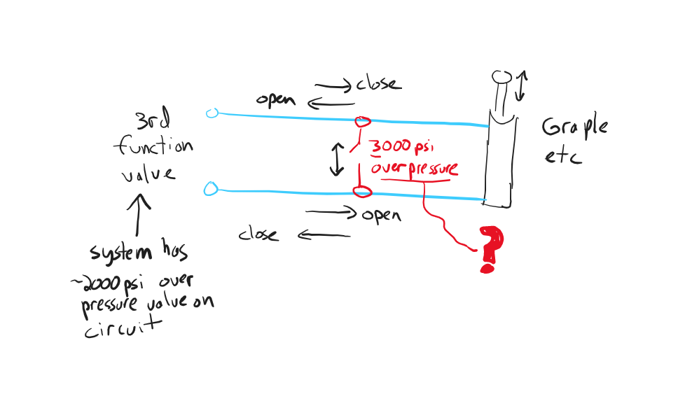

I have two problems where I've seen advice on TBN to solve with a "check valve":
  1. a cylinder "sags" - eg, my snowblower chute deflector. Set it at the angle i need; a minute later the deflector has drooped down.
  2. a grapple can experience very high pressures when, say, it's closed on a long tree, then the FEL is lifted. Or just bouncing along driving with a long/leveraged tree. Loads increase in the grapple cylinder substantially, with no relief valve in the (closed) circuit)
In #1, I do want to "check" "backward" flow ... unless I don't (I want it held from fluid moving in the direction it sags down - except when i open the valve that direction. I am not understanding how a check valve wouldn't prevent contracting the cylinder at all.
In #2, over on Alternative 3rd function? "check valves" are discussed to solve this problem. A user clarifies a hydraulic accumulator could be used here. But those do not seem to be in common use, and not what folks referencing "check valves" refer to. It seem like a dedicated, higher-pressure OP valve could be used(?)

I think for #1 you want a pilot operated check valve. The valve stays closed unless there is pressure from the pump (through the rear remote valve) going to that side of the cylinder.
And for #2 a double relief valve. Maybe a single since the load you want to relieve is all in one direction (opening the grapple).

Thanks! these make sense conceptually. Amazing how much variety of hydraulic (or air) control systems there are. Almost like whole factories were run before computers... :)
For #2, relief of grapple over pressure.
on #1 - keep chute deflector up.

You don't need a 30gpm relief valve. Your tractor claims 11.7 gpm but I think that is adding the main and steering pumps together, which is done for marketing but is not applicable to the real world. The steering pump is around 4-5 gpm so figure 7.5 for the main pump. You can probably find the exact numbers somewhere, I did not look hard.
A smaller valve would be appropriate, if any are made.
I'm not convinced that a relief valve is needed here. You should try not to pick up heavy badly balanced loads in the grapple anyhow so you don't bend the loader frame. The same is true with pulling with the lids.

great video, thanks. I'm actually surprised it ONLY got up to 5-6000psi. I would have expected more given the leverage.
I didn't see any smaller relieve valves, but will keep looking. Any reason to think the large valve would be less effective here, or just 'overkill'?
Since I'm installing the 3rd function, I might as well add one since it seems relatively cheap piece of mind if i end up prying on something. <*cough*> I'm sure it will never be dusk after a long day just trying to get ONE more thing done NOW <*cough*>

#9
I had a realization that concerns me about this app:
The cushion/double relief valve simply "short circuits" both sides of the cylinder, allowing an overload condition to resolve by the rod moving with the load. they are marketed for exactly this purpose afaict.
HOWEVER: isnt the area of the two sides of the plunger different? smaller on rod end due to rod's cross section? this would mean that the volume-per-inch-travel differs, and it does no good to only short circuit.
Eg, if i simply pipe a double-acting cylinder to itself - i cant compress it, the bottom is expelling more fluid per thou travel tham the top is making space to accept?
