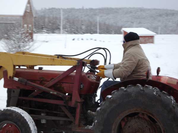

One more question - I uploaded a pic of my tractor and as you can see it has been adapted with a front end loader that is going to reduce my ability to get at the water pump. My brother said it might just be a "busted knuckles" job to work in this tight space. Are there parts of the front grill/radiator or side panels that you would remove, or would you just leave everything in place and start bustin' knuckles to remove the fan and water pump? I don't have the tractor in front of me at the moment and am planning to travel the farm in Mabou, Cape Breton this weekend to fix this leak.

Don't know about the perkins three cylinder but I changed the pump on my Z134 4 cyl without removing the rad, took the fan off and was careful not to flatten any fins. Longest part of the job was removal of the pulley and housing, it's a press fit onto the shaft on mine.
   / Fixing MF 135 Coolant Leak #7
Changing the water pump isn't difficult, and doesn't require the removal of the radiator or any panels, although the fan bolts are a bit difficult to reach. Just be careful not to bend the radiator fins while removing the fan bolts because they are in close proximity to each other.
Having a loader does create some additional challenges, but nothing that cannot be overcome.
