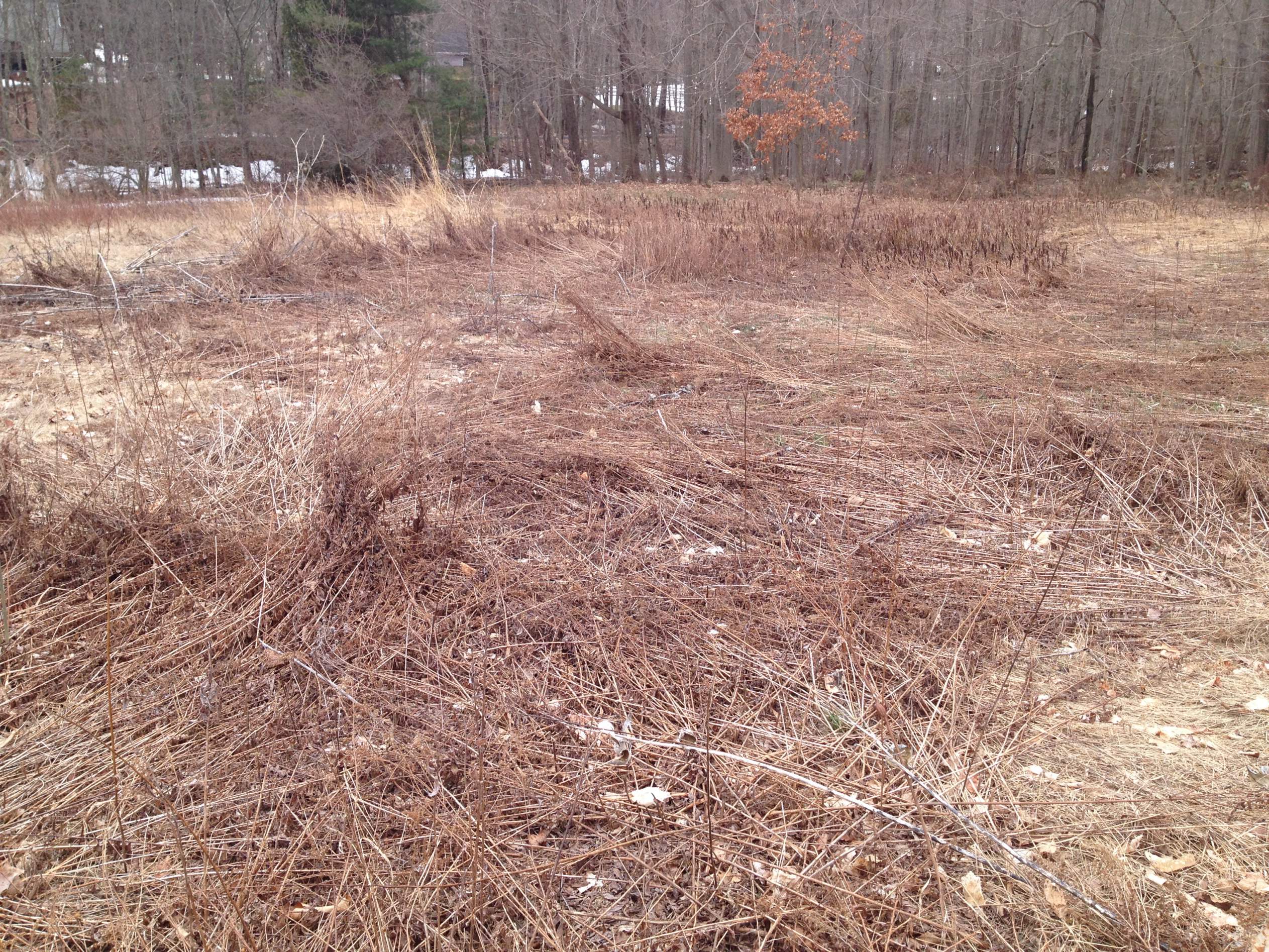

So I need to clear a one acre field before plowing it this spring and planting it in buckwheat/clover in order to prep it for a market garden next year. I want to buy a flail mower anyway, will it get through fairly sizable weed residue? I've tried to insert a picture of the field, I hope it worked. Thanks for any advice!

A flail will eat that up.

Yeah, a flail mower can take that down below ground level a bit if you wanted to....no problem.

No problem for a flail mower. Just be sure you walk that field and pick up any old fence wire. You don't want that wrapped around your mower shaft.

X4 - should cut it without any problems

A flail mower will have no problems with that field but walking through to pick up any debris
is a good idea anyway as you do not want a flat tire.
Using a strong magnet from northern tool to pick up any stray metal will simplify matters for
you and reduce any potential damage to the flail mower as they absolutely hate garden hose
and barbed wire snakes and it takes a long time to remove them after you remove the drive belts.

One question though, can you afford a small two wheel tractor and a couple of implements?
The reason I ask you is this is that you could buy a two wheel tractor, flail mower attachment and a rotary plow to make raised beds and in the process till deeply and also kick out any stones or know where the large ones are as the rotary plow will ride over them then you can dig them out with a shovel or prybar.
A very tall raised bed will drain quickly and you will have a huge jump on weeds as the leaf canopy will choke out any sunlight reaching the ground and it will kill off the weeds.
I grew sunflowers and sweet corn on raised beds(referred to as ridge tillage) and they just grew and grew and grew and choked out the weeds and after few weeks I could not pass through the beds with the tiller because the corn and sunflowers were so tall and thick with six in planting distance between seeds.using 24 inch row spacing.
