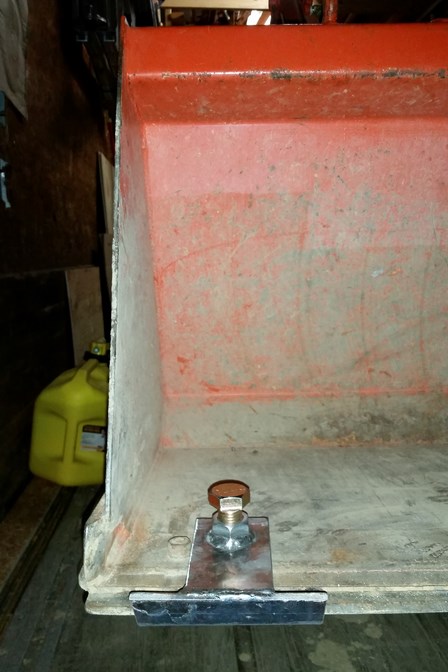

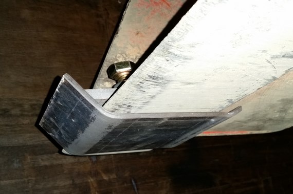

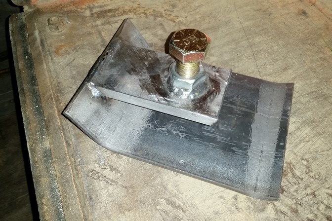

I picked up my first tractor a few months ago and intend to use it to move snow. My first major project with the tractor was to dig a monolithic slab foundation. The "float mode" was great for back grading once all the cement work was done. However I accidentally moved forward with the bucket down in float mode and it quickly dug right in. This made me think about plowing in my gravel area.
My driveway is paved and ~130' in length. I have an extra parking area that is covered with reprocessed asphalt that is fairly well packed. I want to use the "float" feature so the bucket would just follow the contour of the driveway and gravel area. Knowing I had an issue in the yard moving forward in float mode, I decide to make a pair of "SKIS" to prevent the bucket from digging in. I think the concept will work well enough. I'm going to try "dry running" it this weekend and see how it works out.
Here's what I came up with for a design...
   / Float position while plowing #7
IMHO for snow plowing, the float should be in the blade not the FEL arms. Trying to use FEL float, even with skid shoes will result in digging up the drive, pushing the front end around and difficulty in maintaining traction and/or direction. The more freeze thaw cycles you have, the worse this is going to be.
I have had great luck with the HLA snow plows with lateral float. I just set the blade so the shoes just touch and start plowing. Works great on my 1/4 mile pavement and gravel drive. This year just putting it on the tractor scared the snow away!
