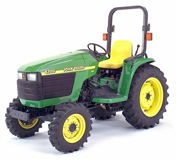

I think Deere does (or at least used to) make a short folding ROPS. Here is a picture of a 4300 with a short folding ROPS that I found.
