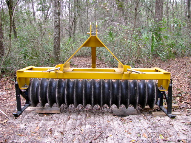

The two key implements for food plots are a Disc Harrow and a Cultipacker.
You need quite a bit of weight on each Disc Harrow pan in order to cut in food plots. Research 16/20" and 20/20" 3-Pt. mounted Disc Harrows, which will give about 55 pounds bearing on each disc yet be easy for your 37-hp / 2,600 pound Kubota L3800 to pull. You want a Disc Harrow slightly narrower than your rear tire width, so when you go through tree and boulder gaps you Disc Harrow will follow true and not "hang up" in the gap. This is especially important on sloped land. Normally, food plots are only cut once per year, so buy enough Disc Harrow weight per pan.
(20" Harrows need 1-1/8" axles, which are fairly standard.)
I recommend notched pans for food plots. Smooth pans roll over vegetation which will be cut by notched pans. Almost all 20" Disc Harrows are sold with notched pans for that reason.

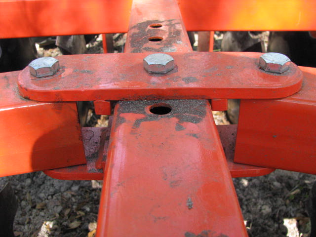

The layout of 3-Pt mounted Disc Harrows is pretty much the same: width, pan diameter, notched or smooth, pan spacing (7" or 9") and "clamp plate" adjustment of the gang angles. (First two pictures show clamp plates.) I have a Howse 16/18" with clamp plate adjustment; the build quality is good. The only extra cost feature to consider is lever or screw quick-adjustment of gang angles. (Everything Attachments, Leinbach, Brown, Monroe Tufline ~ some)
(In Florida I plant distinct Fall/Winter and Spring/Summer food plots. My plots are cut in March and again in September so my 16/18" Howse suffices.)

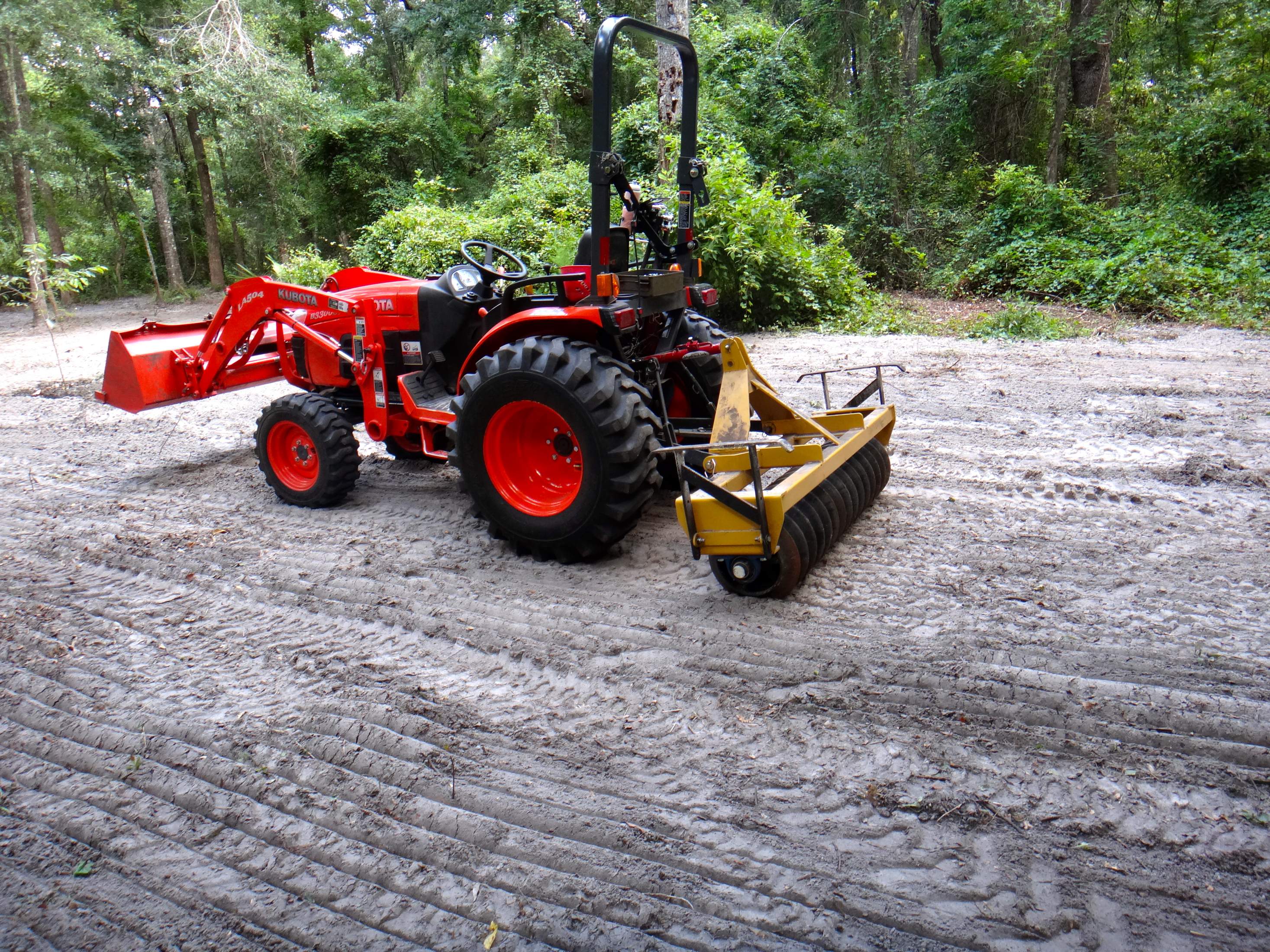

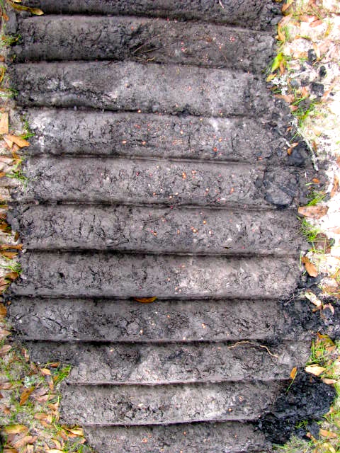

I seed over harrowed ground. Food plot seeds are strong germinators and smoothing, at least in rock free north Florida, is a waste of time and fuel. After sowing I roll in the seed with a Cultipacker, which presses in the seed and creates ridges, which should be oriented across slopes to prevent/reduce erosion on slopes. Cultipacking is more important than smoothing after harrowing.
Voila!
PS: A 3-Pt. mounted Cultipacker makes excellent rear ballast; very heavy yet compact.

While I agree with the comments, a cultipacker is pretty expensive. for my food plots, I took a section of chain link fence and loaded a few rocks on it. After broadcasting seed by hand, I just run the tractor/drag harrow over it. I've had excellent germination and coverage a lot cheaper. So, if your food plots are small, you might want to try this first. If your plots are in the acres, than this might be manually exhausting! Good luck.
