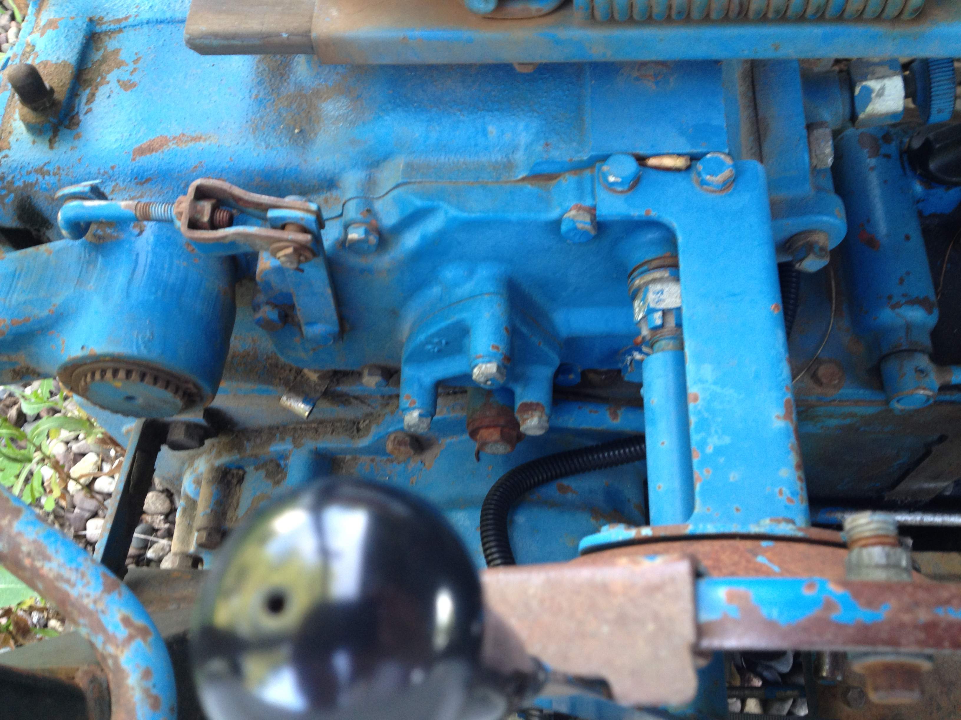

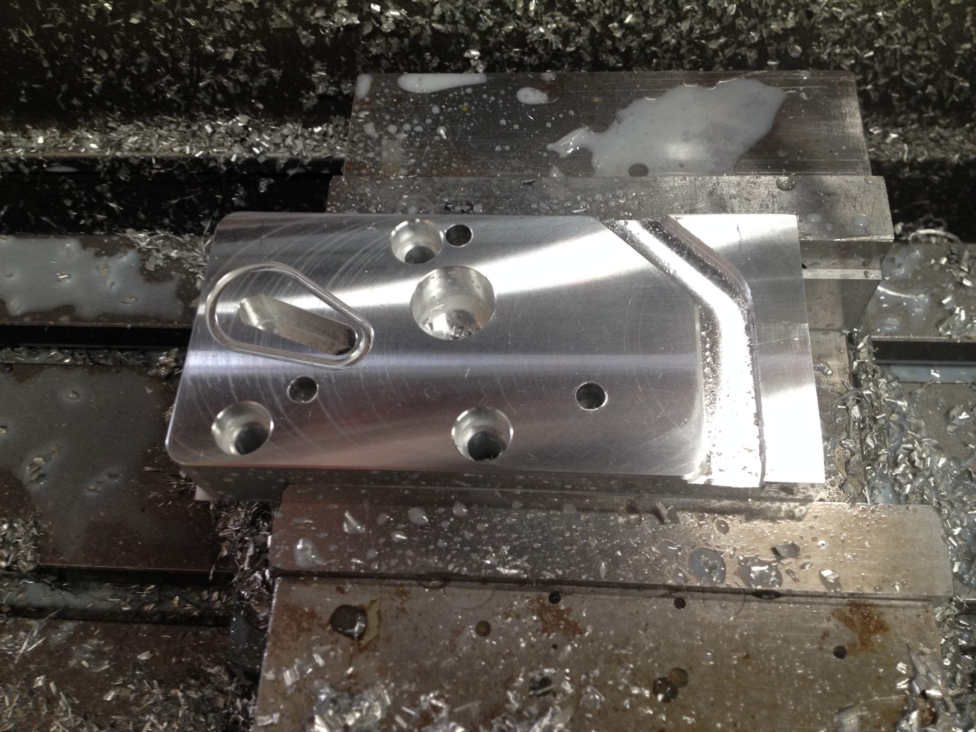

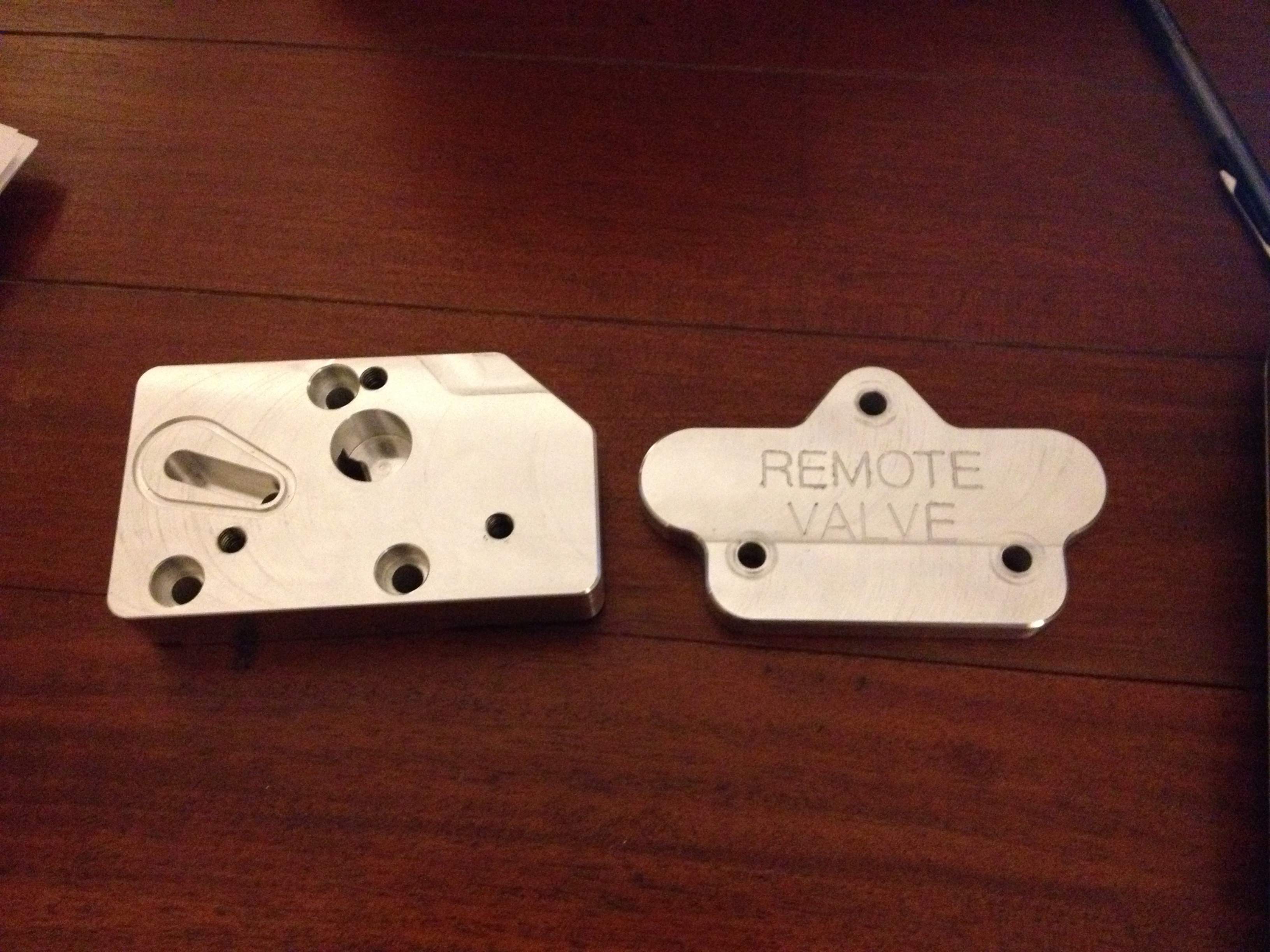

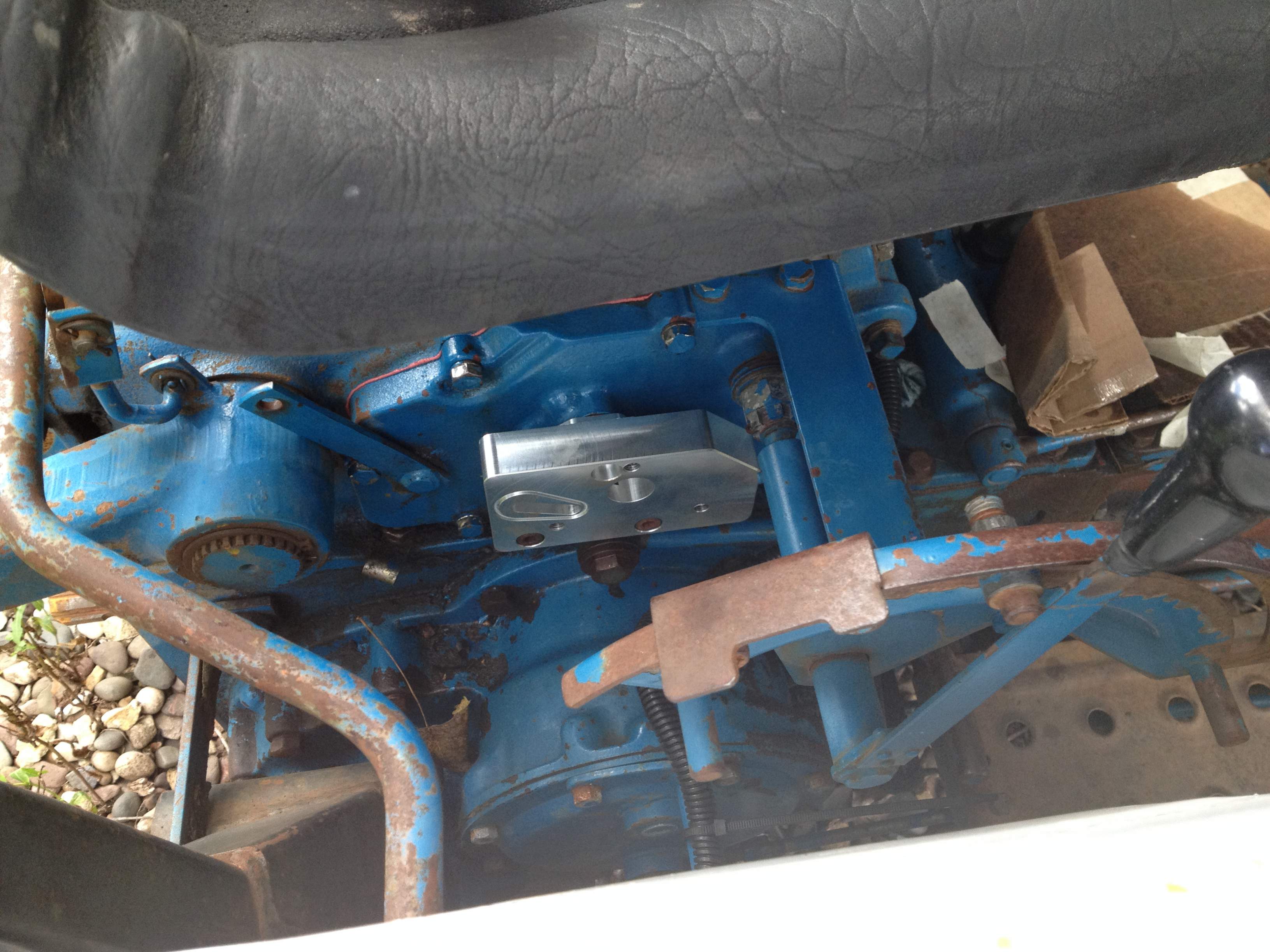

Here's a quick look at the rear valve I added to my 1710. New Holland parts shows that the remote kit for this model is no longer available so I had to come up with a custom solution. I see a few places sell an adapter plate to tap into the three point lift hydraulics, but it's only an in/out port adapter. I really wanted a mounted valve to eliminate some hoses. The first picture on the left shows the stock port cover and the second shows the new valve setup. The valve setup is made up of two adapters and a Prince SVW sectional valve. I recently purchased a CNC machining center, so I was able to machine the adapters myself.

Nice job on the custom covers and adapters!

That's a pretty clean setup. I could see sething like that being a big seller for some of these older tractors.

Better than factory original! Nice job.

I'll look for more pictures. I can only speak to what's on my tractor...It has a loader so the relief valve is on the loader connection block down by the brake pedal. I think some 1710s had the relief on the side cover where my machined valve setup goes. This setup wouldn't work for those without modifications. There are three ports on the cover. One is the pressure port from the pump, one is a drain to reservoir (unused in the stock factory configuration), and the third is the input to the 3pt lift valve (inside the cover). The non-relief valve cap mounts to the cover and sends oil from the input to the 3 pt lift valve.
