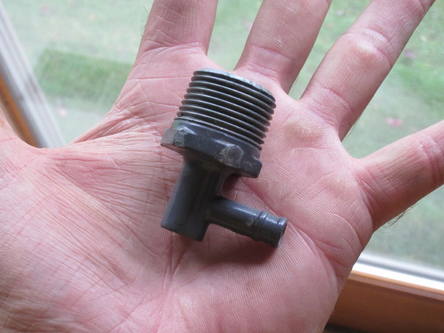

Anyone got advice on how to go about fixing this leak at the engine block fitting? Slow antifreeze leaking from here, several drips after shut down. Will empty reservoir after a couple months. Finally got around to cleaning this area and finding the leak source. Thanks in advance for any help with this.

That was a common leak for NH Boomer tractors too. The fitting is made from zinc so it will corrode where it touches the iron. I took a 1-1/16" 6-point impact socket and cut a slot up the side to miss the nipple. Be sure to cut the slot on the hex point and not the flat.

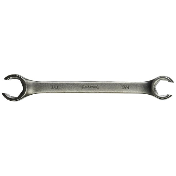

You also may be able to use a flare nut wrench

I replaced my coolant bib with brass fittings so I wouldn't have problems down the road.
