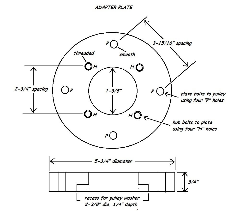

Thanks for that CF. I dropped the parts and drawing off at the machine shop yesterday and talked to him about the price for steel. The $42 he quoted me was for higher end steel, I told him it can be made from cast iron since that's what the hub & pulley are made of. He's going to look for some cheaper iron and maybe find a scrap piece big enough so I'll get a break on the material cost.

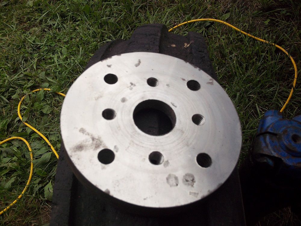

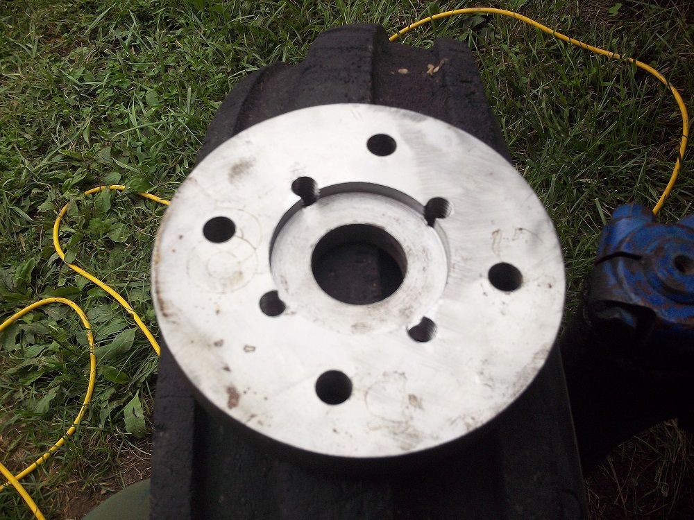

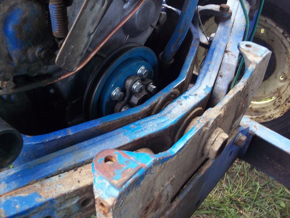

Okay it's been awhile but I finally got the adapter hub installed on the tractor. I picked up the part from the machine shop 2 weeks ago and it was sitting in my shop until now. They were able to make the part by referring to my crude drawing:
I also left them with the pulley, bolt & hub to match it all up. Apparently my measurements were accurate, to my suprise.
The total came to $117 + change, the material (cast iron) was $17 plus two hours of labor at $50 per hour.
Here's the finished part, back side:
Front side:

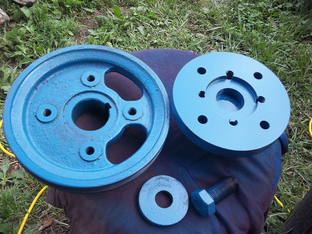

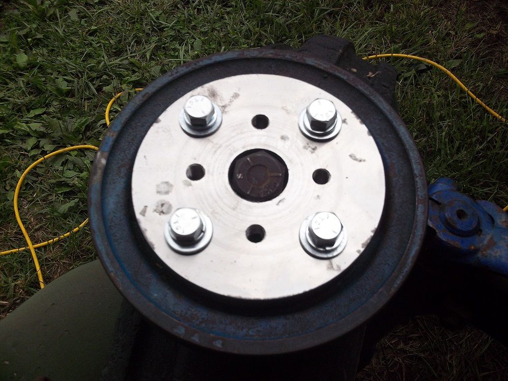

Test fitted on the pulley:

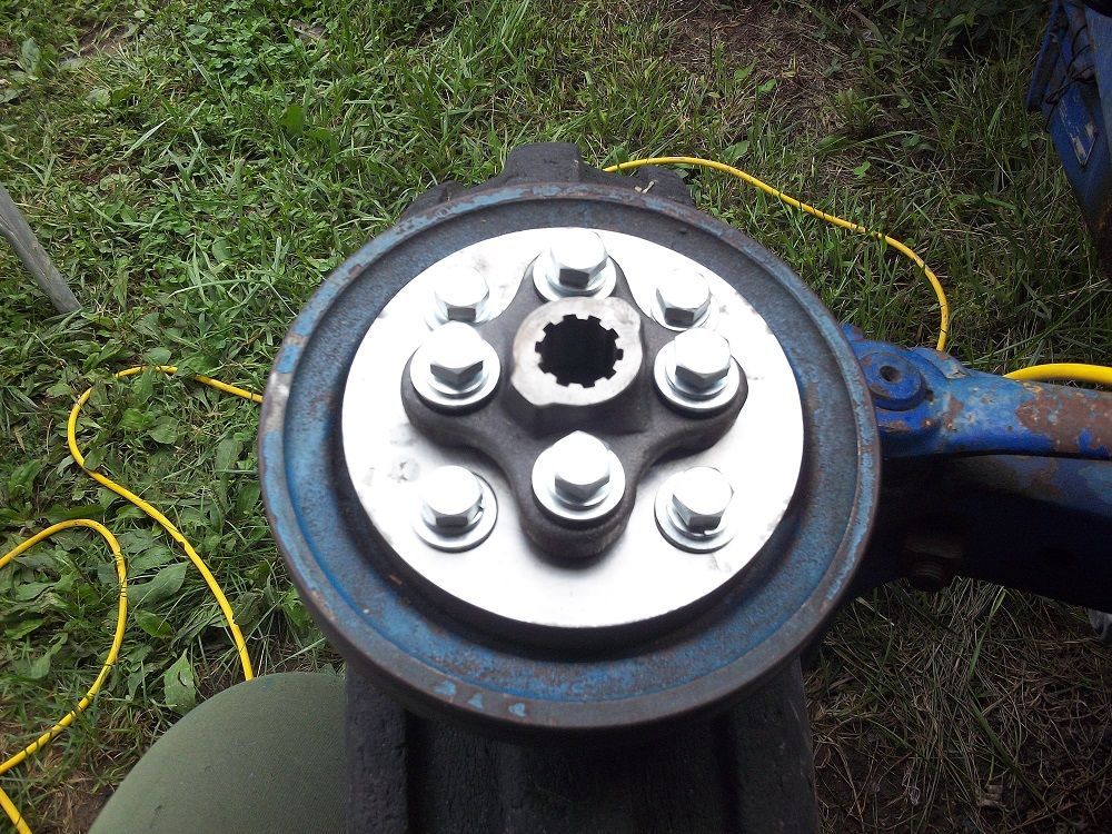

And with the hub on... perfect fit:
A little Ford Blue paint:

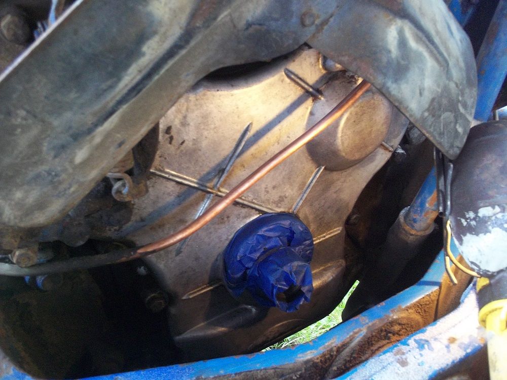

Cleaned up the timing cover:
Successful installation:
You can see the openings in the frame where the shaft goes through:
I don't have pics yet but I test-fit the pump and it lines up just right. There is 6" to 6-1/2" of shaft from the frame to the pump face. I will have to cut and modify the bracket I have from the pre '64 tractor to install the pump.
So far, so good!

This adapter enables the front-mounted hydraulic pump on a 19-105 (703) loader (which is made for the '64 & earlier 4000/800 series) to be installed on a '65+ 2000, 3000, or 4000 tractor.
Used 725/730 loaders (for '65+ tractors) are in the $2000 to $3000 range. I bought my 703 loader for $750 and the adapter cost $117, so I've saved a lot of money!
If anyone else wants to use the drawing I posted feel free. Most machine shops should be able to make the part by referring to the drawing, but I'd recommend giving them the pulley, pulley bolt & washer, and pump hub so they can be sure.
