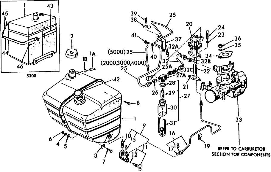

the OP's problem almost is sounding like a fuel obstruction at the fuel pump or similar as it sounds like it is starving and only slowly filling the bowl.. then starting and running it i=out fast.

then it shouldn't run for 45 min the start messing up i would believe the bowl should empty alot faster than that and when it started running it should pull enough vacume to pull full through the pump

the only fuel problem that i know will cause it to act like this is the valve in the bottom of the tank either the filter it trying to clog up are the screen it pluged and when running it sucks debree into the valve opening

Thanks for the ideas, from what i can see this tractor is gravity fed gas. no fuel pump, It has a holley carb on it. I plan on removing the intank filter this weekend. A friend suggested the float may not be set correctly, carb was taken apart last summer. but i did plow snow with no problems, although i was not running at high rpm's. Sooner or later we will solve this, thanks again, Joe
