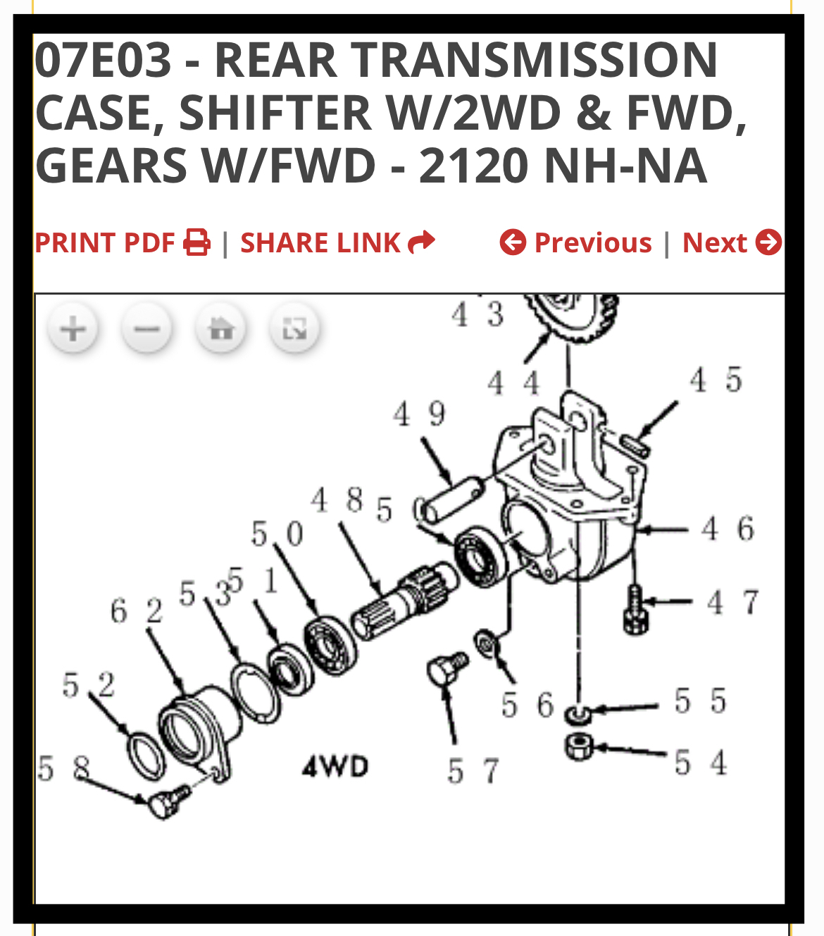

I had a look at the parts diagram and I’d guess that I’m going to find an issue in that small gear case that hangs off the lower side of the transmission case where the front driveshaft attaches. Probably there is a stripped gear or spline or broken woodruff key. The chatter noise and vibration seemed to come from there.

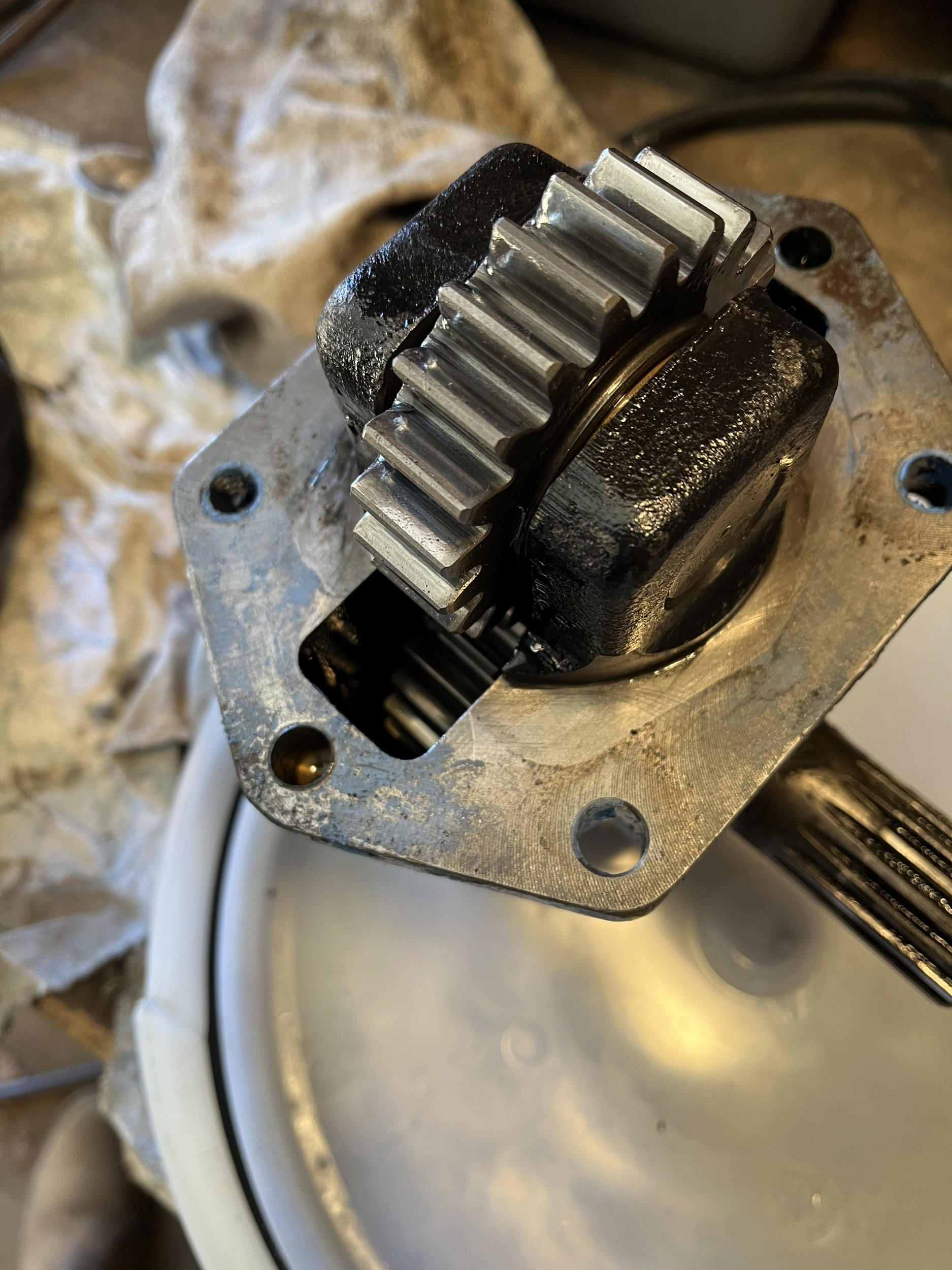

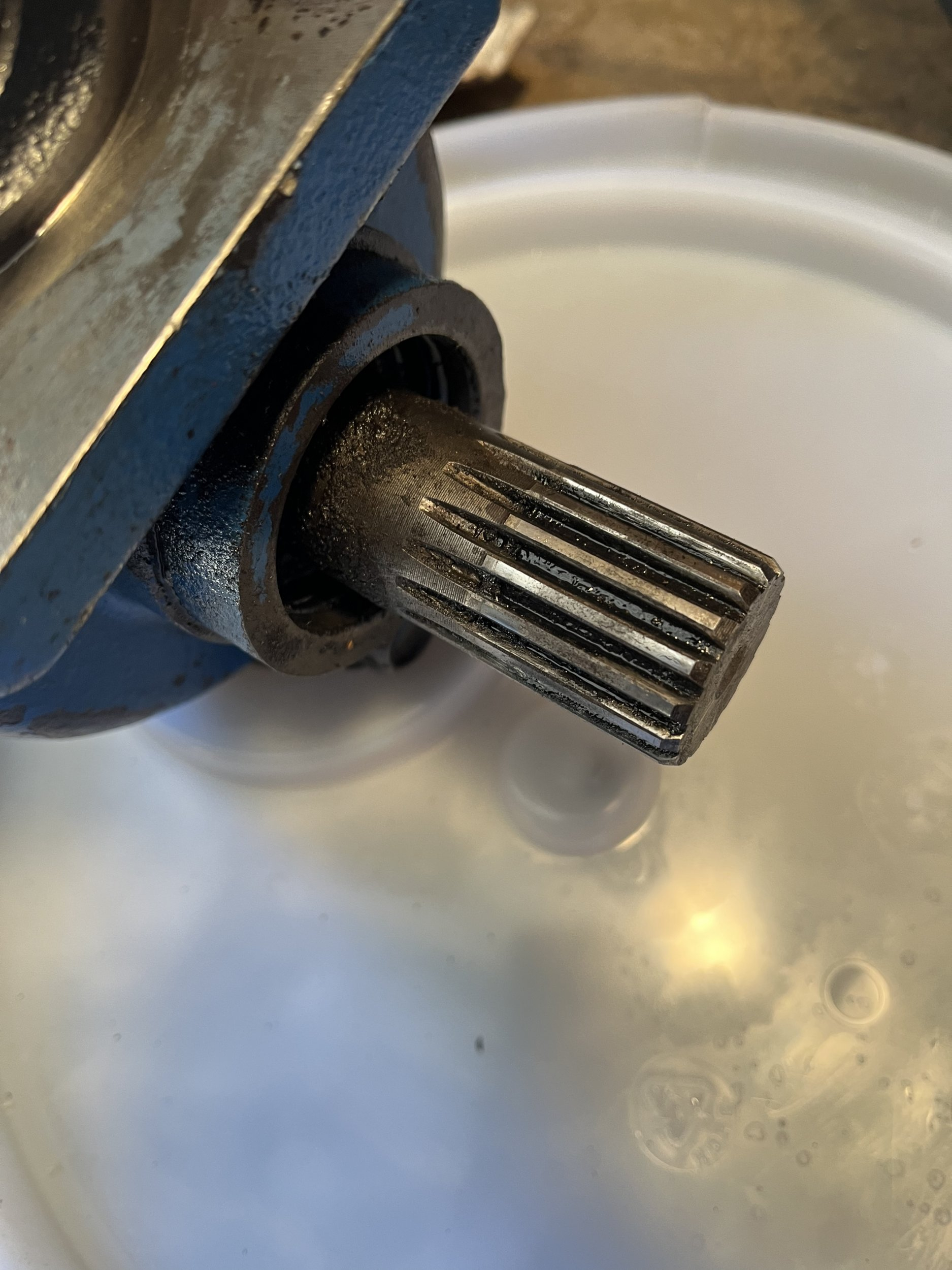

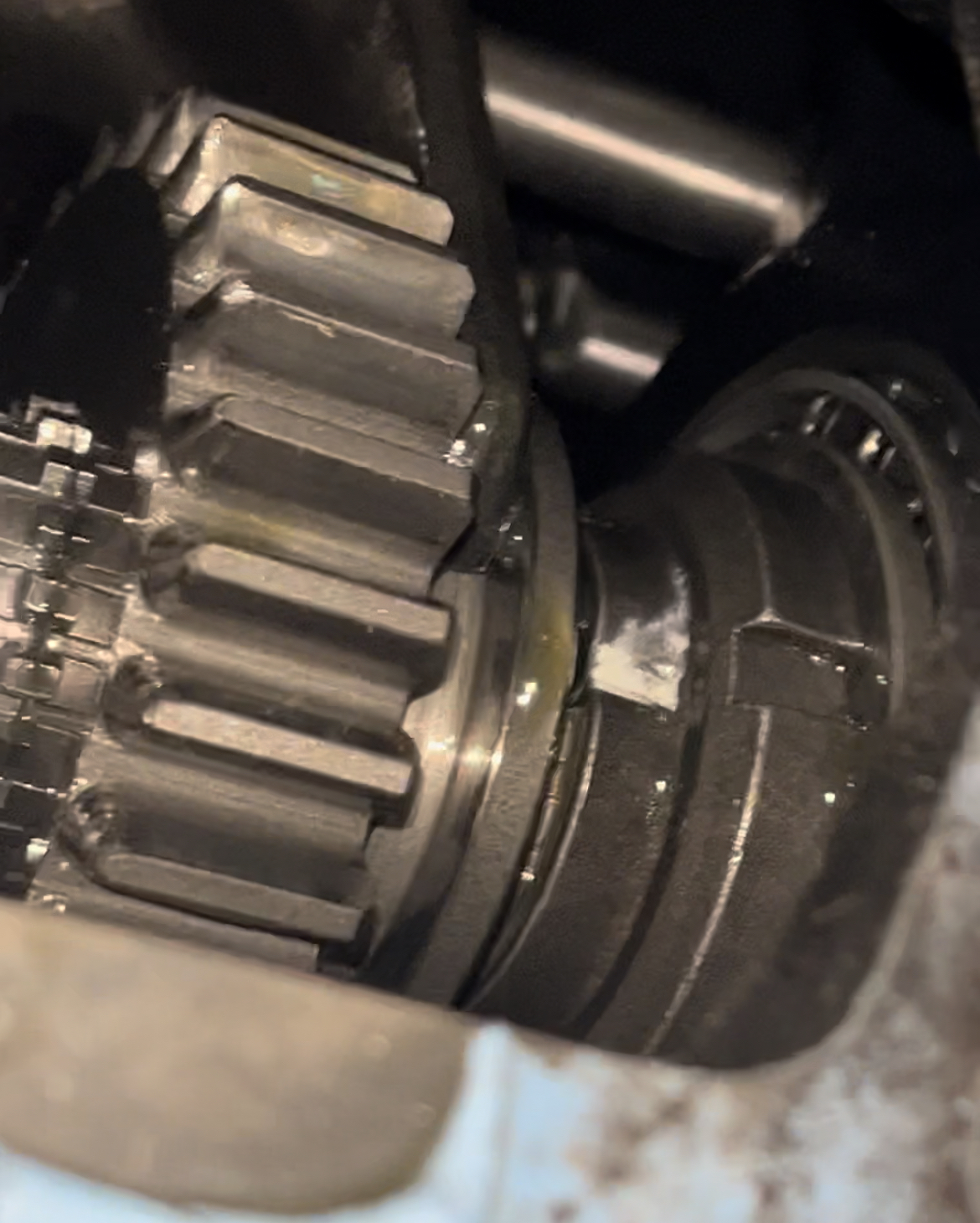

Today, we finally got around to opening up the fwd lower gearbox on the 2120. I drained the oil and removed the gearbox and had a close look at the gears and the spline shaft that sticks out of the gearbox and couples with the driveshaft. All the gears and splines look good without any wear, breaks or chips and no steel chips were found. The gears are tight and no play is evident so it seem the problem lies elsewhere in the fwd drivetrain.
Unfortunately, before starting the disassembly, we didn’t engage the 4wd and listen closely to identify from where the chatter noise is coming from.
Should we bolt it back together and listen for the chatter or should we remove the driveshaft and check the splines on the front axle end ? I imagine the chattering could be coming from anywhere along the fwd drivetrain.
Thanks !

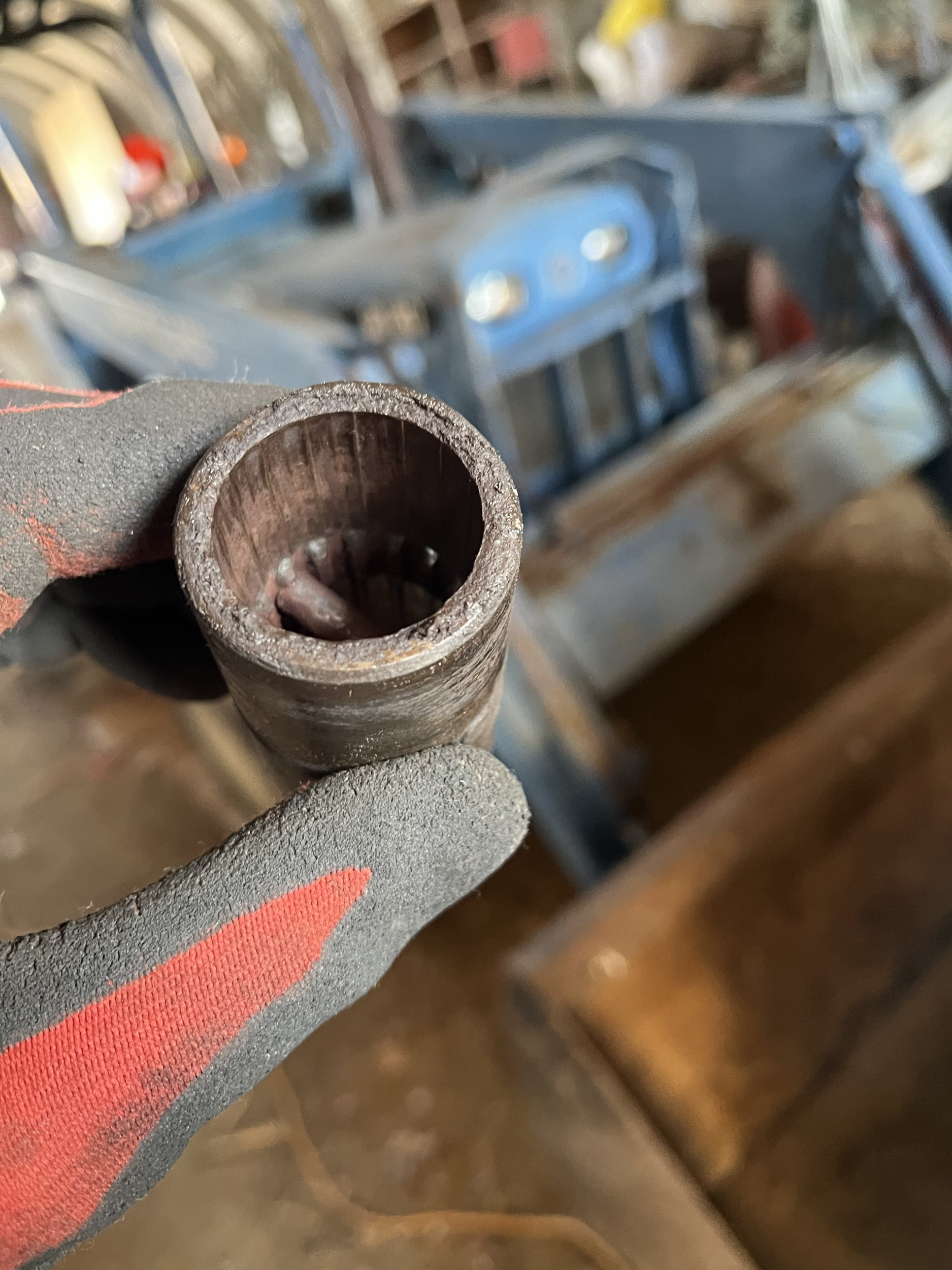

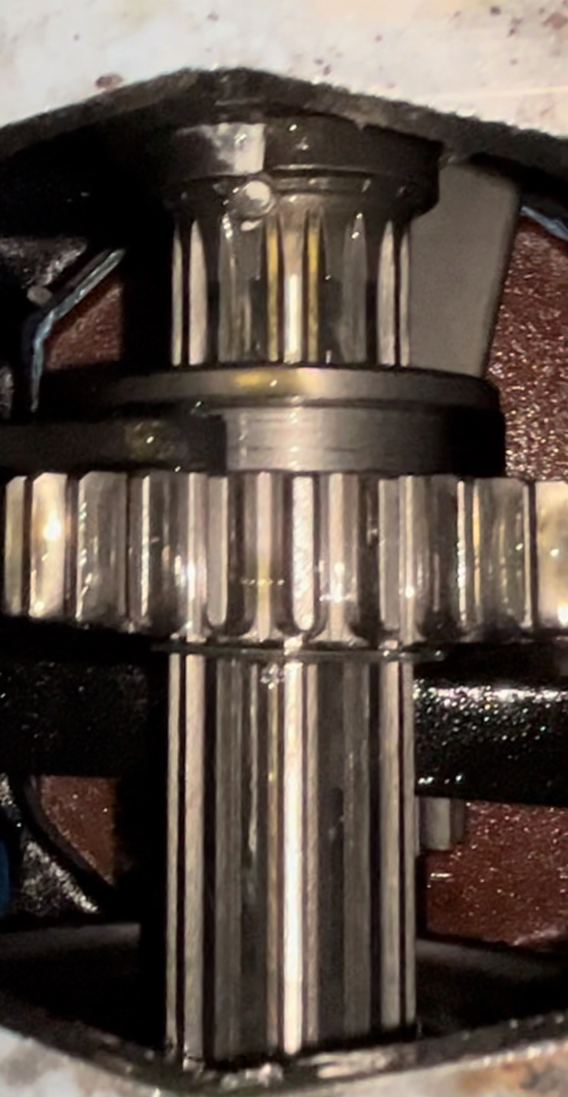

We used a screwdriver and pried the driveshaft away from the front axle. Once off , it was clear that indeed it was the coupler that had gone bad , all the splines were chewed off from one side. A new coupler part is on order for $130. Thankfully the root cause was something simple and fairly easy to get to.
Thanks for your suggestions!

How are the splines of the shaft and pinion? When replacing the new coupler, clean the mating shaft and coat with a quality antiseize material.
Some even seal both ends of the coupler with silicone caulk to prevent any moisture from entering.
