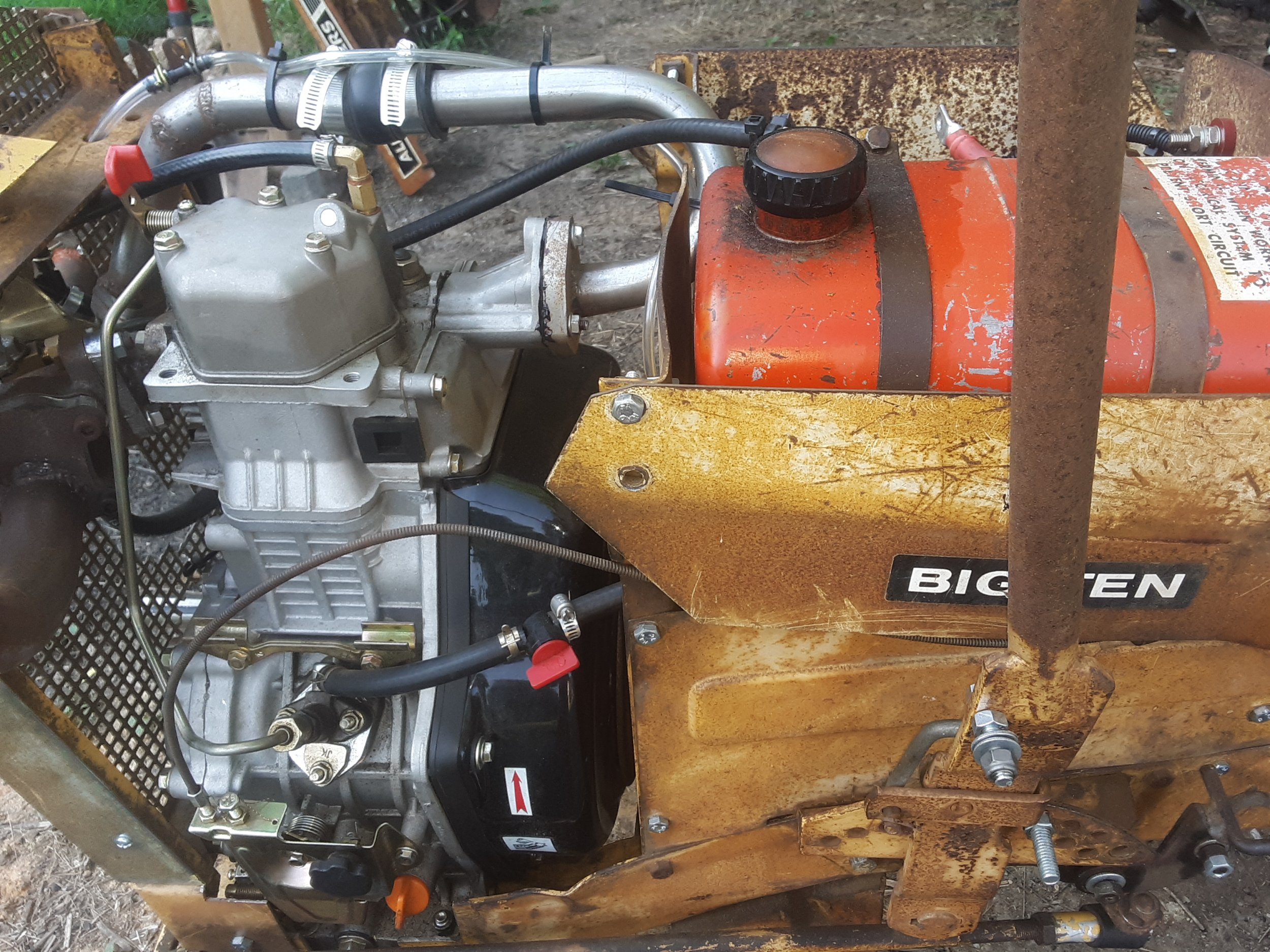

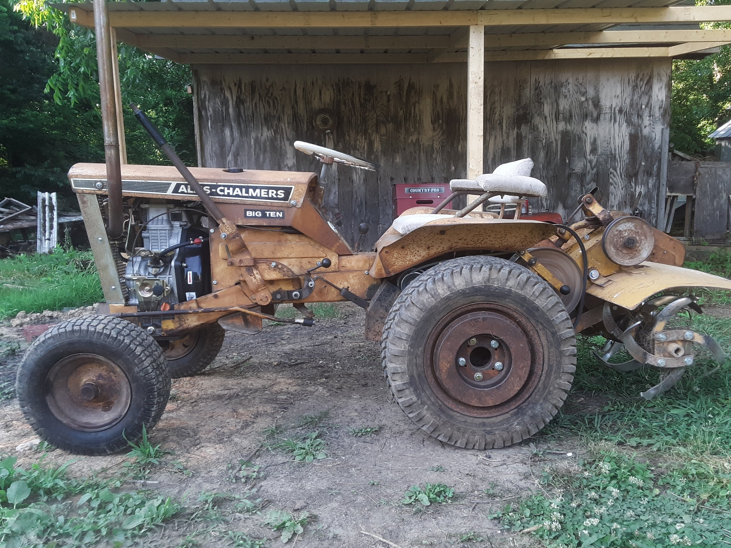

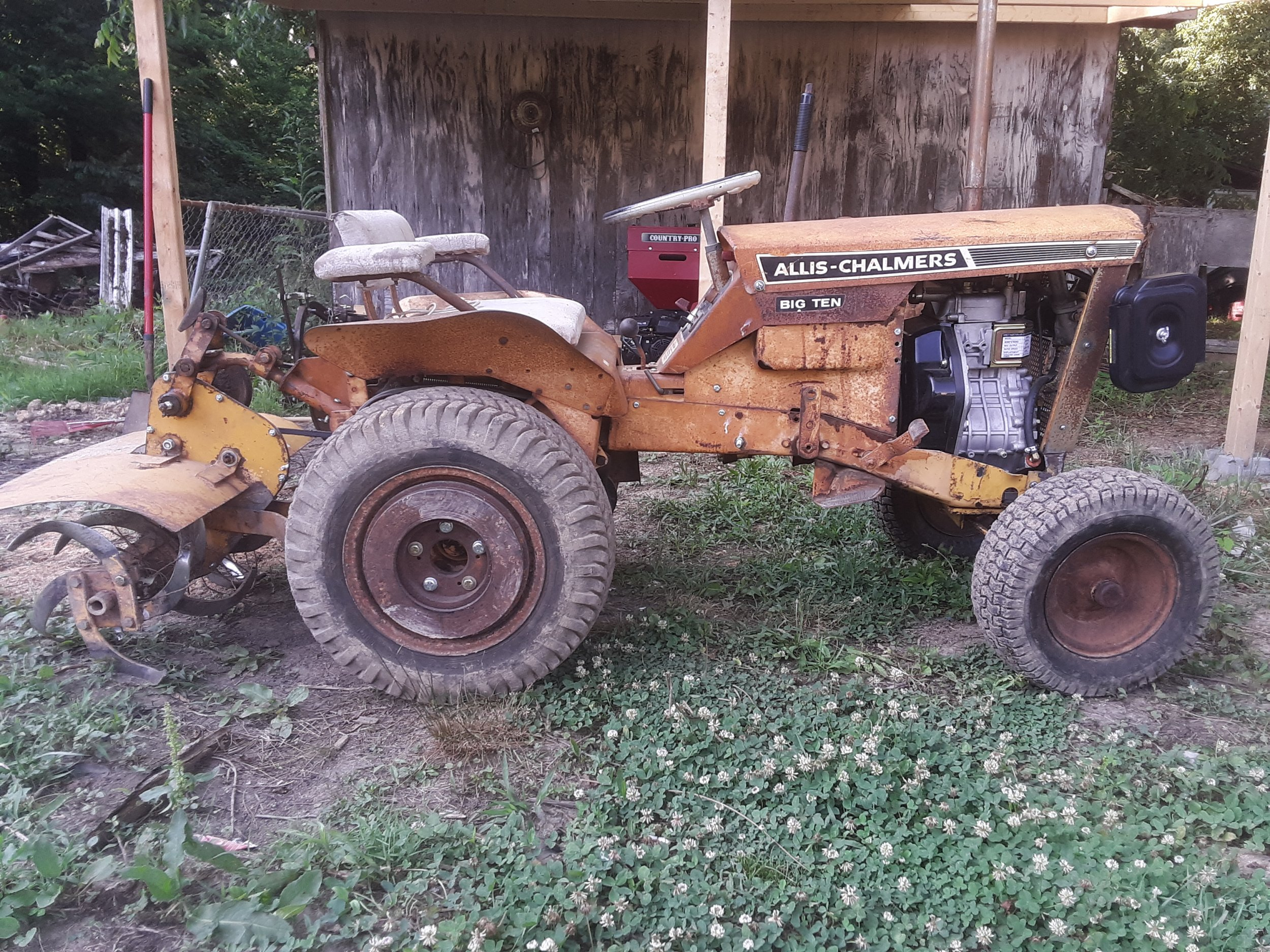

Here are the photos.
The old engine was beyond finished. You could move the crank all over the place. The bearings were worn out You probably wouldn't notice anything was "off" at first glance if the turbo wasnt hanging out the front. I had to BUTCHER the front end to get everyting to fit the frame without removing too much material, but that was the hardest part. The only issue is that I have to pull the engine to get to the oil filter.
To mount the drive shaft I made an adapter out of 1/2" steel plate, since the holes where the starter cup goes are all off center. Its attached to the center of the flywheel with counter sunk metric grade 12.9 8mm bolts and thread locker. Everything else bolts to the adapter.
I tried to use the starter/generator for a while, but I could never get it aligned right and it would eat the belt. Every time I wanted to use it I would have to tighten the belt, and that got annoying very quickly. It's not hard to pull start. Just use the compression release and the gearbox starter, follow through with the pull, and it fires right up.
I might tear it down to make a few things on the engine look better and for some bodywork and paint this fall when I don't need it to mow anymore.

I am curious how you are lubricating the turbo. Did you tap into the pressurized oil system?

Yes, it's tapped to the pressure system. I tested the pressure before I installed the turbo and it was 90 psi with a leak at the test fitting. I figured it would be higher with everything sealed up. I didn't want to starve the engine of oil pressure so I put a shutoff valve inline with the oil feed. It's about 1/8 turn open and plenty of oil is leaving the turbo. I have checked it a few times and haven't noticed any excessive play. Just what's normal for a journal bearing turbo. Hard lines for the feed with RTV on all threads. No leaks yet.
For the return, I drilled out one of the dip sticks and threaded it for a hose barb.

Did your engine come with a crankcase ventilation or did you install that yourself? If the latter, did you add a PCV, or use the little ball bearing valve in the engine?

I blocked off the pcv port to the intake in the valve cover and added a port on top to route it before the turbo in the air filter.

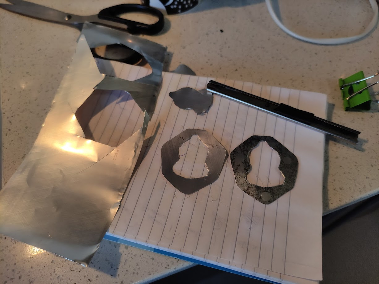

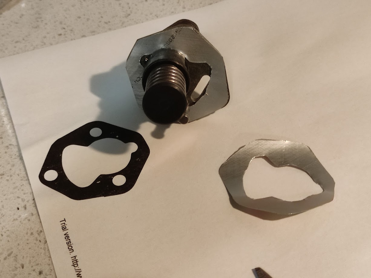

For those living in poor countries or where importing is difficult, a timing shim (injector and pump) is almost impossible to find, they're usually preset at a thick size, I've attached a, A4 PDF file, 1:1 scale timing shim print for the injector pump (adjusted to be slightly larger than the following pics as mine was tight fit). Couldn't remove the existing copper one to cut over as it was in duty and easy to damage as it's too soft.
I've used a laser printer for transfer, using gasket material compresses over time when used in loose fitting so I used a Pepsi/Merinda/7up can, these happen to be 0.1mm exact +/-0.01mm, other sodas and beer cans vary, anyways I simply ironed the paper print on to the surface for cutting reference. The rest were cut on top of the first cut using a sharpie. Cut the metal on a notepad or thick carton for ease. Holes were drilled on top of a scrap wood while attached to the pump for clean finish prior assembly, I don't have a hole puncher set. I live @~1KM altitude which requires advancing the timing, and I confirm as 90cummins mentioned each fuel pump is different, and the cam follower is sacrificial which changes timing slightly on wear.
Make sure to set the toner darkness level at maximum on the printer for best transfer, and clean the metal with acetone prior to ironing.
Not the prettiest, black pitting is toner transfer not residue. It does not stick well but it's enough for cutting reference.

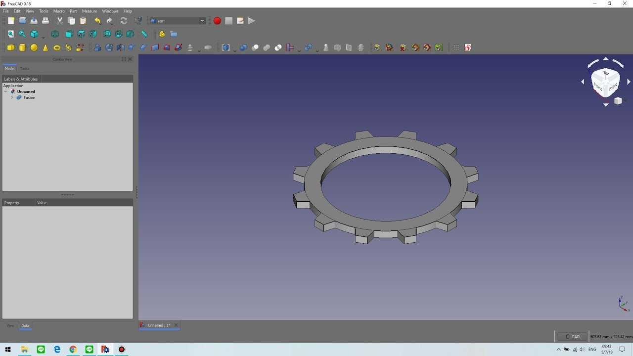

Really nice and clever work.
If you ever need to make a 2D CAD file to share in DXF, then you can install FreeCAD V19. You can also laser cut from the 2D
Even laser cut 2D gears from FreeCAD
3D print, 2D laser cut, share DXF and STEP files - - - - all for FREE.

Thanks! Gonna give FreeCAD a try one day, I took a picture of the original shim and used Scan2CAD to calibrate dimensions and vectorize, I should use FreeCAD over Abviewer for printing 1:1 DXF files from now on.
I've attached the DXF file.
