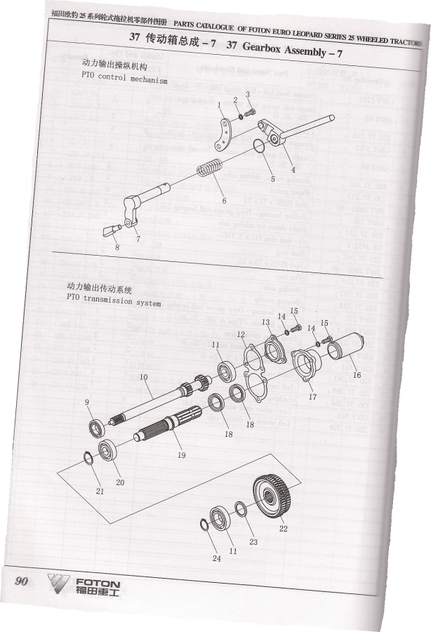

The roll pin seems to be turning fine... unhooking shifter i can place in gear with my hands turning hugger. I can feel it clicking as the slider connects.
dealer is 1h away... charges 150$ to ship...
warranty is free parts for a year... I pay labor
   / foton 254 pto falling in neutral. #12

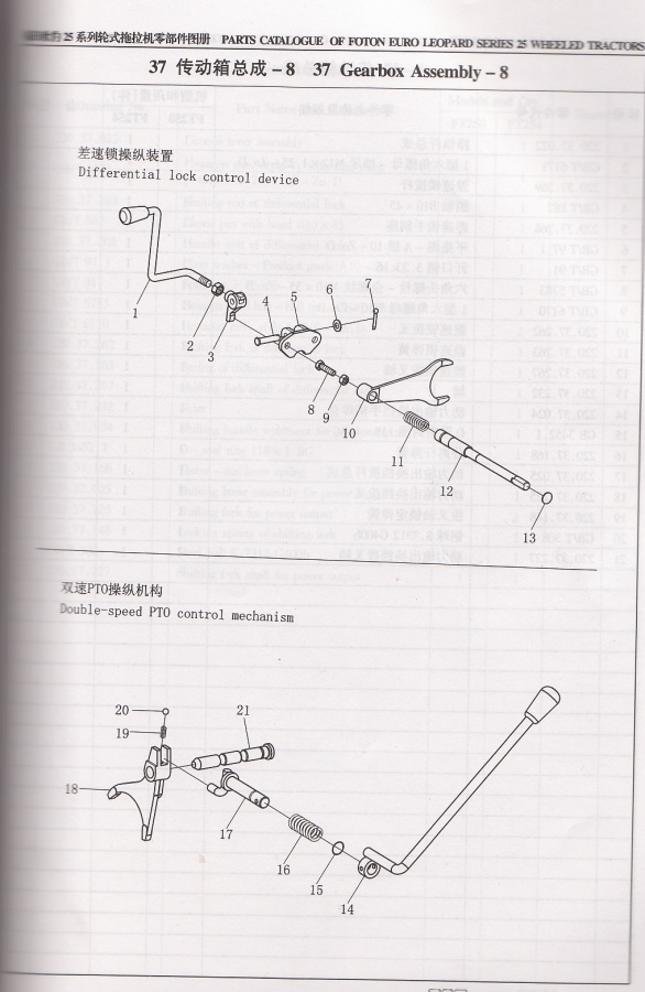

Ty, Here are the expanded views of the PTO.

While my CUT is different make, the setup seems the same.
The lever goes thru a plate attached to the 'tunnel' via 2 machine screws.
With the screws loosened the plate can be 'repositioned' to make for a proper adjustement.
The holes in the plate will be oversized in relation to the machine screws that hold it in place, allowing for the adjustement.
Since 'low' is not fully grabbing then the plate needs to be slid towards the low setting to make for full engagement.
It does not take much movement to reposition the fulcrum point, maybe a mere 3/32".
I have, over the years, needed to reposition both my PTO lever as well as my 4WD engagement lever as vibration (and maybe my size 12's) tend to loosen and allow these levers to go out of alignment.
Hope this helps, and good luck.
When you shift to low, do you feel a 'click' to confirm the ball/spring dedent is working?
If yes then the adjustement proceedure should correct the situation.
