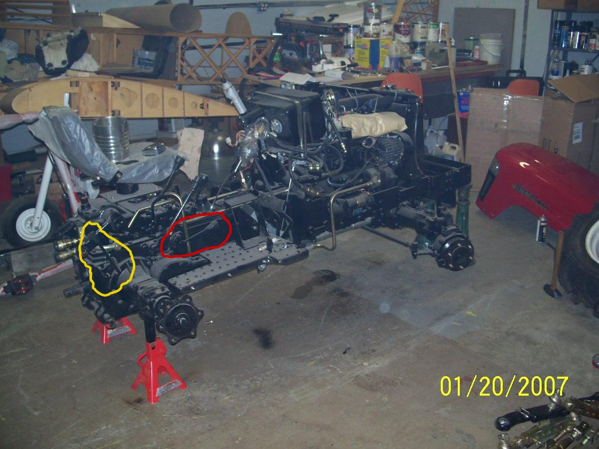

   / Foton 254 #9
Ha! There was a picture in my files that actually shows a better view than taking a new one.
The red circle is the main PTO engage lever and the yellow circle is the speed select lever
   / Foton 254
I have a rod sticking up through the floorboard on the right side. I thought it was differential but I may be mistaken. I’ll check it out in the morning. Thank you very much sir!
