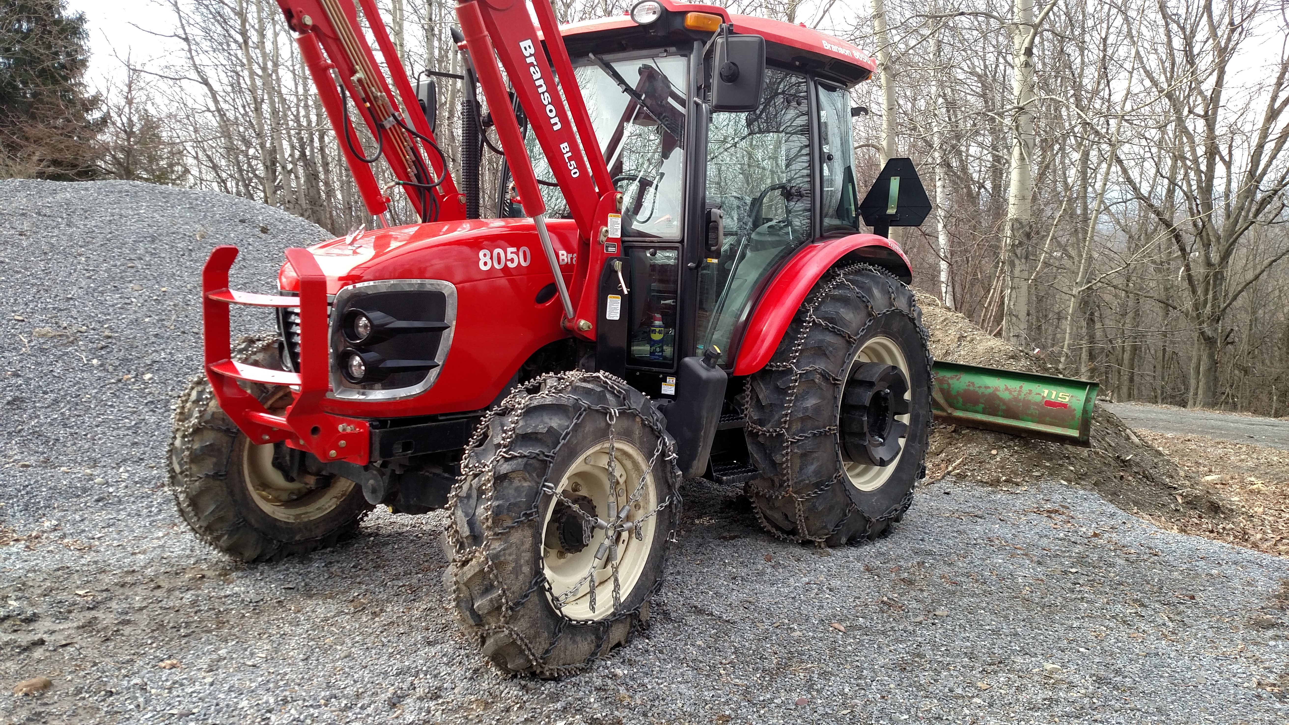

I have a set of front chains but I almost never bother with them, I have adequate traction with the style chain that I run now, I would conservatively say that they have twice the grip of two link spaced v bars.
If they are forecasting a major ice storm I will get them out, I've only used the front ones for a few storms.
