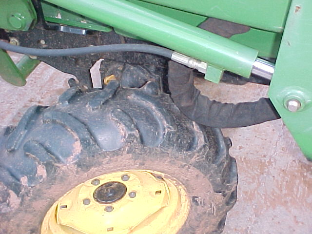

Ever had this happen to you? My FEL hydraulic hose bundle is long enough to touch the front tire. Nothing bad has happened, but it's disconcerting to see the hoses bouncing off the spinning front tire while driving along. The fabric covering the bundle is intact, but well scuffed from years of close encounters. I've been concerned that this is some sort of an accident waiting to happen.
The attachment gives you an idea what I mean.

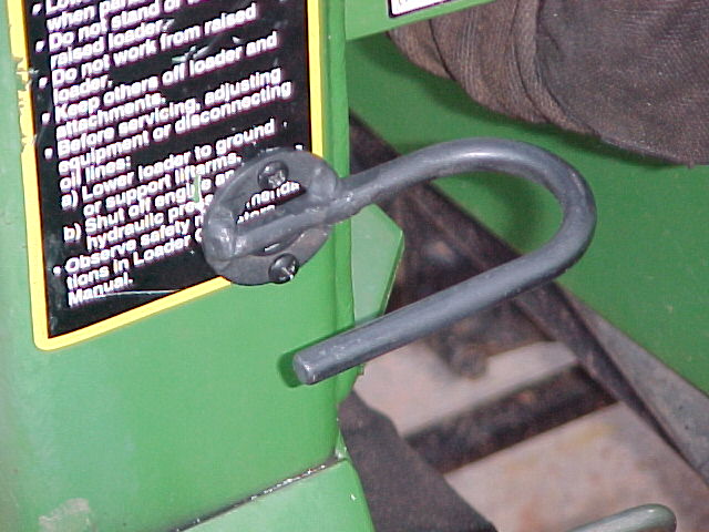

Yesterday, the idea bulb lit up. I mounted a "hook" to the FEL mast with a couple sheet metal screws.

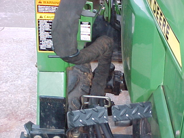

Here's a pic with the bundle restrained by the new hook. Although it is hard to tell from this angle, the hose bundle is several inches away from the tire now.

It doesn't look like a real problem unless it tears up the loom covering the hoses or it gets caught on something. I've seen lines with the cover rubbed and rotted off of them and they are still good. Could you tie it up a little with some heavy wire ties?

I was typing; you were posting. The hook should fix it and it looks good. Surprised at the amount of hose looped around in your picture. Is that the normal fel hose routing?

Ties work nicely to keep the hoses out of the way, but to mount and unmount the FEL the whole length of the hoses must be able to stretch out. Ties would have to be cut or "undone". The hoses can easily be freed from the hook for implement changes, which is a plus for me since that is something I am often doing.
The hoses usually aren't real close to the tire when I first start the tractor up. As things warm up, they sag, and before I know it the hoses are dragging on the tire.
To the best of my knowledge, this is the normal routing. However, for whatever reason, my FEL hoses my be a little longer than normal /forums/images/graemlins/confused.gif. I don't know if anyone else has this kind of situation.

Tarp straps or as we say "rubberbands" work well and are cheap. I have that same problem on my new 5030 HSTC and I used the "rubberband" fix.

I have the same problem with my 790. The routing looks about the same as yours too. I don't worry about it too much but the next time I get to spend some "quality maintenance" time with my tractor I'll figure out a way to tie them back better. My loader has a little wireform clip that is supposed to hold the hoses back but it doesn't work well. I like your solution /forums/images/graemlins/smile.gif
