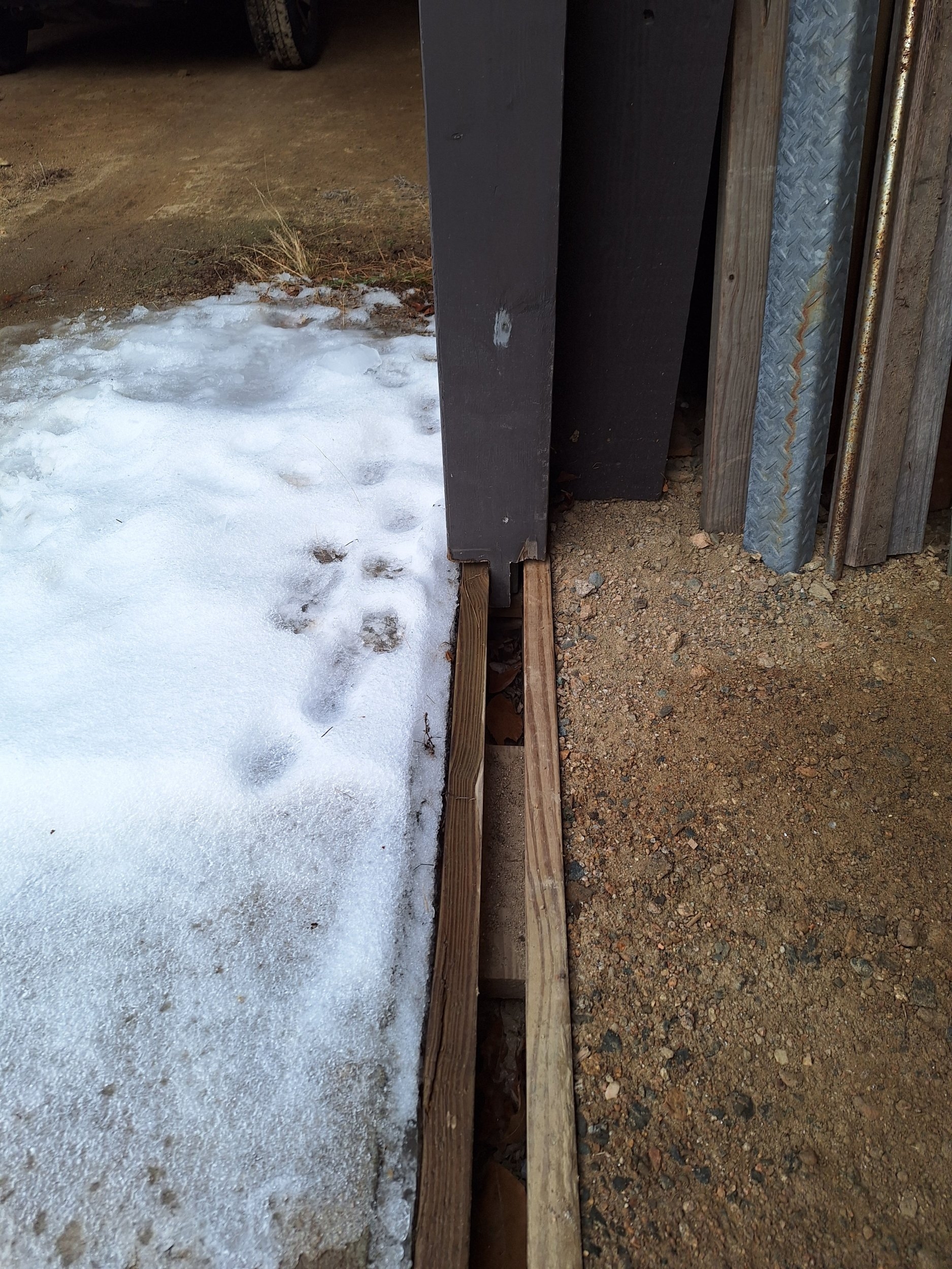

I have (large) sliding doors on my pole barn, but I only need to open one of them. Every winter, the frost heave causes the door to bind and I find myself trying to dig out the door's path in the gravel. It's annoying and sometimes its frozen and I need my pick axe. Short of pouring a concrete pad (or replacing the thing with a roll-up), anyone have similar issues and/or solution(s)?

What type of sliding door?
I have a similar problem on my shed. The ramp into the shed heaves and causes the door to stick.
In my case the door has adjustable rollers at the top that let me adjust the door a little higher.

Raise the door track and screw on some round baler belting to act as a flexible seal. If there is ice or snow accumulation also blocking the door base, put some water softener salt in the track. Good for 20 deg & above. Or even put a heat tape down there.

They're just regular giant steel panel with 2x6 wood bracing 12' tall by 12' wide (each) doors. I've seen those "tracks" in poured concrete and don't want the accumulating water/ice issue. I've adjusted the top door tracks so there is pretty good space beneath it, but that seems to get smaller every winter. Other than a concrete footing and pad, there's no real/permanent solution - so I just gotta keep the space clear. I like the rubber belt idea, to try and keep it clear though.
I wonder how much a roll-up door conversion would cost? $10k I bet...

pouring a footer and laying concrete blocks under the door makes that go away.
   / Frost heave?
#9
I can do that... How deep should the footer be?
