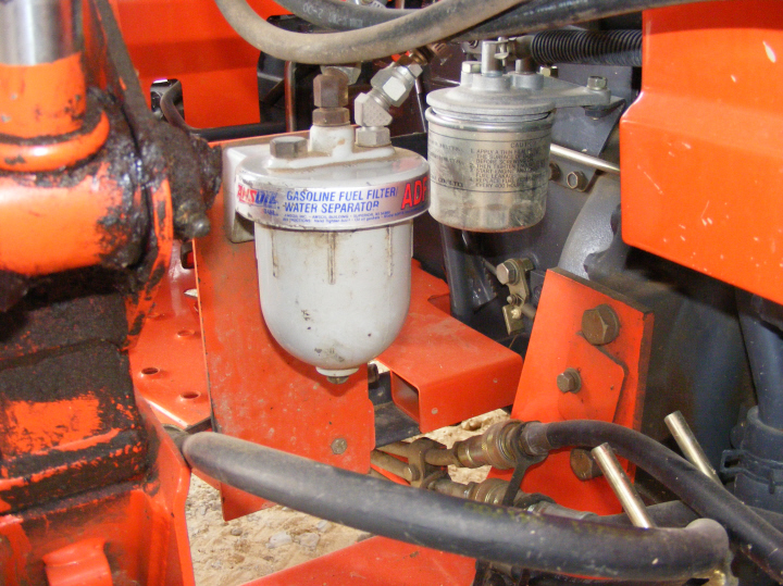

   / Fuel Filter Selection #5
It may not interest you but I have a Dahl 75 filter plumbed as the primary filter on my L3000. it's rated for up to 90 hp and the elements I'm using at this time are 2 micron rated. In almost 1400 hrs I have only changed my factory filter 3 times. One of those was because I dumped water in the tank from a dirty jug. The other 2 times the factory filter was not clogged or causing any problem I just changed it just because of the amount of hrs in service. I bought mine from Amsoil but they since have dropped the Dahl line. I don't know who all does sell them but they are listed in the Baldwin filter catalog.
