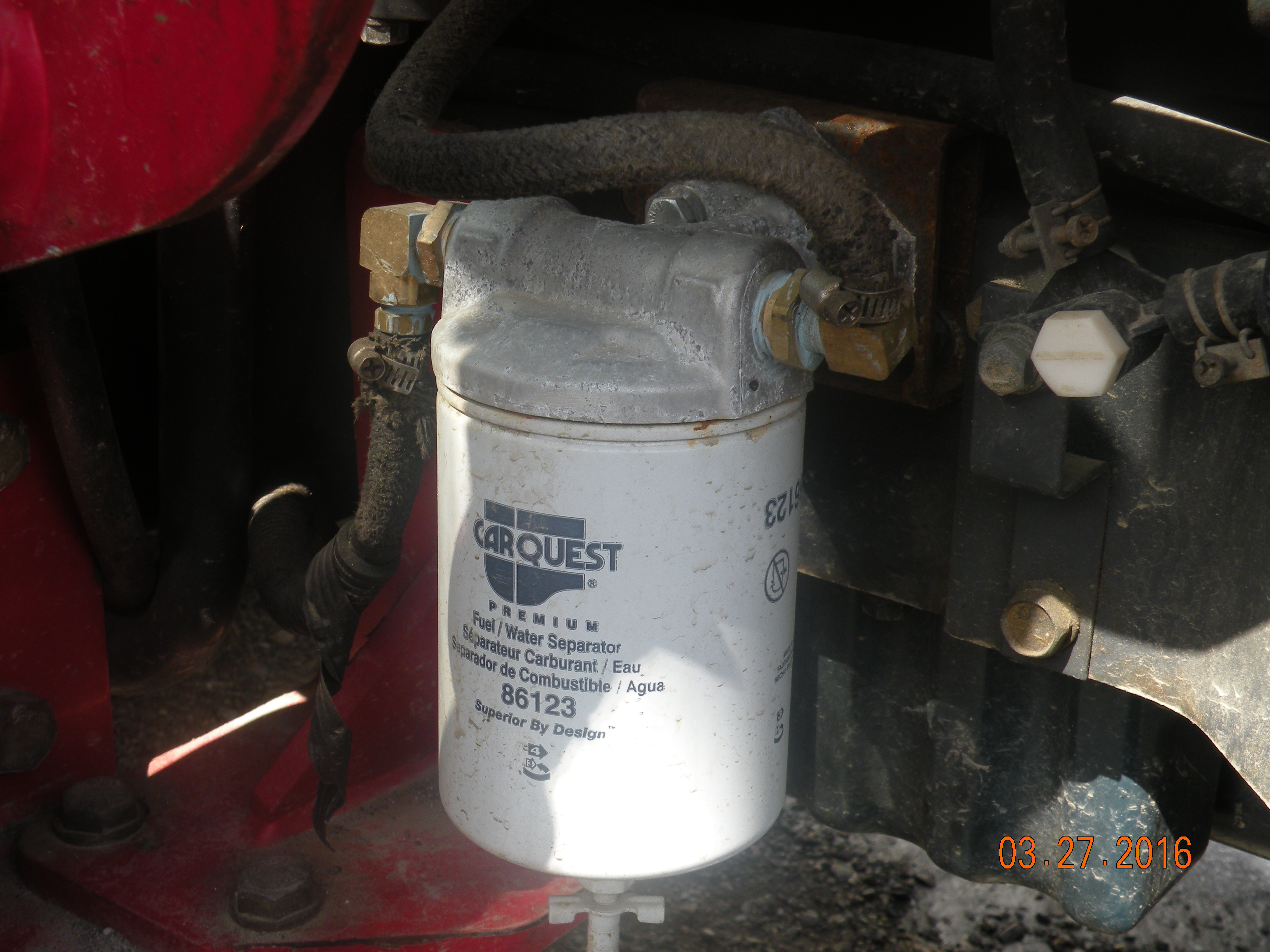

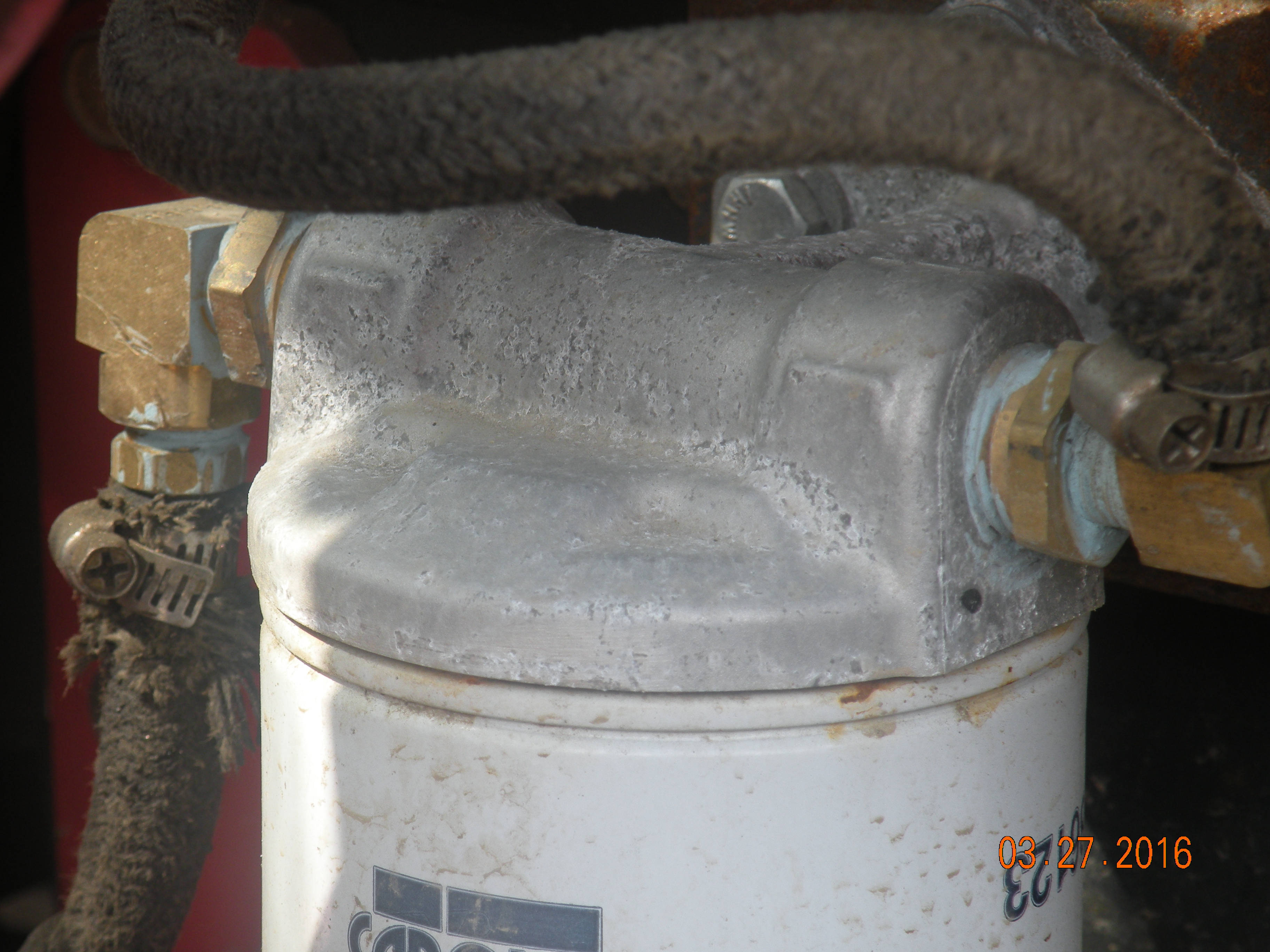

So my fuel filter sediment bowl started dripping.Took it off and noticed the bottom of the plastic bowl was cracked.Called the dealer and was told we can have a new one for ya in about 2and a half weeks and the cost is 70 bucks.Well I couldnt have my tractor down for 2 weeks.Went to my local car part store picked up a new filter block and a new fuel filter to fit it and this is the result.Lot bigger filter and all done with about 60 bucks in it.This was on my TYM T451 45hp 004.JPG005.JPGH]

Wow. $70 bucks for a plastic bowl? A Racor is in that price range for the complete set-up.
Your rig looks good.
