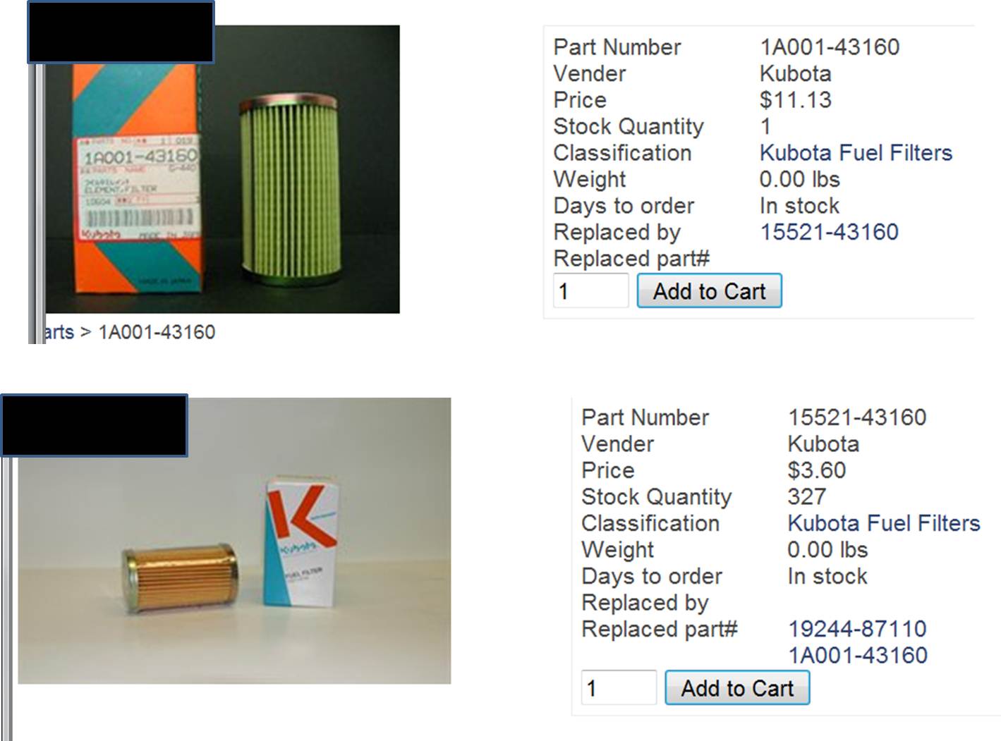

I am only posting this as awareness for those purchasing fuel filters. When pulling up parts for my tractor on the popular web sites I noticed two fuel filters are called out. One is 3x more expensive. The good thing is the least expensive one appears to be the latest revision.
Cross referencing the p/n's to a Wix Filter number shows this filter is used on numerous other applications. Perhaps some else besides Kubota users will find it useful. (Wix #33507)
Like I said this is just a heads up and maybe someone can enlighten as to what the difference is.

If you look at the two filters, one is Japanese sourced and the other is sourced by Kubota in the US. Sometimes you can only get the Japanese filters for some of the Hydraulic filters.
You must watch some of the crosses though, on my BX2230 the Wix cross for the fuel is just a strainer screen instead of a finer paper element filter. A good parts man at the dealer is always good to have on your side as he will hunt the deals out for you.
