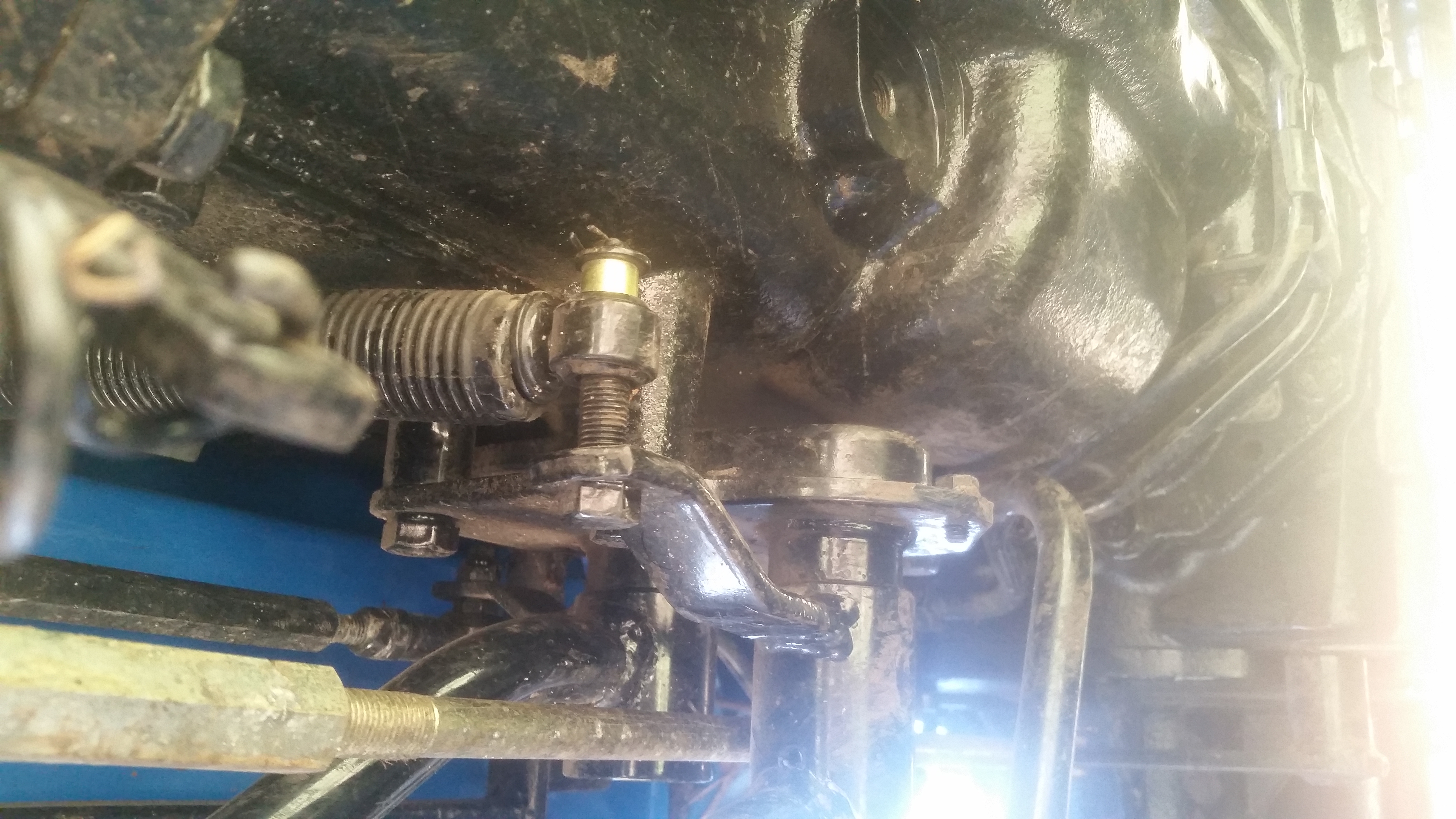

These are the two pictures I took. The first one shows a piston like thing that is attached to a bolt. Looks like it slipped off a little (gold thing exposed). I tried pushing it back on to that gold ring and it didn't do anything different.

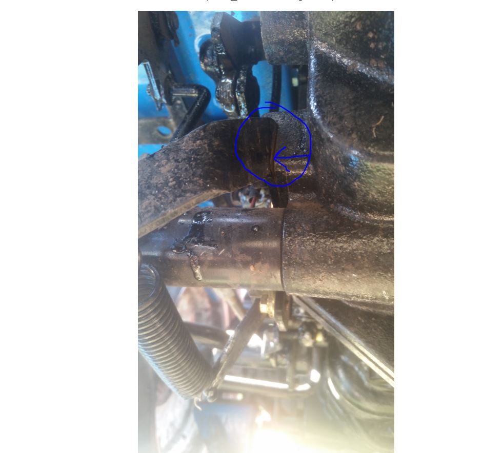

The other photo shows that spring that seemed to help some. Where the blue arrow points, that piece that attaches the spring was bent away from the "frame" where it's attached. The spring attaches to that piece with bolt and a nut on each end of the flat bar. It seems maybe that spring needs to have more tension pulled on it but those nuts don't seem like they're meant to be adjusted.

For those that haven't spent much time under their tractor, the first picture is some type of piston thing that moves when the peddles are pushed. The second photo spring seems to be what pulls them back into place. If i remember correctly

The cylinder is a damper that "slows" the compression and return of the pedals, basically just slowing the movement. It is NOT pressurized like a gas strut. If you remove it, it would not affect the operation. If you did remove it, the pedal would be more sensitive.
On my MT125, there was a service bulletin that replaced that same cylinder, I could not tell the difference between the old one or the new one. The dealer did not know why they were being replaced, he assumed it was a manufacturing defect affecting some of the original ones.
For the bracket that you highlighted with the blue arrow, no there is no adjustment there. The end of the bracket were the spring attaches, may be bent allowing less tension on the spring.... can't tell from the pics
