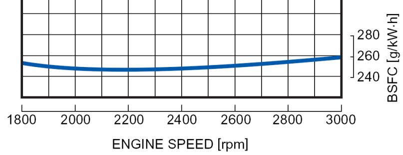

Sorry, but this is nonsense. Turbodiesel engines have lower friction/hp, higher HP/weight, both of which are critical factors affecting fuel efficiency in a vehicle application. The most fuel efficient engines on the planet are turbodiesel engines and they have held this status since the 30's.
