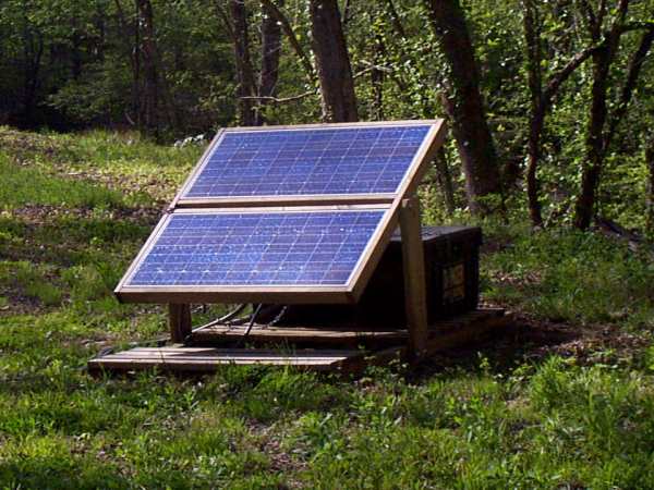

Is that your solar panel? Can you tell me a little about it like wattage and what you use it for like household applianes and such. or is it just for lighting.
   / Gantry Crane
Hi TT, The place in Lawrenceburg is coming on nice, slow but nice. We hope to put a foundation for a shop/barn/apartment in this summer. right now just trying to get the place cleaned up. On the solar panel, I built the system on a skid and it is a 120 watt solar system. I have 6 batteries in the system and am able to power the 12 volt systems on our trailer for about a week with low sun. We also have an inverter system that allows us to use the coffee pot and the microwave. I put the system in as a temporary fix. The power company won't run poles until we have a permanent foundation. I wanted some way to have the comforts of home while we worked on the land. I also have a 100 gal water storage on the hill behind the trailer. I pump water up from the creek and use it gravity feed for showers and flushing the toilet. So far the setup has worked great!
