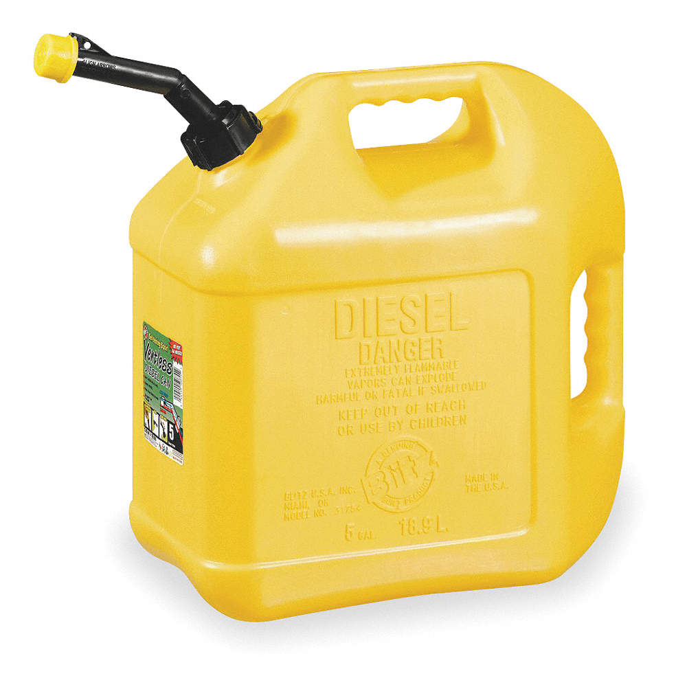

Yep, the diesel pumps at my local petrol stations have this 'speed' button/function... that, and the diesel nozzle is larger in circumference so that it shouldn't be able to go into a vehicle petrol tank.
It won't even go into a can like this:

If you get rid of the EPA nozzle on that can and put a high flow nozzle on it with a vent then it helps. My fuelling station has one of each nozzle and one time I got stuck using the big nozzle. It doesn't fit into the can but if you can vent the can by opening the old style vent then at least you don't get fuel spraying out from the air trying to escape.
As far as speed, the pump at the place I go to seems fast regardless of which nozzle I use. When I use the correct smaller nozzle in my 5 gallon cans I can almost fill them very quickly, like I can get about 4 gallons into them in about 10 seconds but then I have to wait for the foam to dissipate before I can get the last gallon in.

What he痴 saying is the diesel nozzle barely fits in the neck opening of that fuel can. Those Midwest cans also have a **** baffle inside that won稚 allow you to BLAST fuel in them.
I looked at one today and was wondering if you could remove the plastic baffle THANG.
Effin protect me from myself crap is ridiculous ! :fiery:
   / Gas station’s diesel pump nozzle too big? #28
I just received the fill adapter but have not used it yet. The part that the station's nozzle fits in is 1-5/8" ID. The DIA for the part that fits in your can is 1" and necks up to 1-1/4".
