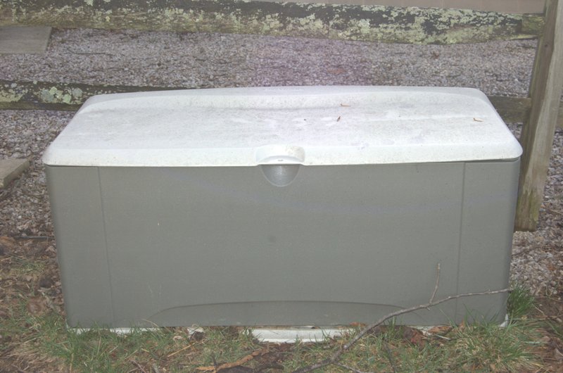

/ gas storage in plastic deck box? #12
I've been using one for about a year for most of my flamables with no problems. My garage is attached to the house so it just makes me feel better to have them somewhere else. Mine is located under a tree so it never really gets sun in the summer.
