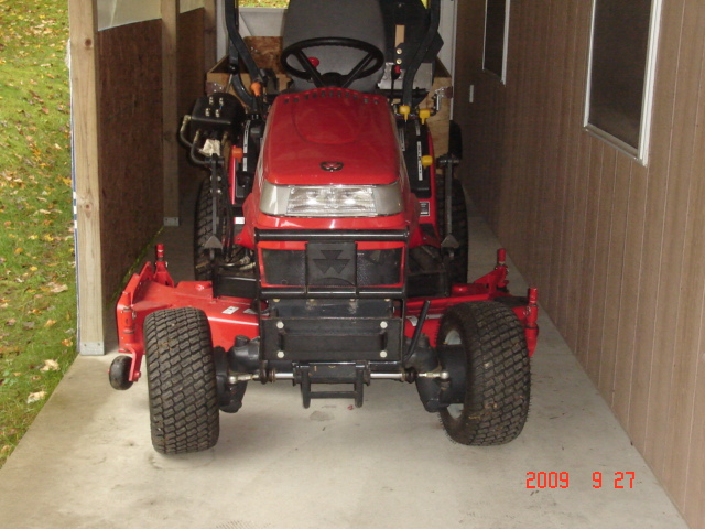

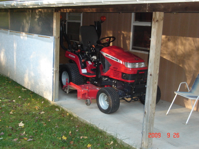

I took the discharge chute off my 60" MMM so I could fit it in my parking space, and I've found that it shoots the clippings out very nicely, scattering them pretty evenly-- no furrows, no raking! (At least, not that I'm gonna do!!:D)

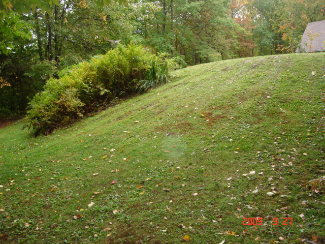

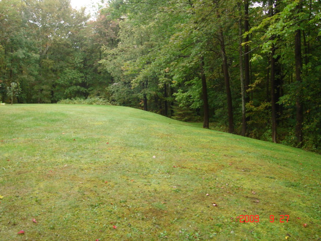

Paystar-- in the "for what it's worth" dept:
Here's a couple shots of the slopes I deal with. Yesterday I tried to see how much mowing on the side slope the tractor could do. You can probably see that the 2310 was able to do most of it that way, though on the steeper slope I didn't mess around- did it vertically.
Without the flapper-damper discharge chute, 60" deck is just 62-1/2" wide overall.
