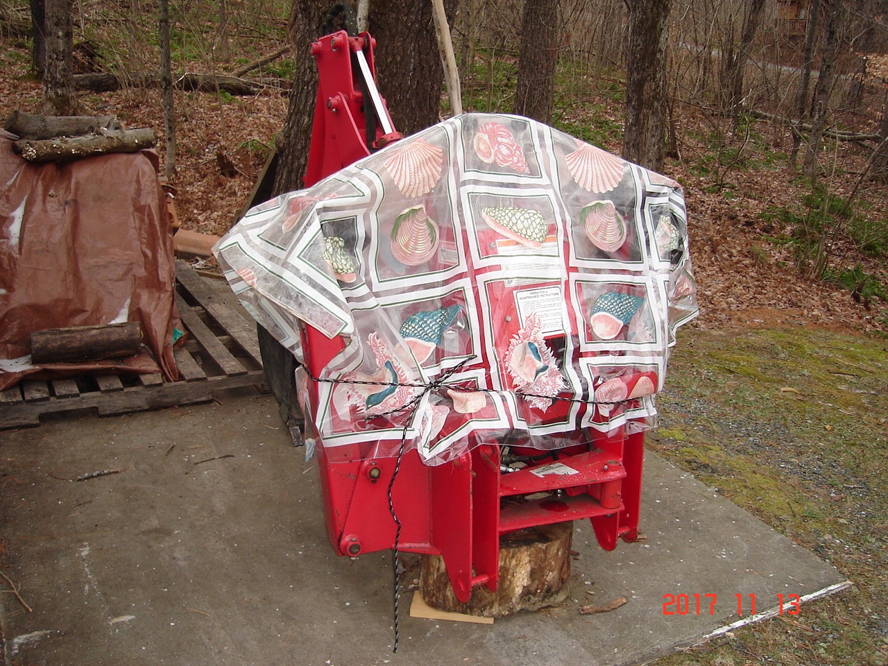

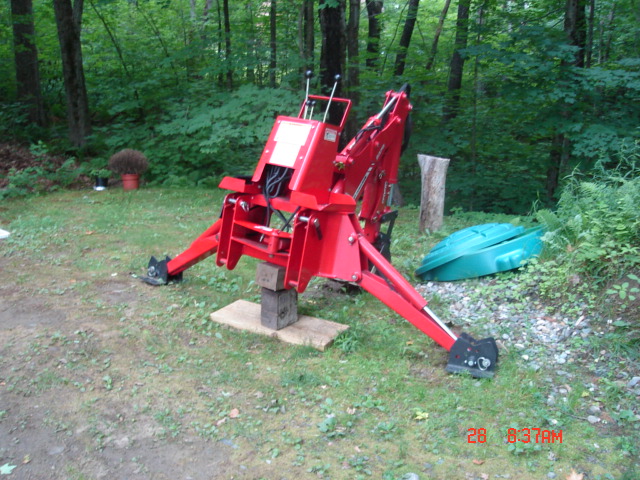

Me, too... I'll let the block heater run for longer, sometimes as much as three hours, before starting... BUT always let it run for some time before using, depending on temp. Hydraulic fluid needs to warm up, too!
As far as the backhoe, yes, that's normal. If you have a hydraulic shop make up three extra hoses, around 24" long, you can then operate the BH hydraulics while the tractor is still a couple of feet away - no more fighting in a small space to connect & disconnect. That will also enable you to set the BH down on its bottom (I use a wood block to keep it a few inches off the ground), and then fully retract the stabilizer arms. I used to store it like you, but found the same problem-- the arms will slowly retract and the BH will begin to tip.
Here's a couple before & after pics of my BH in storage.
PS-- when operating the BH, those three extra hoses tuck right into the space beneath the BH and pose no problem. You can see them in the second pic.
