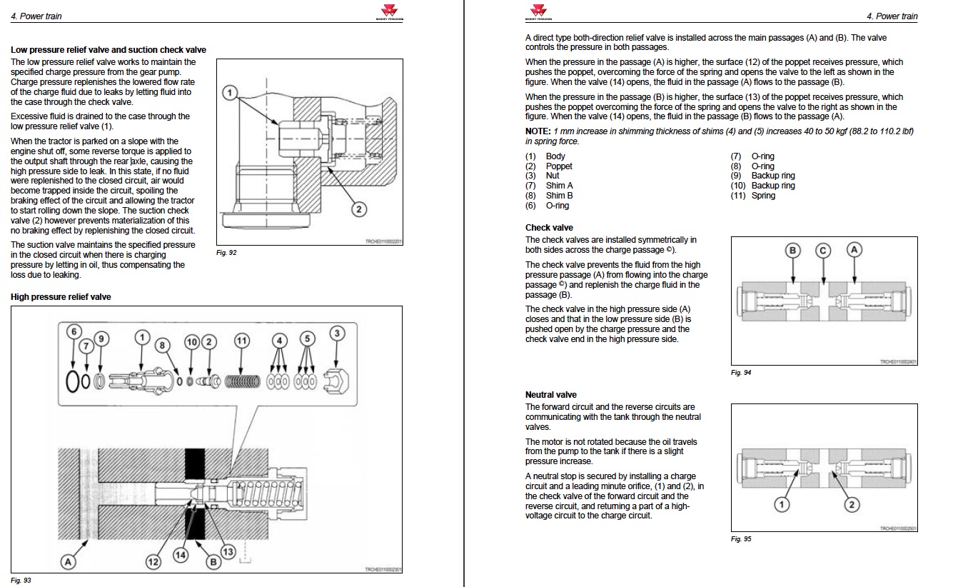

Could my tractor have some sort of power loss or something? Anyone else experience this? I am wondering if this is supposed to happen or not. Maybe my PRV started diverting when it couldn't go anymore. But again, the box was not that full and couldn't have hung up on a root where I was, I checked.

The pushing back of the pedal under load is a normal function of a HST. Linkage styles vary the amount of pushback that you feel.
Weæ±*e you in high range or low range? Reason for asking is that my Branson may or may not spin in high range but will always spin tired in low range.
   / GC1720 - Deadheading hydrostat? #6
Any chance your wheels spun inside of the tires. This is fairly common if your rear tires are filled with rimguard and the air pressure is too low in the tire. If not the case, and likely isn't, it would seem your PRV is set too low or is defective. Of course the tires should spin, especially in 2wd. And they should spin in 4wd unless you were on some rough concrete and in high range. In high range the PRV will often open before tires spin, but Not in LO like you had it. Yes, you have a problem that needs to be investigate. Start with the PRV. But it would not hurt to look at the wheels and tires. Especially if loaded with rimguard. Rimguard is slimy.

Very unlikely any damage could occur. The Relief Valves are set up so that it doesn't happen. An advantage of hydraulic over gear systems.
