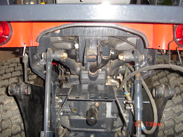

When you removed the backhoe, did you re-connect the return line?
On mine, I need to connect the blue & yellow to each other any time the backhoe is off...
I know you said it was a two hose system, but...

Yes I did connect the return lines. My machine is a 2004, and I am not sure if these are the original hoses so both are black.
