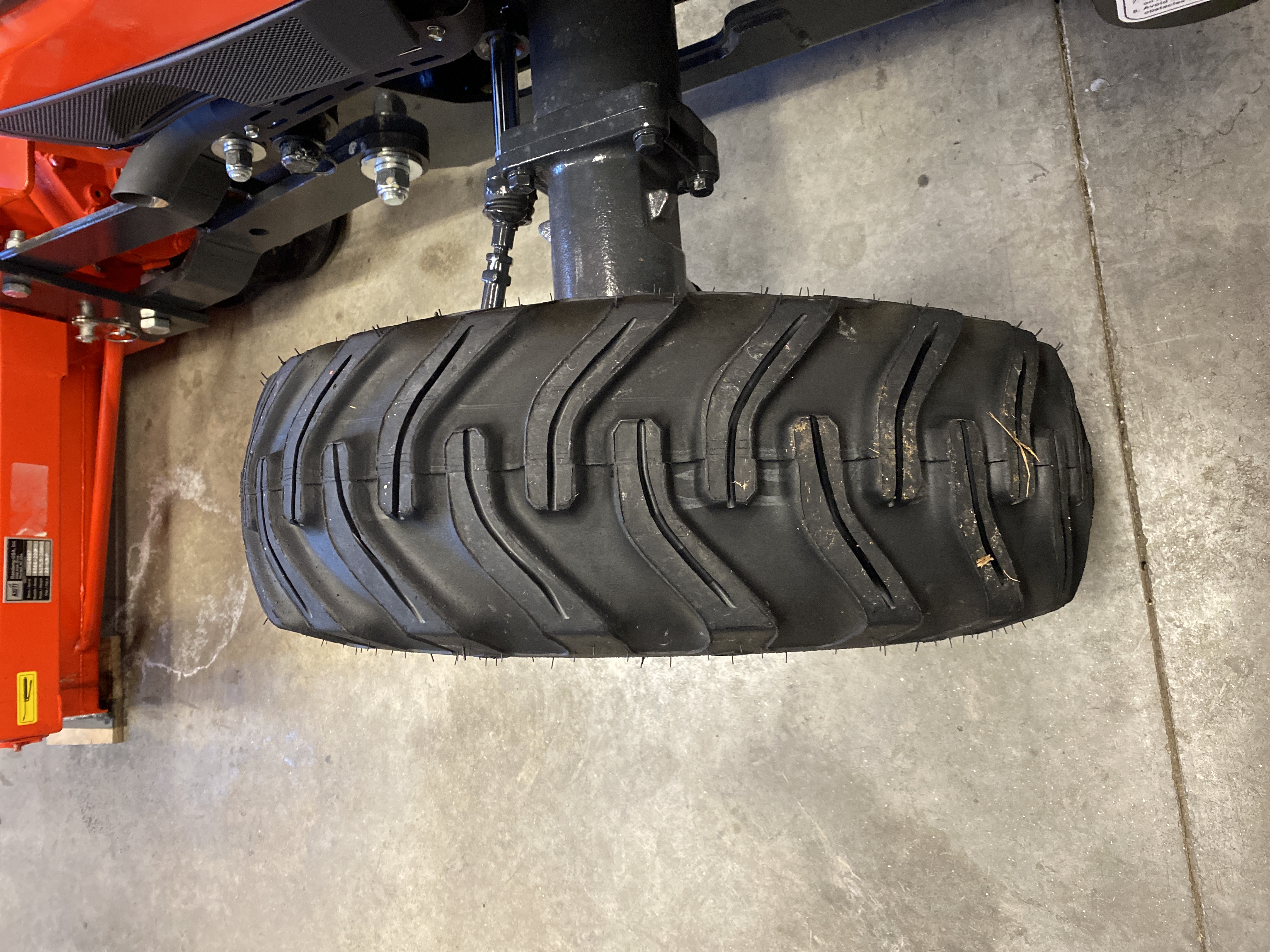

C1743C47-0754-4FCF-8C4F-A9751127A557.jpeg - Unfortunately I can't comment on the R1's, what I can tell you is it made a tremendous difference in my R4's - I go places now that I could not previously without spinning - I'm not sure if just the sips would help, it may, but to me would be limited as the groves would grab and hold forward / backward - I believe the sips would help with turning more than travel.....
