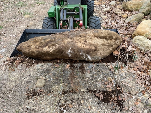

That is a tough decision. I was always aggravated by the errors in the specs on the machines. For example the weight between the two (425-1387 and 422-1344) is 43 lbs different! Yet the 425 is supposed to have a 8" longer wheel base (but the overall length is only 6" difference). So the 43 lbs heavier weight of the 425 is attributed to the 8" longer wheel base and larger engine is there any more for longer loader arms to account for the increased height? Or just longer cylinders? By memory when I was shopping for them maybe 8 years ago, the sizes of the 422/425 were identical. Just the 425 had 2 steering cylinders, ROPS and larger engine. I think the specs even say the 422 has no cooling fan but the pictures shows one. You almost have to go look for yourself in person. Unless they changed them, I bet they have the same lift specs (if same tire size).
The lift height is a big concern if you only have one machine and you figure the many many years you will be using this and the times when just a little more height could have gotten the job done.
If you find that the lift heights are in fact the same, I would go with the 422. I have the PT180 and love it (but with conditions). Like you, I have many trees to cut around but then add in 5 times as many rocks which are just about everywhere at my place. The 018 has small deck but I don't think there is a machine made anywhere for any price that can keep up with the nimbleness of it! I can't say that enough. I have a diesel 430 but still use the 018 for the rough rocky areas (and the fact that I have more control of the deck). It tends to be a lot of brushy/woody material and I probably only run the engine at 1/2 throttle or less and it does great (except for the sparse grasses which it will only cut about 95%) so more than enough horse power proportional to the size. All my PTs have a problem with heat rejection, I watch the hyd oil temp and switch to a different task when they get to hot.
The 180 has some advantages over the other PTs with the more simple cylinder arrangement for the loader arms. It allows for a vastly larger degree of rotation of the attachment (to the point of being dangerous). You can roll the bucket back so far it will start to dump toward the operator if you are not careful. And you can lift the mower so it is cutting 90 deg to the ground and cut back vegetation that crowds in along the fields.
The vintage 018 I have has more then enough wheel torque for all conditions. I actually have a problem not spinning the front wheels a bit when starting off. Don't know how the 422 compares.
Good luck with your purchase and enjoy the research.
