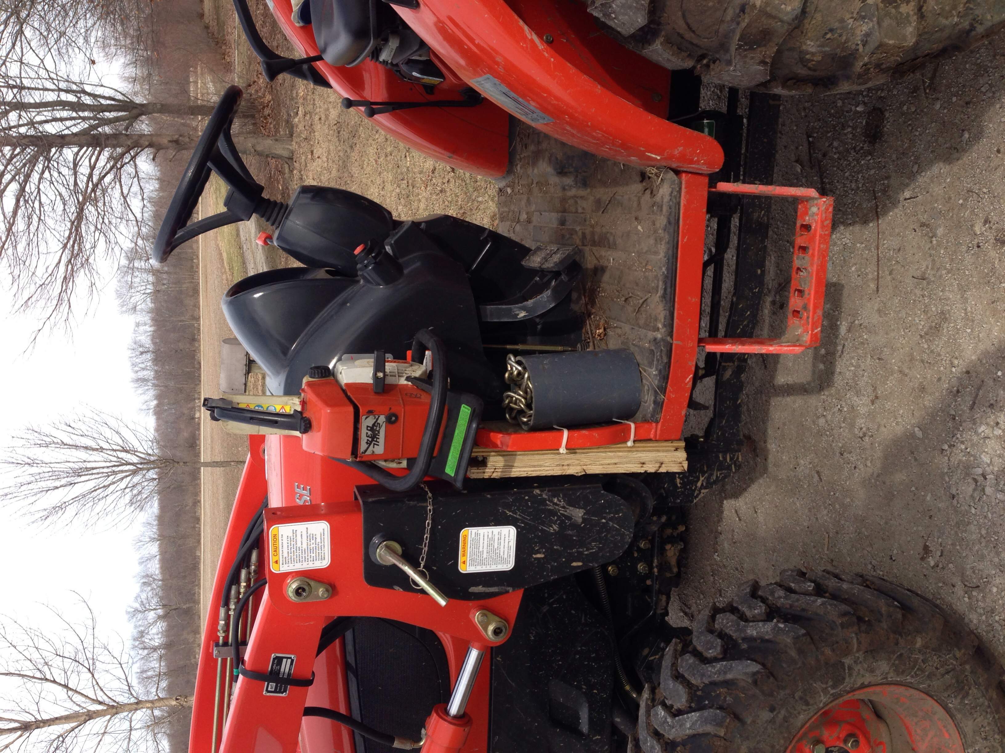

I looked around and just did this recently, dunno if it'll work for your needs. I mounted two 4x4's, one on each side of my ballast box (goes in the woods with me anyway). I just simply used the chainsaw to burrow its own slot in the middle of the 4x4, this holds it straight up and down and the wood isn't going to hurt the chain obviously. I looked for plastic scabbards and didn't have much luck with finding what I was looking for, and didn't want to make it a 5 hour project to make one. It looks good and serves the purpose.

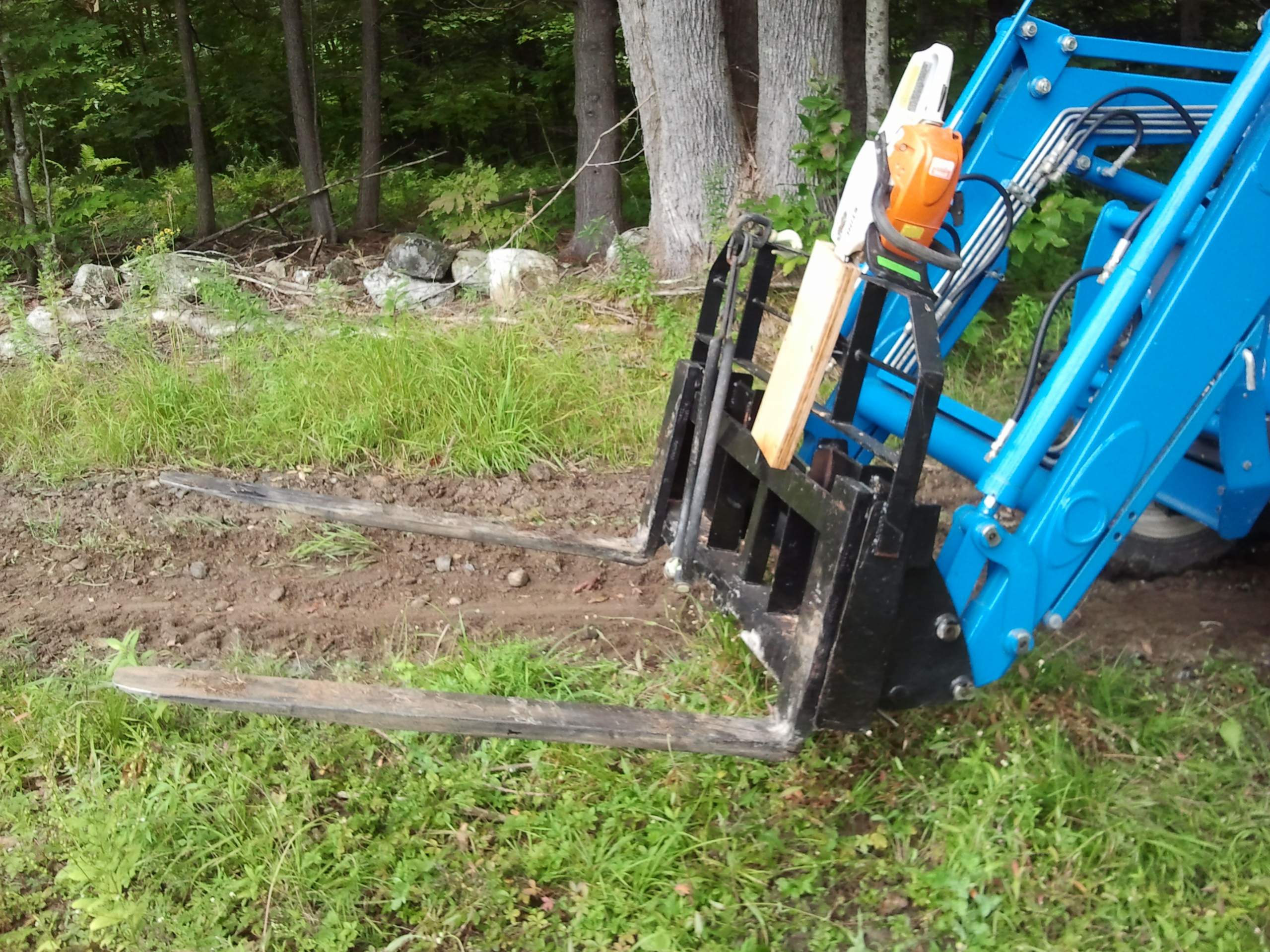

I made a simple plywood scabbard similar to deiselcrawler and mounted it vertically on the cage for my front forks. About as simple as it gets. Image 2.jpg
