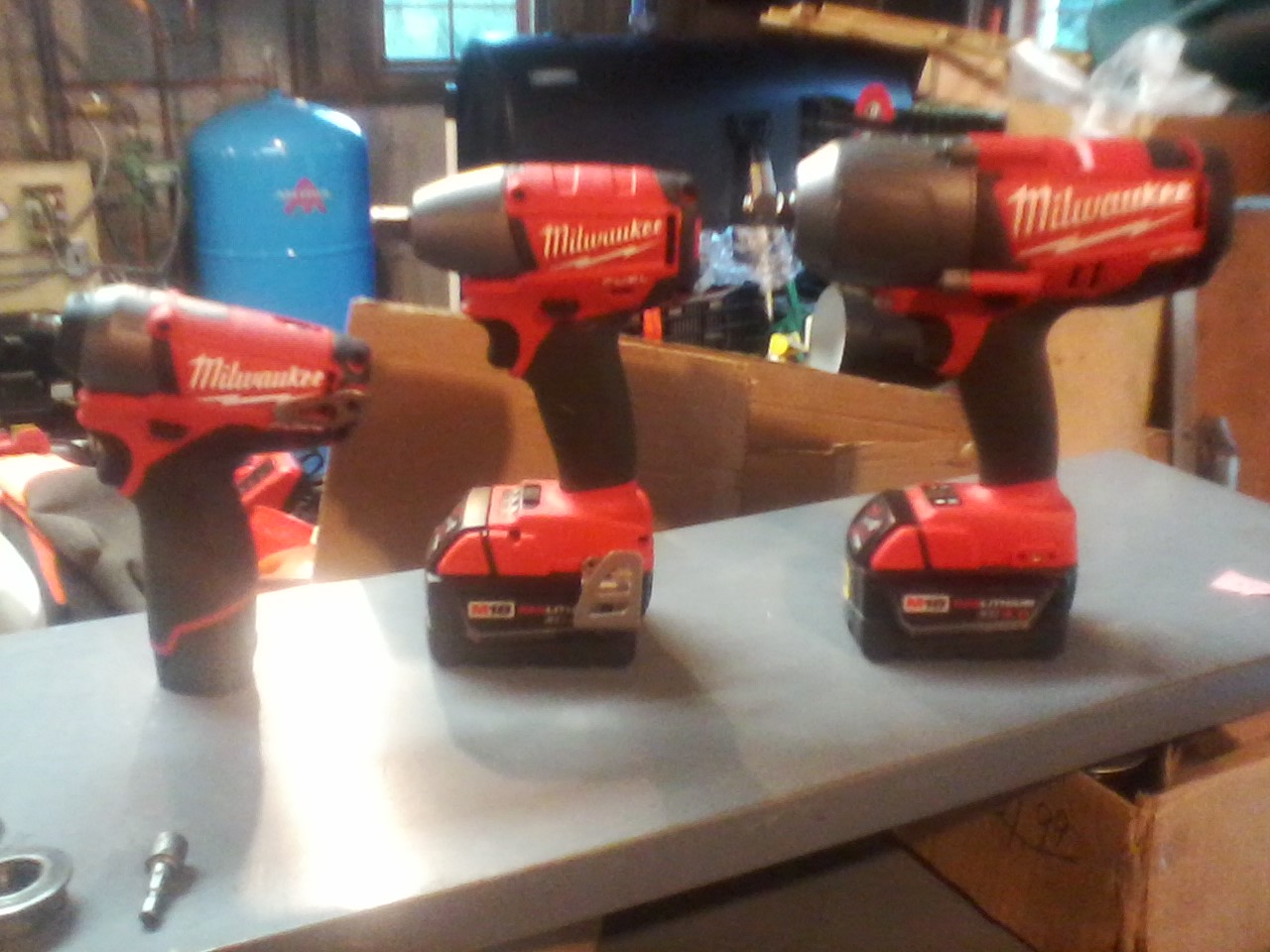

But having just one just doesn't realy cut it if you want to use them often for most general assembly jobs. Control is much more important. I have some single speed Milwaukee impacts wrenches (and drivers) the price is definitely right and they work unbelievably great but I have easily stripped out enough stuff to want the models offering different torque and speeds. You cant go wrong with any of the FUEL models and if you already have some of that color's tools and batteries already...well that is half the battle. Bare tools are pretty reasonable to add IMO. I want a 2464 next. Always nice not use adapters and reducers too! :rolleyes:
Buy the platform you need...if you already have a li-on dewalt add to that.
I'm happy with all mine :)
