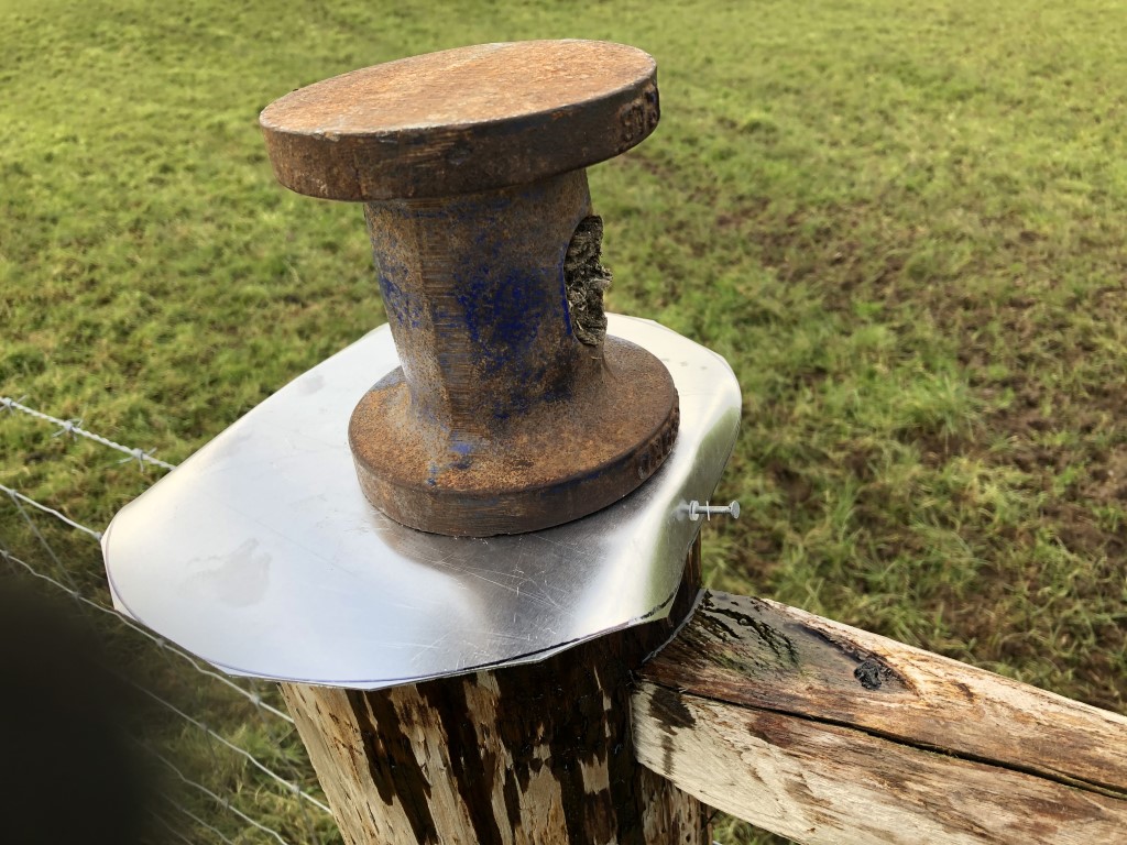

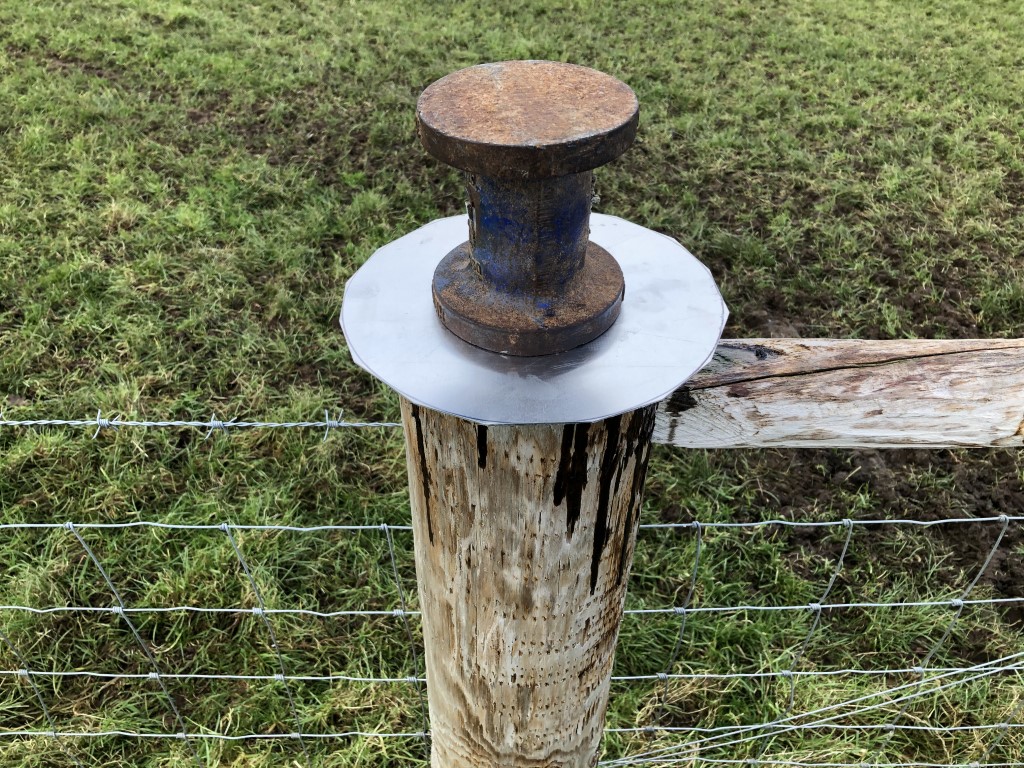

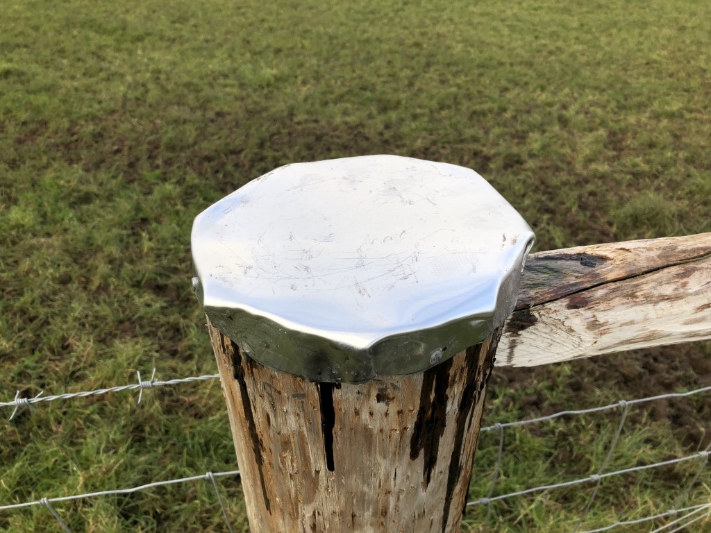

When I first got these fields I noticed the oldest still surviving softwood gates and straining posts were made from creosoted roundwood with a painted steel cap on the top. Those not capped had rotted from the inside out.
The first posts I put in I capped with lead flashing, which I thought was a good way to waterproof them while being very easy to form into shape. Unfortunately woodpeckers soon ripped them open, presumably to get at bugs underneath. With a a few others I used some off cuts of anodized aluminium sheet and those have survived over 15 years so far.
There is a lot of knowledge and creative thinking on here, so as I am about to cap more posts, all 7" to 8" diameter, I wondered if there were any improvements you can suggest. Firstly, if I use aluminium again, it will not be anodized. Do you think allowing this to naturally oxidise in air will give something as durable as those that were commercially anodised ?
Alternatively I can get galvanised steel sheet, which is certainly tough and long lasting, however I find it hard work (unless you have some tips ) to form over the top and down the side of the post.
Also, is there a better way to form the cap for weather protection than what I do now - nailing in 4 places with galvanised nails, then use hammer to fold into a roundish octagonal top ?
View attachment 682381 View attachment 682382 View attachment 682383
That’s about the way I would do it. Except use self drilling screws.
