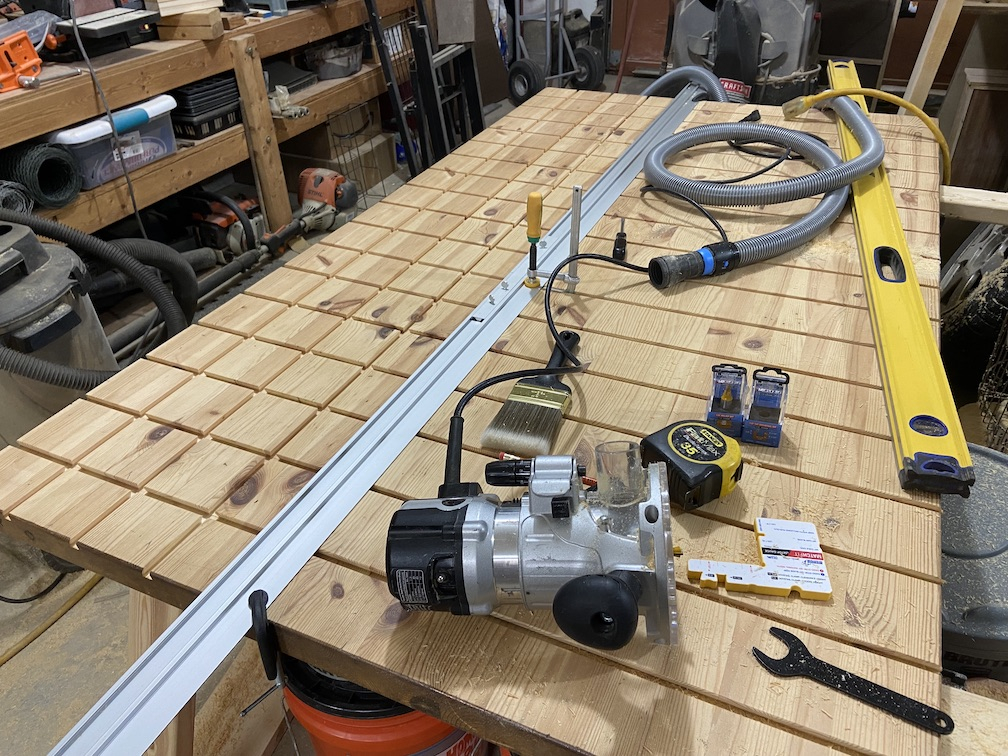

After eating half the cheesesteak, I headed back out to the garage and got to work on making more slots. Got the last three slots across the width routed out and then started using the 2 piece 100" guide to route a slot along the length.
Noticed a good bit of deflection in the middle as I was routing the initial cut with the 1/4" relief bit and thought "that isn't good ... (Relief bit gets used to remove waste material and make it easier on the dovetail bit and make it last longer)
Then a light bulb went off as I realized "Hey - I have a solution for that ...":
Worked perfectly ... (y)
Ended up getting three slots done length-wise, which I think is just shy of half done for the slots running the length.
Ended up using the new vacuum hose and one of the adapters on the router to suck up the chips. Worked pretty good and let me forego putting on the clear plastic shield (which is starting to crack) on the front of the router which has to be removed every time you want to change a bit since it blocks access to the spindle lock button.

Looking at that clamp, it’s surprising how similar it is to the clamps on my welding table.
Yup ... looks quite similar.
Instead of dovetail slots, I drilled a pattern of holes, and cut off HF bar clamps and welded them to pins to fit in the holes.
Local friend here bought a pre-drilled top from somewhere and built himself a welding table with it. Said it was very reasonable ... to the point that he thought it wasn't worth it to just get a piece of steel and do it himself.
Not sure what all type of clamps he's using with it.
He may have some of that type but I'm pretty sure he has some of the traditional "hold fasts":
My plan was to drill a 3/4" holes centered in every one of those squares that the dovetail slots create for either dogs or hold fasts.
After watching some videos on it not sure if I will still do that or not.
For one thing, it a whole lot of work.
OTOH, it would lighten up the table top some - which is both good and bad I guess.
Probably will do at least a couple rows of holes in line with the new vise.
