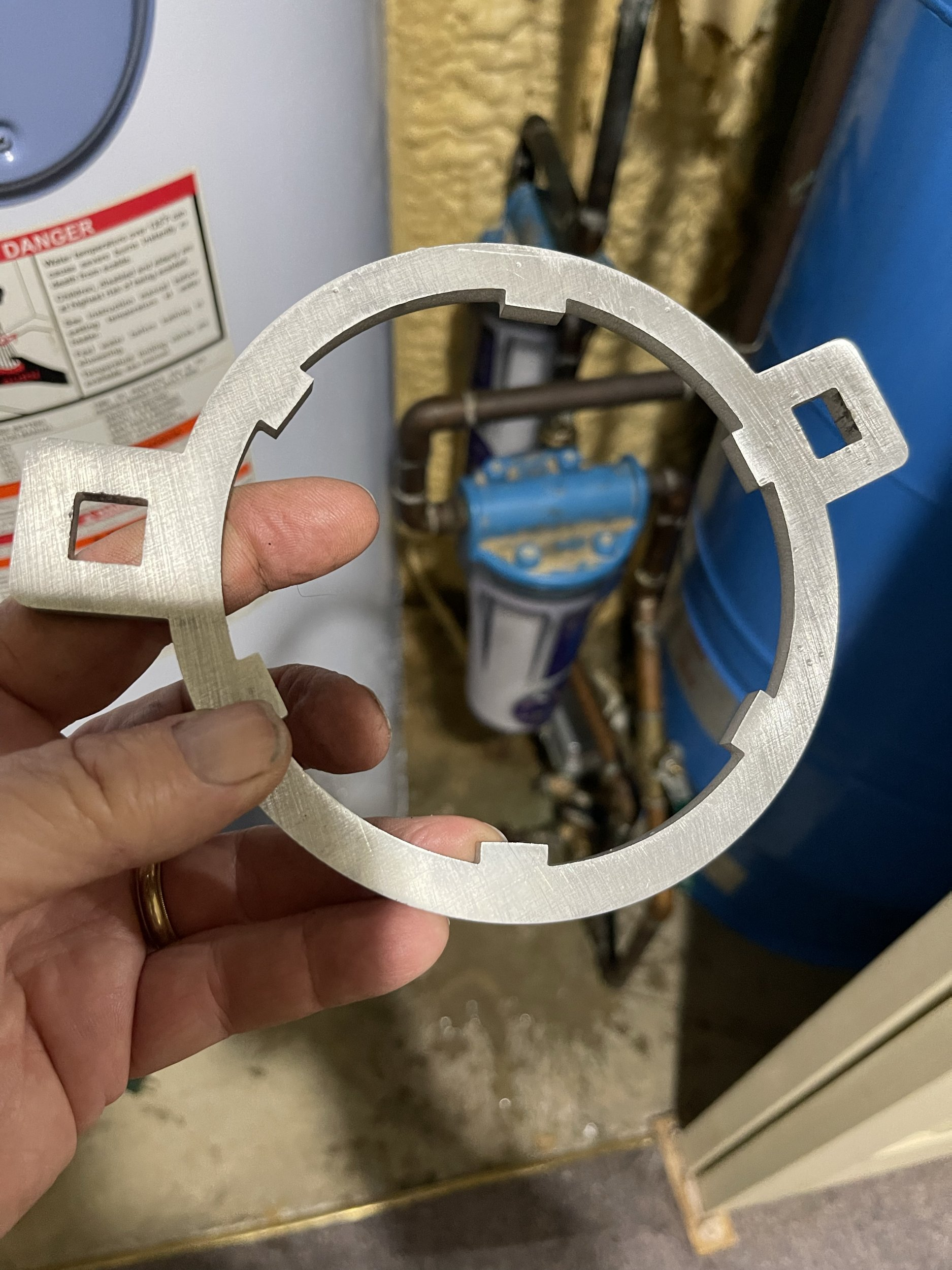

I’m sure that anyone that has used the cheesey plastic wrench that comes with water filters experienced the frustration that caused me to make this.
I use it with a 1/2” drive ratchet or breaker bar. It works extremely well, I would bet there is a market for them if I mass produced them, but I don’t have that capability.

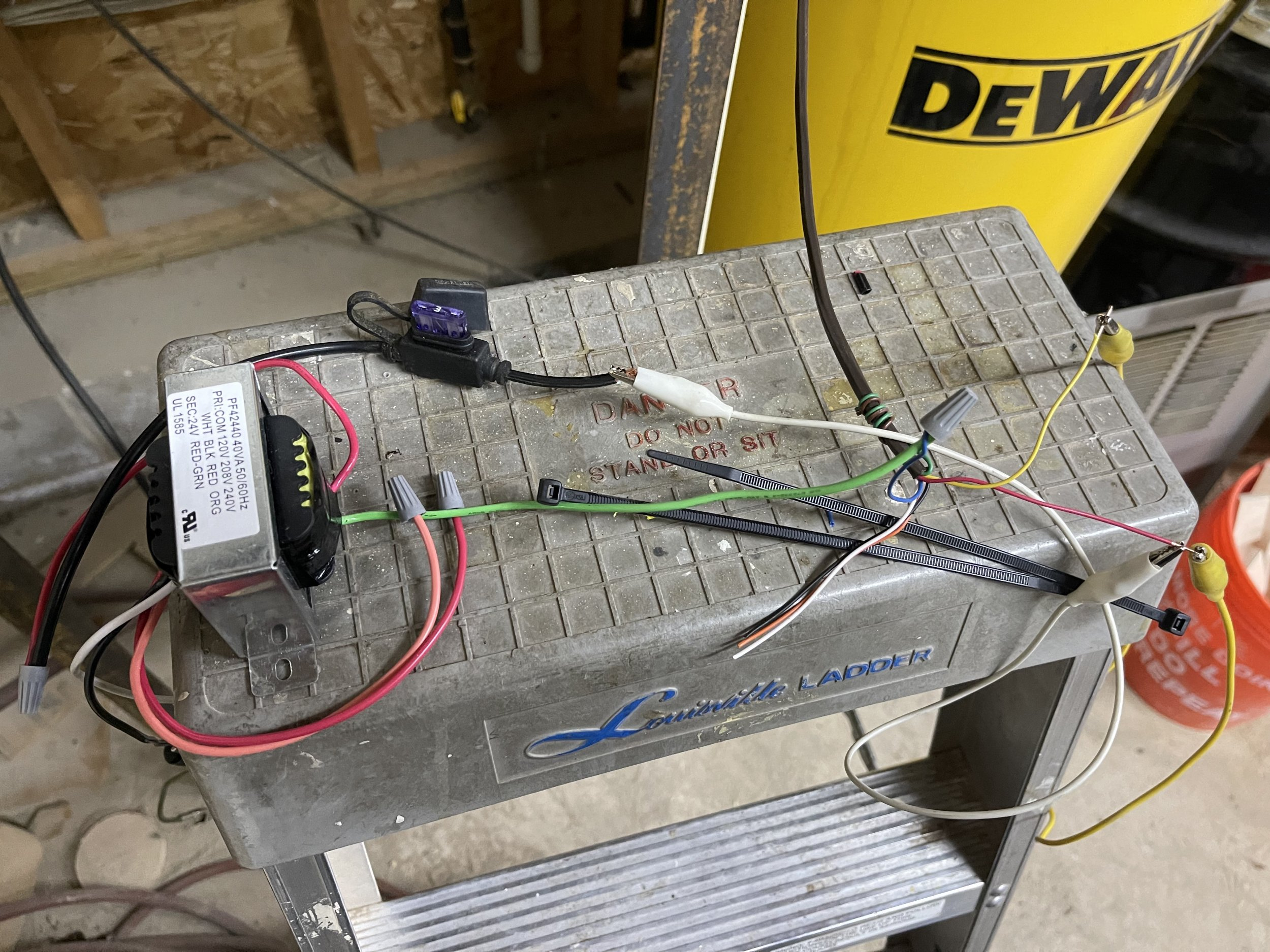

After the rain let up I went back to work on the heat pump, replaced the contactor, the low voltage wiring into the shop, and carefully dressed the wiring keeping the control wiring away from line voltage wiring. Not that it makes a difference, but the control wiring was only energized with 120v as it was just one leg of the 240 and it returned through the common ground.
After it was all back together, being a bit shell shocked, I tested it using a separate transformer with a fuse inline before connecting it to the air handler.

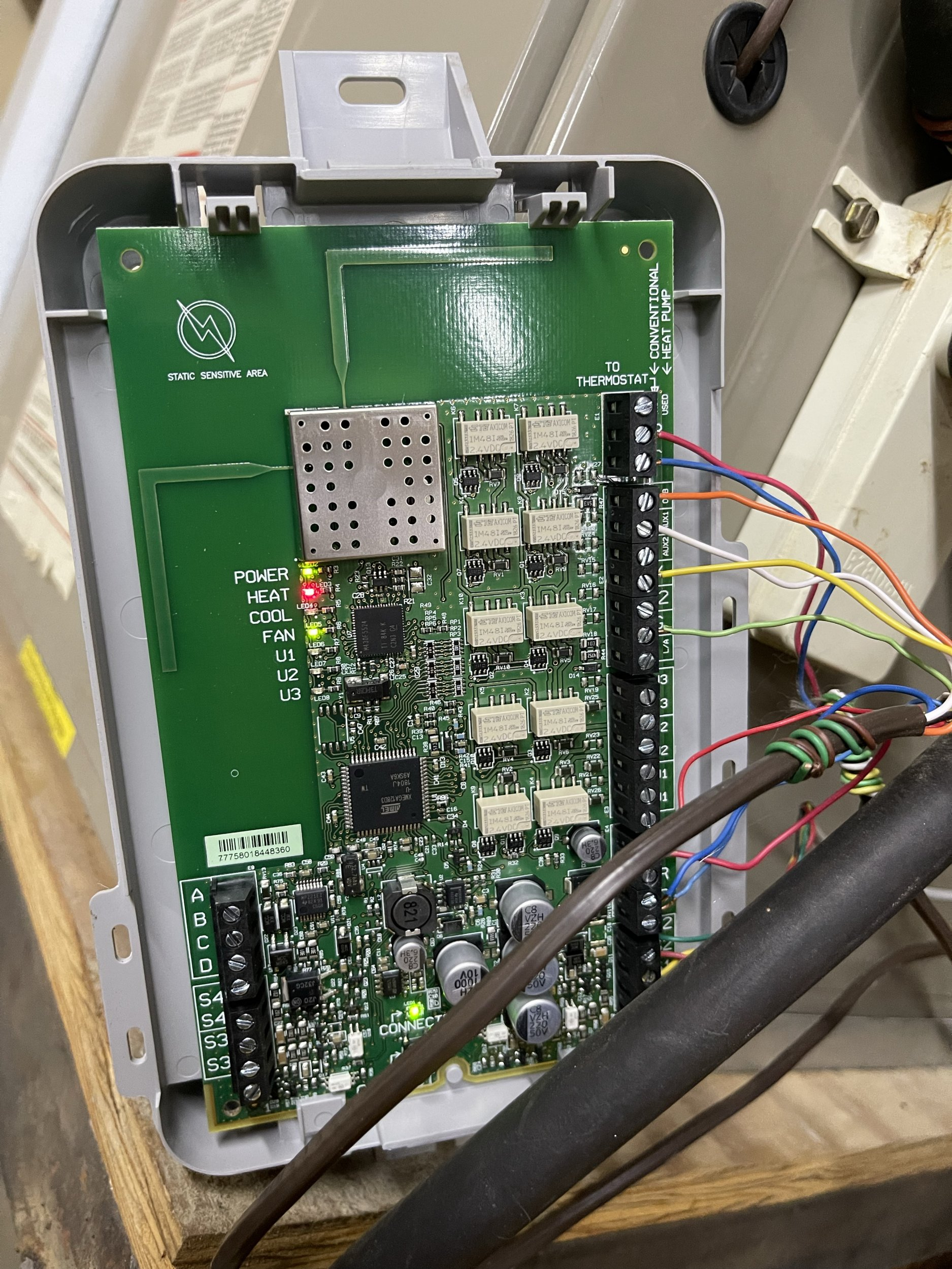

Fortunately all the smoke stayed inside where it belongs, so I connected it to the equipment interface.
And finally all is well again. Mounted the interface, buttoned everything up and moved on to the next project.

Did you determine what was the cause of the control wiring being energized?
   / Good morning!!!! #166,184
Yes. The 24vac wire to the condensing unit was against one leg of the load side of contactor, and had chafed through their mutal insulation. You would not expect enough vibration to do that. I have over the years, seen control wiring chafe on copper tubing around the compressor or coil plumbing and short the low voltage to ground, but this is the first I have ever seen a connection from high to low voltage.
