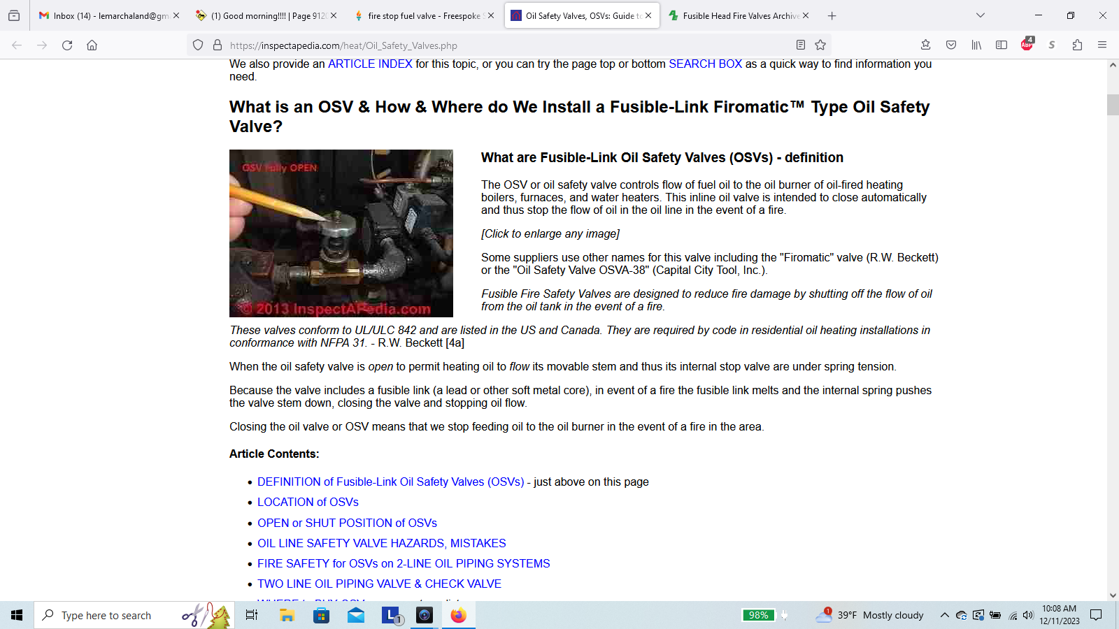

while checking on basement fuel oil tank figured I'd better get another filter.
The heater was eleven years old when I got here and had never been cleaned.
First thing I did. So I'm guessing no one has paid much attention to this filter.
looks like top of valve is missing
That is a fire safe valve, with the knob screwed down like it is it is holding the valve open. If you unscrew it, it will allow the stem to lower and close the valve. The design is supposed to close during a fire.
