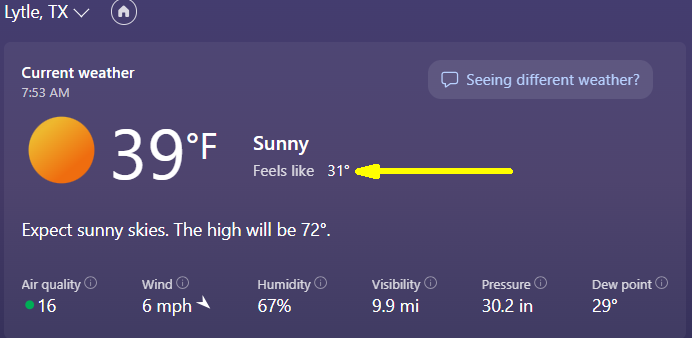

Wow! Bitter COLD here this morning. What happened? This is not the South Texas I know and love.
