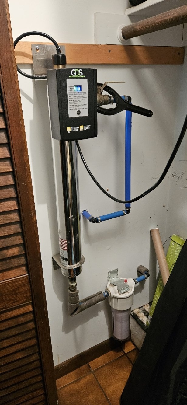

So went and changed the sediment filter on the water line.

Filter looks nice and clean again.
