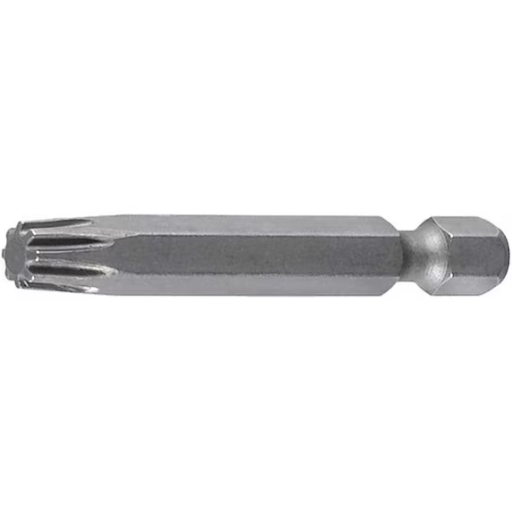

are all torx or star drives the same?
do they have different numbers of teeth and is their some standard?
I think six teeth is standard but?
you need a combo of both grip and strength
don't think they quote steel quality or hardness on the box
predrilling carefully here will reduce the problems
learned a new word, hexalobular socket
aka Torx being the brand name
I've had good luck with the GRK Brand.
   / Good morning!!!! #214,218
No. All Torx drivers are the same geometry, but there are many other "star" drive types.
"Torx" is a standard, with 6 teeth. But there are many other standards, some pretty common, which look a lot like torx but aren't.
Yes, six teeth is standard for Torx, as well as a few of the other common variants. But I also have several with 5 teeth, and others (e.g. Timberlok) with higher tooth counts. Here's a TimberLok driver bit with 8 teeth, which is very common in framing:
That one's new to me, as well! But it makes perfect sense, I like it!
