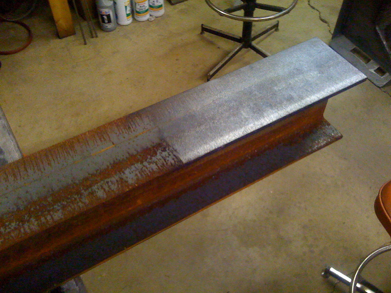

On a somewhat happier note, U.B. were able to score a piece of 8 x 6 1/2 W28 H-beam for cheap yesterday ... and Logsplitter 2.0 is on it's way:
That piece of H-Beam is nearly 8' long ... so it will need trimmed down a little. The box tube that serves as the axle/cross beam/hydraulic reservoir will be flipped 180 degrees so the supply and return fittings are located on the rear.
   / Good morning!!!! #28,639
After a little bit of flame cleaning with the O/A torch - to remove the rust and mill scale:
