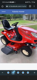

I actually went and looked at a G2160 last night, thought I was going to buy it... the power steering wasn't working, I chose to walk away from it, seemed too risky, I am not educated enough in the electric power steering system and parts prices. I left there, checked marketplace, and found this clean GR for a great price so decided to take my chances on the hydro.
As far as waxing, I am not sure, but it must have been because it looks great.

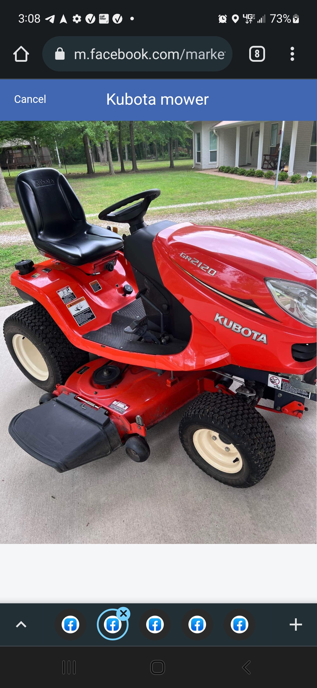

This is the pic that was posted to Facebook ad, taken two days ago:

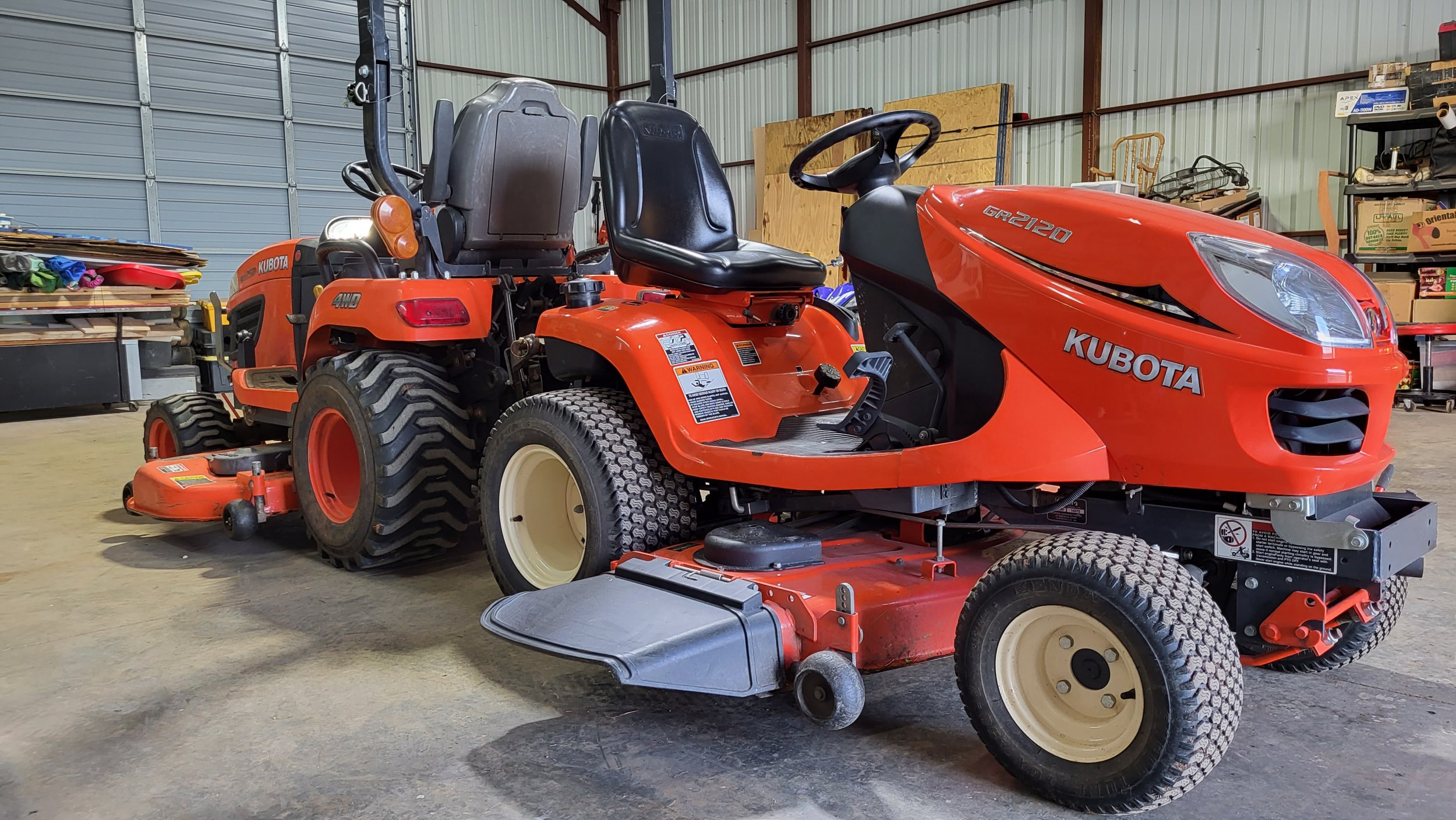

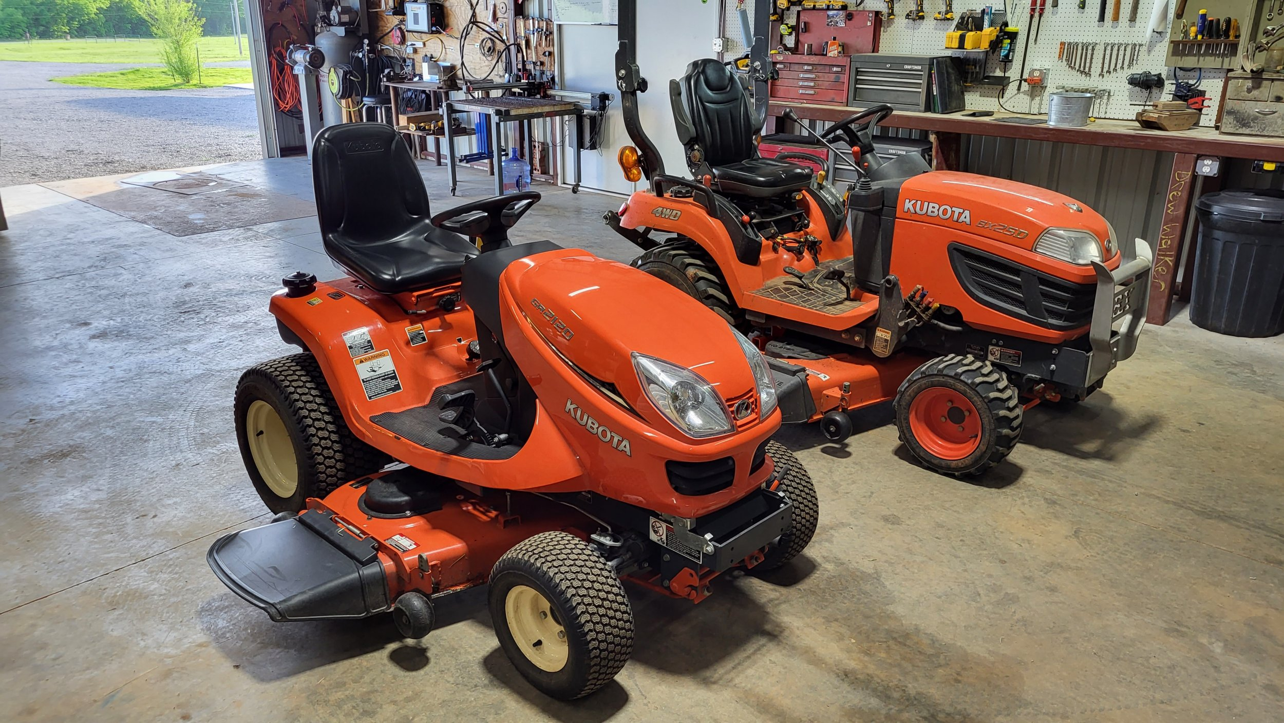

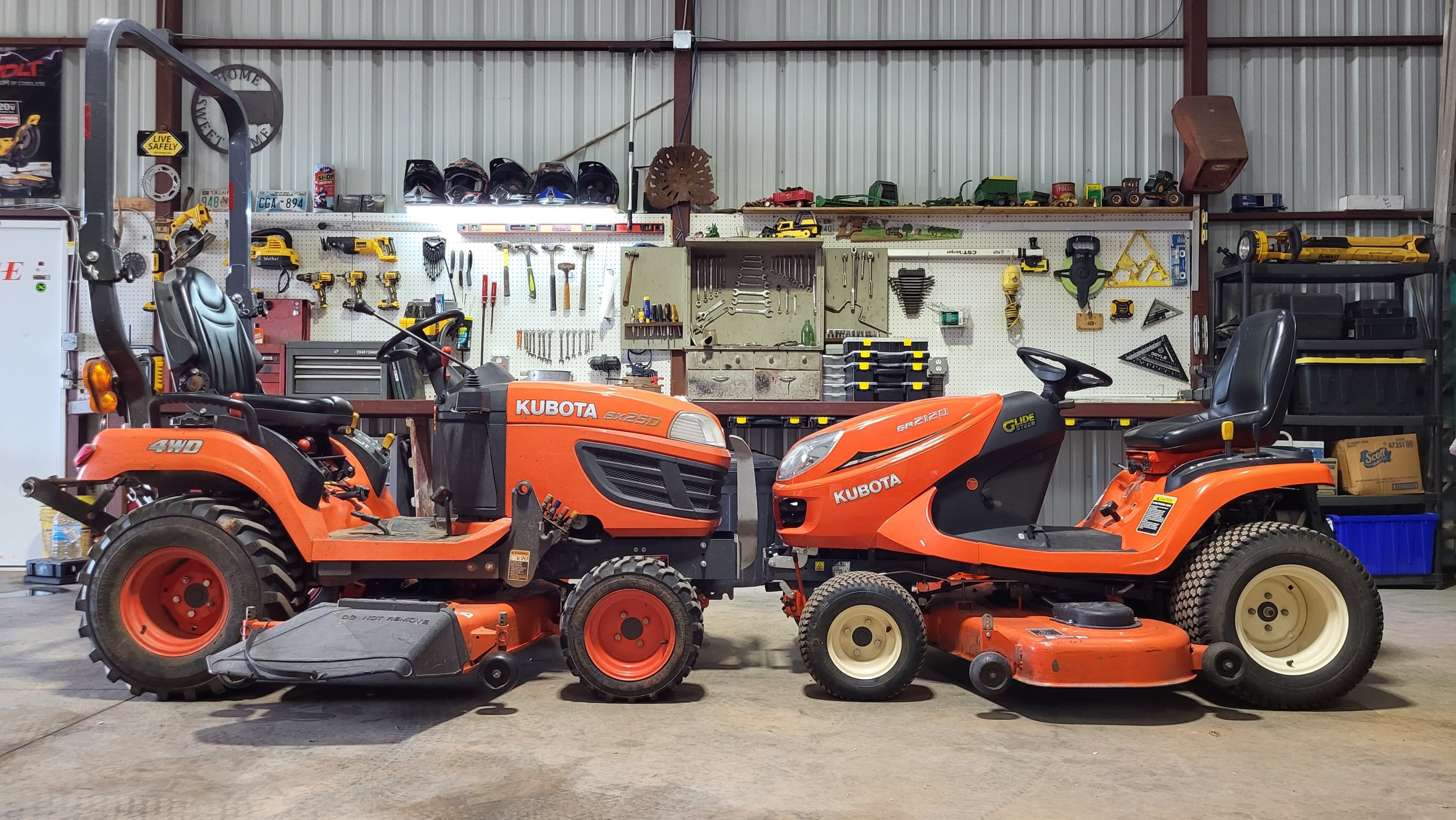

Quick turning measurements (54" deck on concrete)
GR2120 uncut circle: 37", turning radius: 19 1/4"
I mowed with it for about 20 minutes.
My initial thoughts comparing it to a BX: Much smaller operator area, harder to get on and off, as expected, but just mentioning for anyone who is wondering. I am 6'3". The deck lift control could be in a nicer location, it is too far back (and on the wrong side lol), it feels slower in both forwards and reverse, the steering effort feels.the same (very easy, one finger control), engine is very very smooth at normal operating speeds. Cut quality seems the same as the BX so far but the grass isn't tall enough to really tell for sure on that overall, I went up and down some small hills and it done fine, there's no way a 2wd tractor would have done it, you can "feel" the glide steer kick in when turning, it is very subtle but I only noticed when paying attention, it definitely works great.
I took a few pics with the BX:

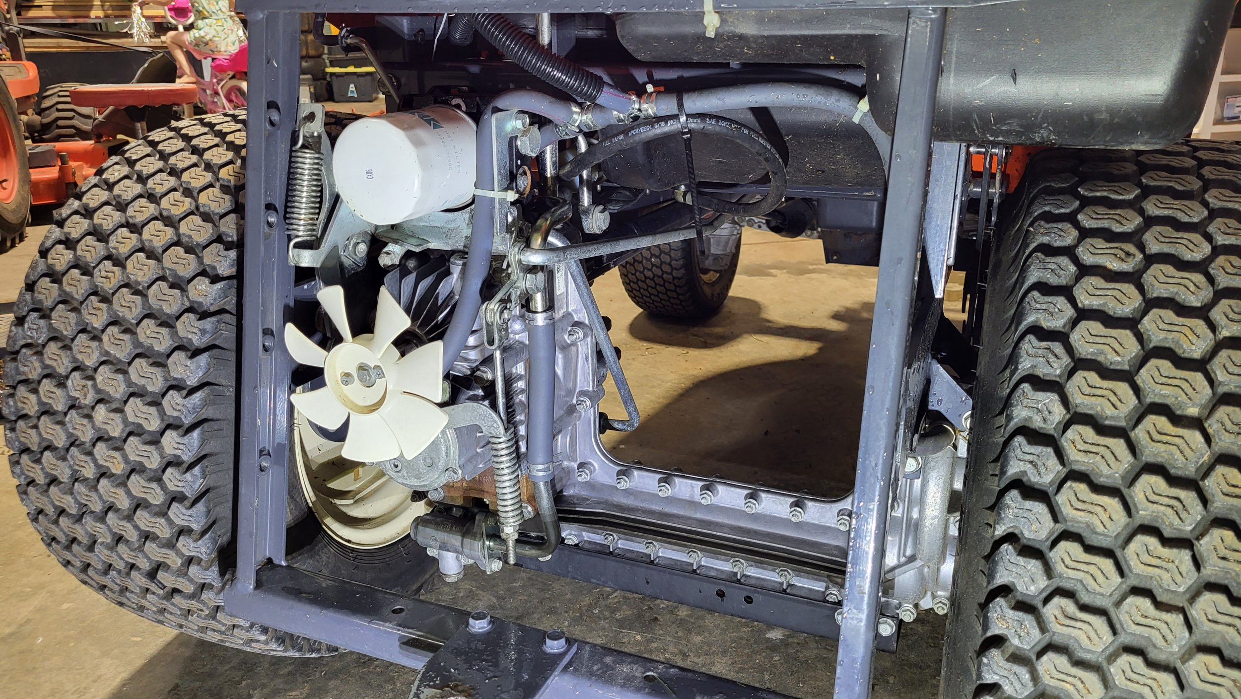

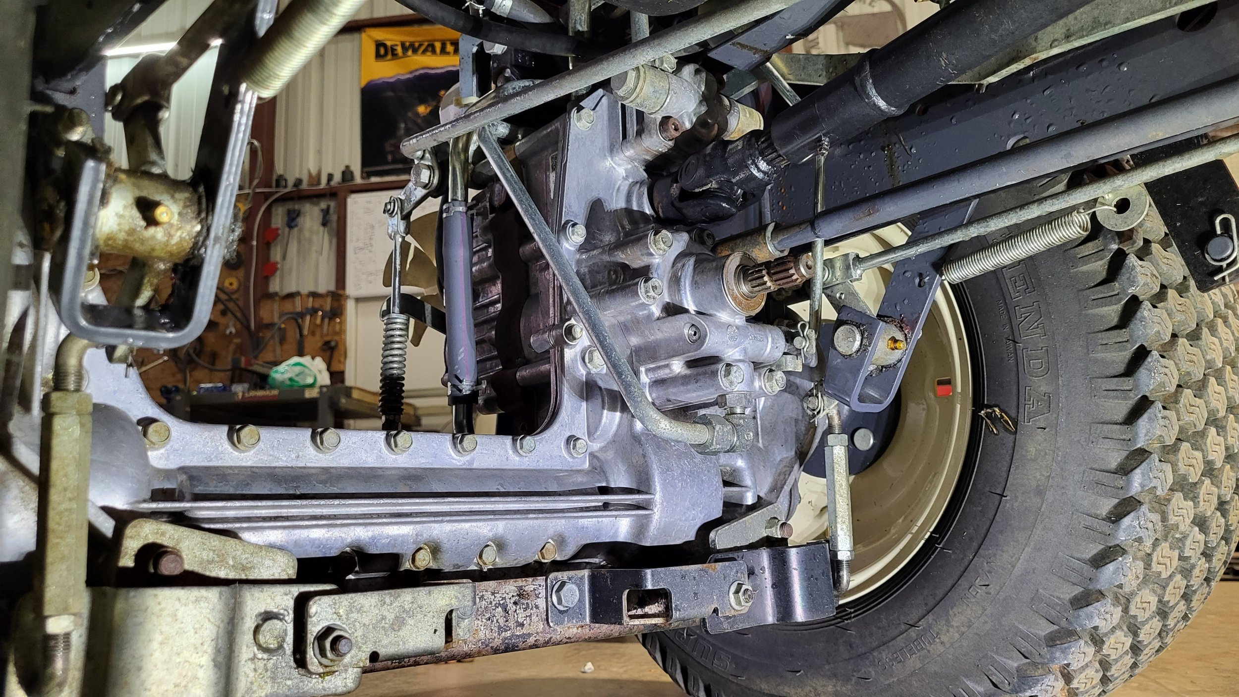

The 54" mower gearbox was covered in residue, I cleaned it all off, checked the fluid level, fluid was running out and I capped it back off.... used it for about 30 minutes and noticed the gear case was wet with oil. I then removed the plug and let it run out, there was about 12 oz too much, so that should explain the excessive venting. I went ahead and drained it and refilled it so I know it's good.
The transmission was covered in oil that appears to have not been cleaned off in a long long time. I cleaned it so I can see where the leak is... it is definitely venting fluid out of the breather but I believe there may be another leak as well. Will update when I solve that mystery.
Before and after pics attached.
