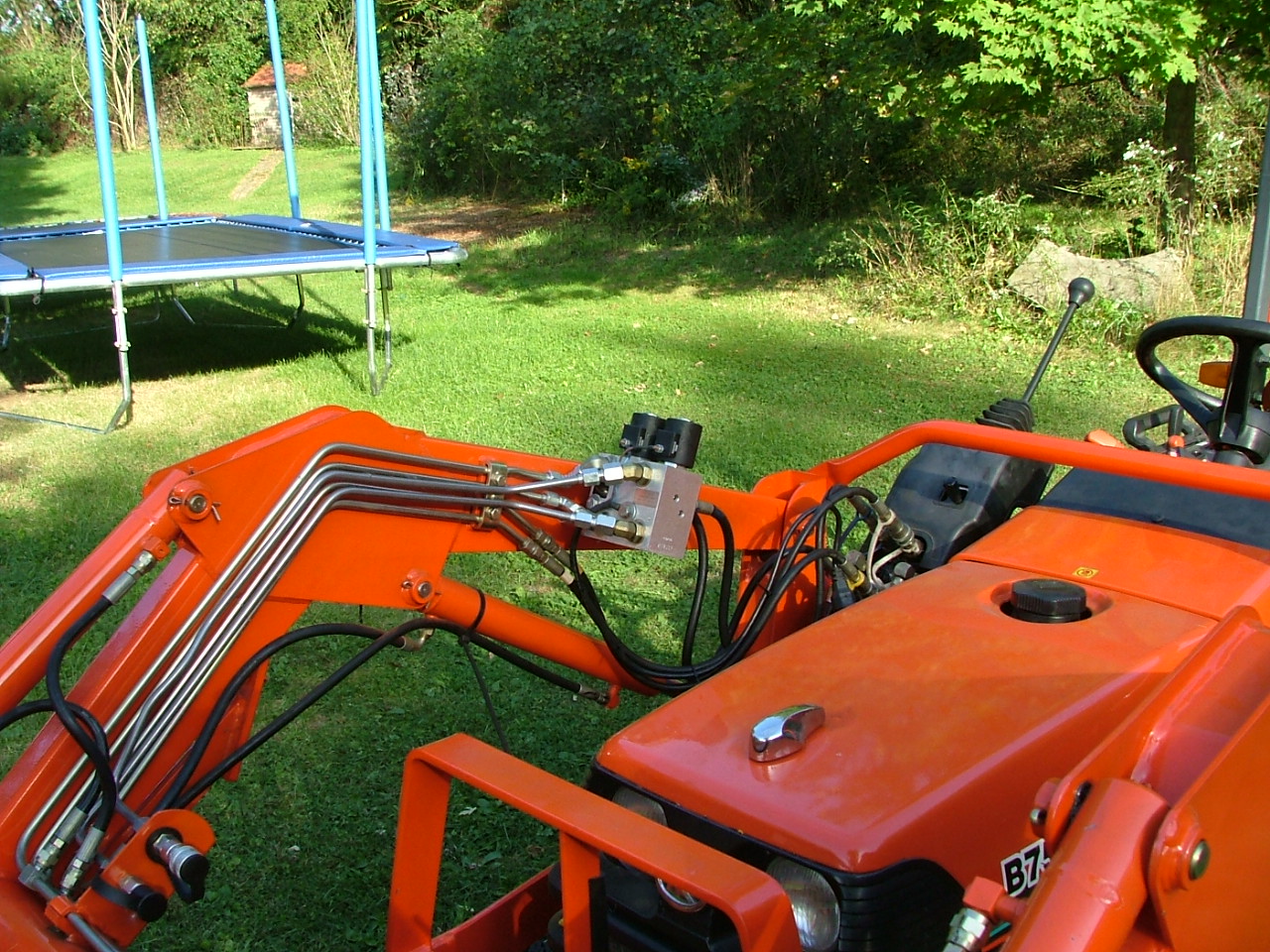

   / Grapple question, how are your Hyd Quick Connects mounted on the FEL. #3
Try this. If you put a bulkhead bracket on each side of the torque tube,
your hoses will be just a bit shorter. You might want to use a hose
"prophylactic".

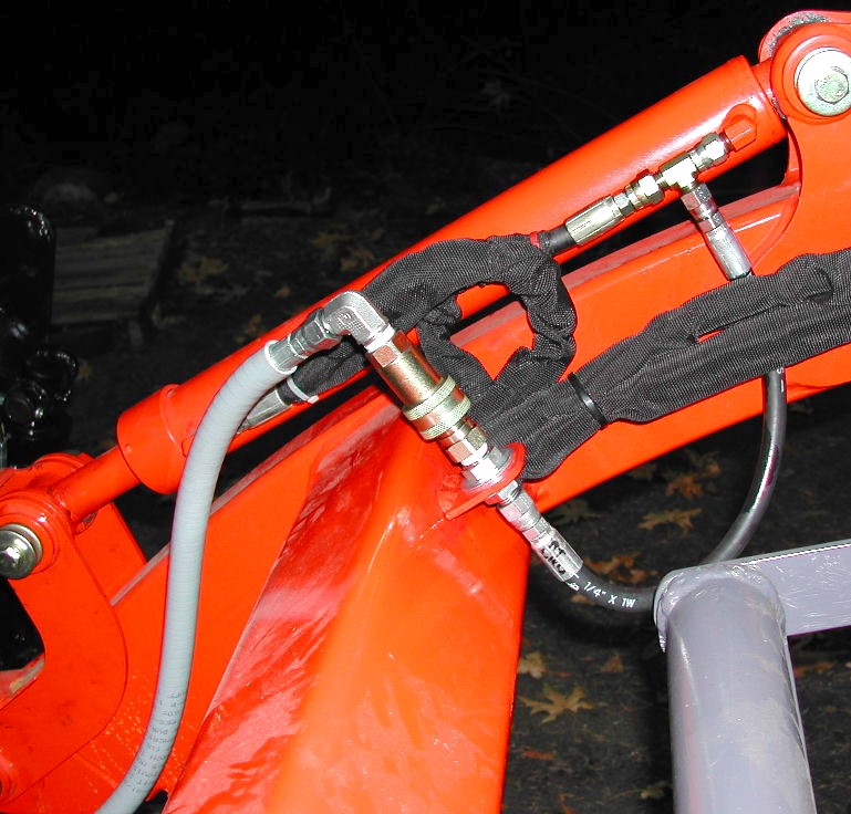

   / Grapple question, how are your Hyd Quick Connects mounted on the FEL. #4

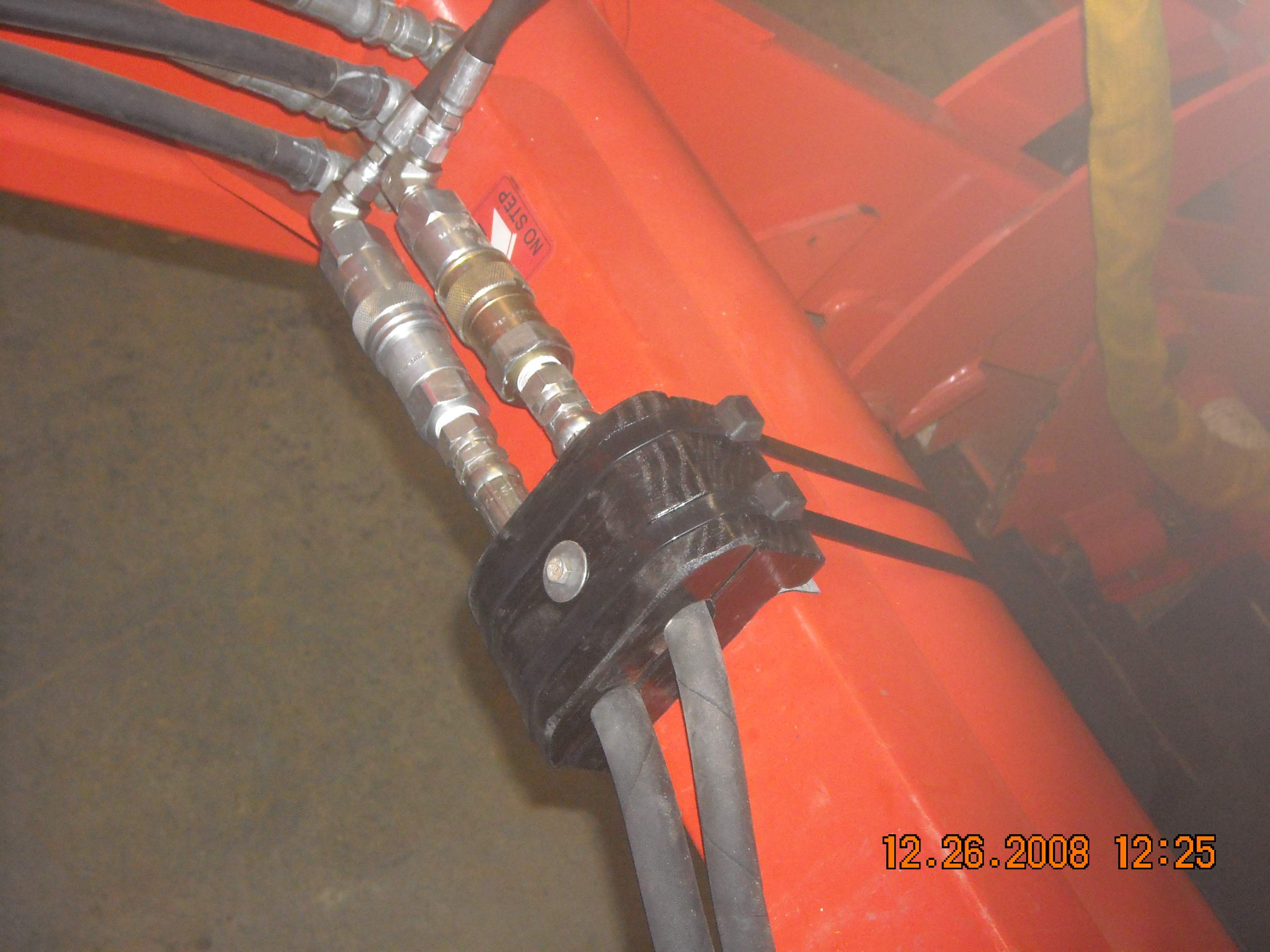

   / Grapple question, how are your Hyd Quick Connects mounted on the FEL. #10
I used the Bobcat style quick connectors. The brand was Parker. They are a little heavier duty and don't seem to drip as much when hooking them up. Before welding any brackets on my loader I made a bracket out of oak and held it on with 2 giant cable zip ties. I wanted to try out the mounting location etc...and mount the hoses quickly so I could go out and play with the grapple. :)
